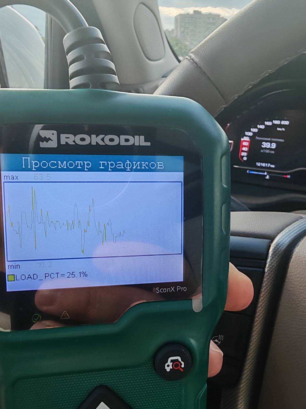

By the way, where did you get the information about the constant load on the engine in the city of 70-80%? Here is the load schedule, I am now driving around the city in the mode of 10-20-30 miles per hour. 70% is the peak when I accelerated a little, and so the average load is 25-30%
When you release the gas pedal, the engine stops supplying fuel to the cylinders at all, haha, you confuse DFM work with forced idling, or this is known as coasting. This was done on carburetor engines)))
