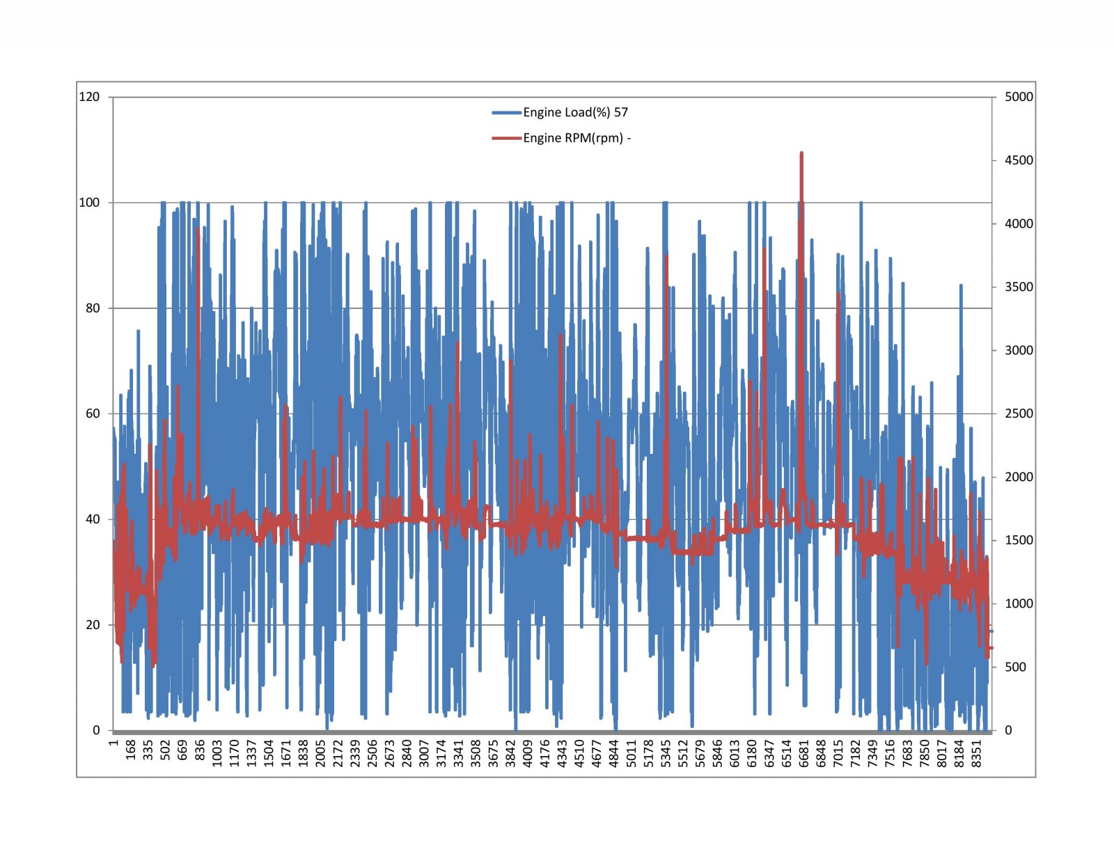

By the way, where did you get the information about the constant load on the engine in the city of 70-80%? Here is the load schedule, I am now driving around the city in the mode of 10-20-30 miles per hour. 70% is the peak when I accelerated a little, and so the average load is 25-30%
When you release the gas pedal, the engine stops supplying fuel to the cylinders at all, haha, you confuse DFM work with forced idling, or this is known as coasting. This was done on carburetor engines)))

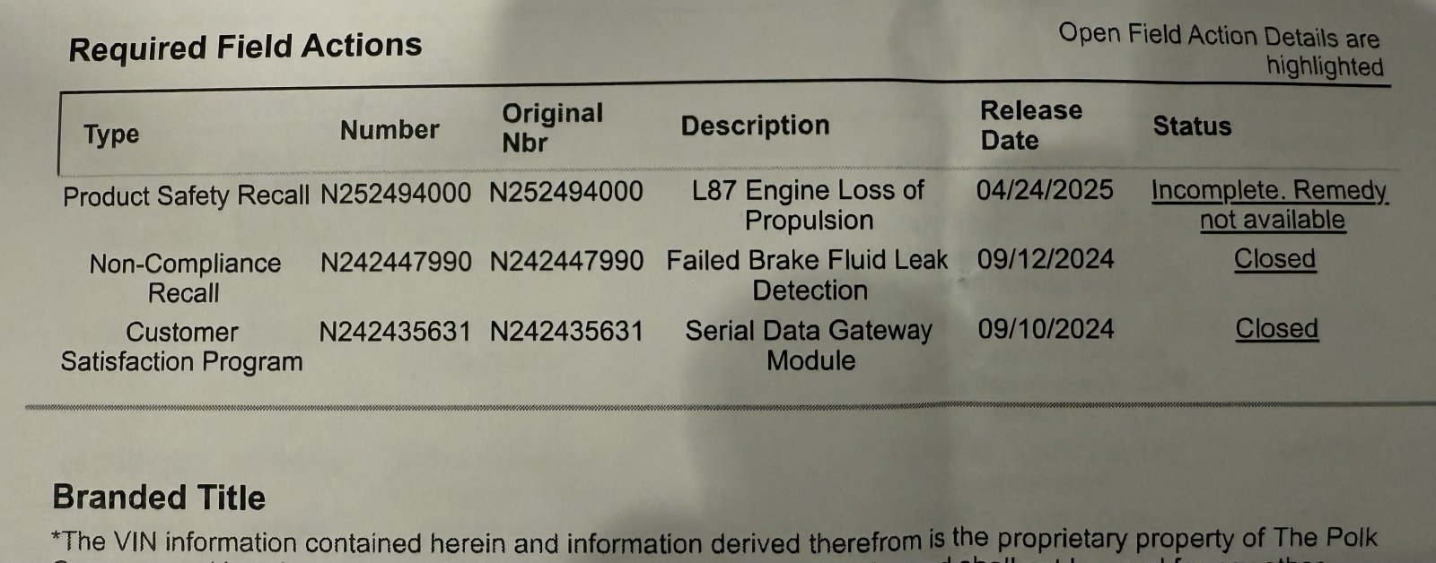

Trying to keep up here. I’m on my 2nd 2023 yukon Denali 6.2L. First one blew the motor at 3600 miles. Did full vehicle replacement. 2nd one has 32k on it and at the (Chevy) dealer right now for oil change. They pulled my codes and I have the loss of propulsion L87 one (see pic) but not the P0016 ppl were referencing. Took a stab at requesting 0w-40 but they wanted to charge close to double so I didn’t throw a fuss. Praying at this point my vehicle doesn’t get marked as condemned and unable to leave the dealer after they swap my oil. Godspeed my fellow 6.2 liters
Your vehicle has clearly been recalled and should have the 0W40 oil. The Service Advisor probably does not know this. The dealer will not likely hold your vehicle unless they see a Pending P0016 code. I have seen few cases of a P0016 code before an engine failure.
The remedy not available means they most likely do not have the 0W40 oil fill cap, but they may.

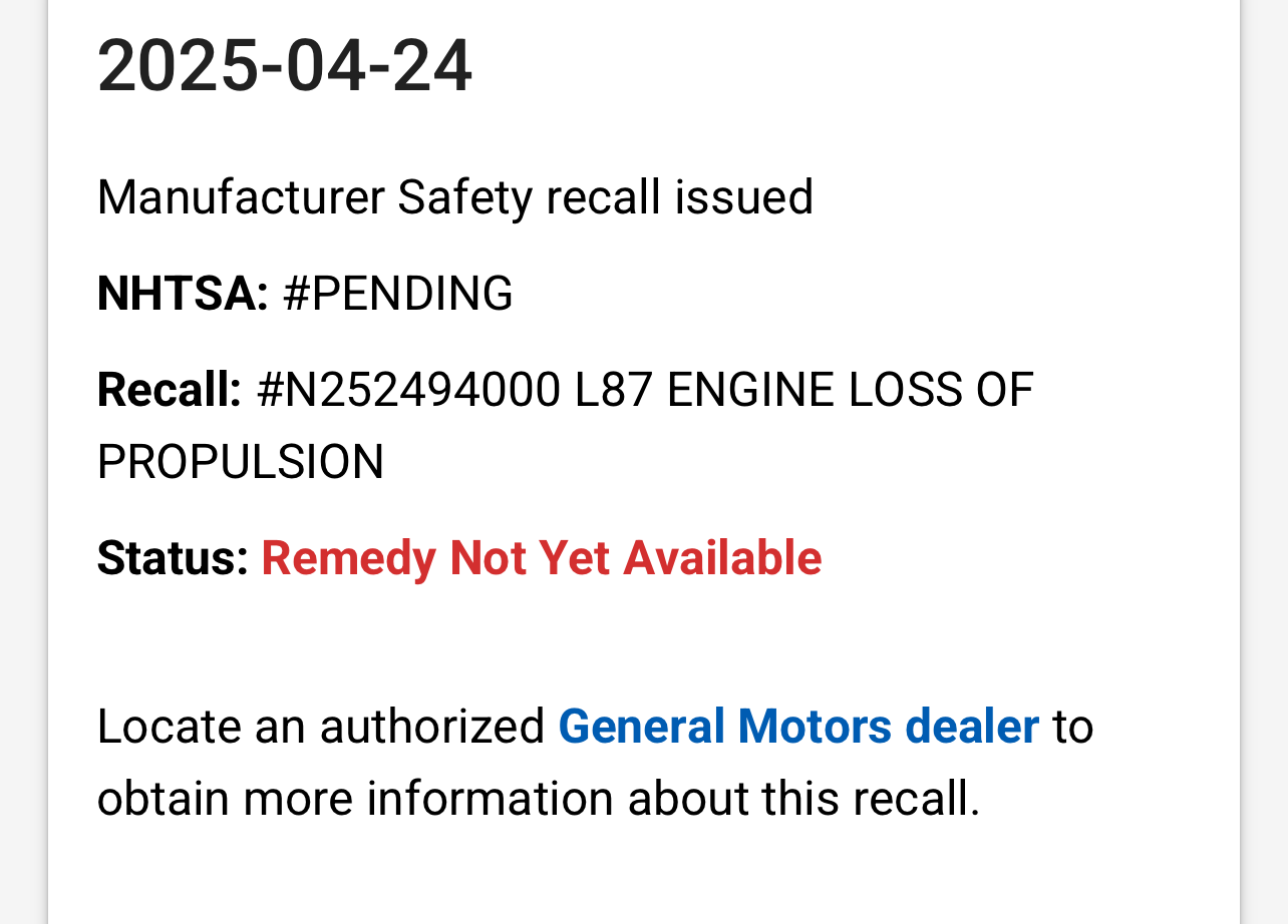

General Motors has decided that a defect which relates to motor vehicle safety may exist in certain 2021 – 2024 model year Cadillac Escalade and Escalade ESV, Chevrolet Silverado 1500, Suburban, and Tahoe, and GMC Sierra 1500, Yukon, and Yukon XL vehicles equipped with the 6.2L V8 gas engine (RPO L87). The connecting rod and/or crankshaft engine components in these vehicles may have manufacturing defects that can lead to engine damage and engine failure.
Safety Risk Description
If the engine fails during vehicle operation, the vehicle will lose propulsion, increasing the risk of a crash.
Also, just got this notice for my Yukon from Carfax Car Care.
One interesting thing I noticed is that GM is now recommending 0W-40 instead of 20. We were right.

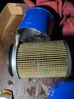

When I called a local dealer about the recall, the service guy made a comment about there being dirt/contamination in the production process of the metal of these engine parts [that is causing the failures]. Now, I don't know if that's his interpretation of the terms used in the bulletin(s), or whether he got that info on good authority. Well prior to the recall coming out, though, when he had 3 trucks at the dealership waiting for new engines, he said that the failures were due to [a run of] poorly manufactured parts. To me, that checks out/is the culprit here.
My guess is tooling to build motors... not what it what it was in my 2018 SLT... That is my 2024 Nov Built yukon 5.3 first change at 600 miles. it was full of material.. other than oil. i did three changes to get it decent..
My estimate is something has happened to tooling.. or something effecting cleaning of blocks, pistons, lifters.. heads.. the filter should get everything over 30 microns.. but.. that still leaves a lot to get through. its pitiful.
