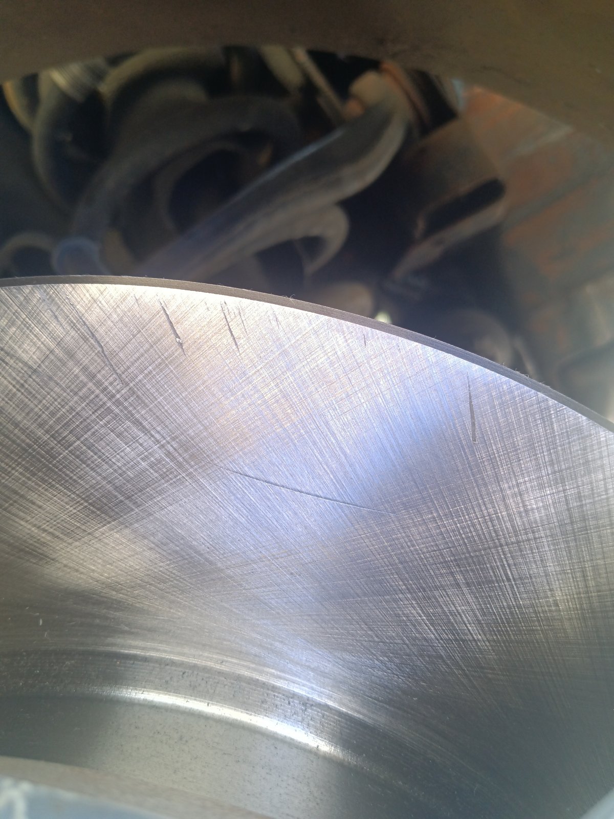

Just unboxed some raybestos front rotors and one of them has these grooves in them.
I already installed it and now wondering if this is gonna be a problem.

Looks like some sort of factory defect, if you bought them local I would maybe try and exchange them but otherwise shouldn't really be a problem.
from that angle the rotor looks very thin to me

That is a non-directional finish from the factory. Similar to honing on cylinder walls. It's a way to make the surface true and also allow for the pads to bed in and mate properly. Just install the brakes with proper lube on the backing pads, lube the pins, and make the anti-rattle clips are new or cle and off. All set to run

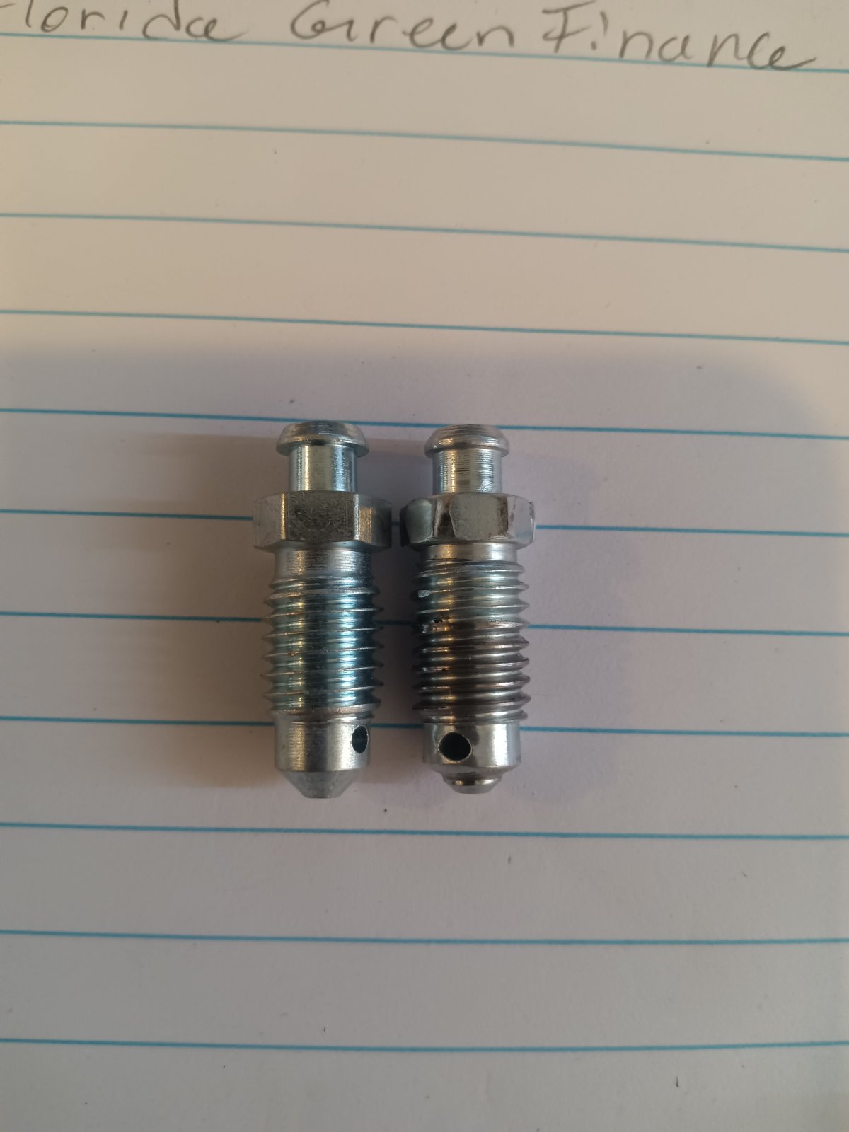

The Bleeder valve will not stop weeping no matter how tight I make it??
It is an incredibly minor seep around the threads, I have to stick the corner of a paper towel into the threads to see any wetness.
I am reading that using thread locker or Teflon is not a good idea; however, I also see brand new bleeder vales that come with thread locker on them - so what's the deal??

You could use a little grease on the threads. I wouldn't use threadlocker unless you plan to change calipers next time; the bleeders can get pretty stuck all by themselves over time.
I'm wondering why the sell new bleeder valves with red thread locker on them? I'm thinking about trying them out, but again most sources say not to use it. Teflon degrades in brake fluid and can clog lines, I assume if anything the thread locker would dissolve and not likely clog anything? What do you think?

you're probably seeing the quick bleeder style bleeder. as said, it's just sealant because how those work is you loosen them, they have a one way check ball in them so you can pump the brakes, the sealer is there so doesn't suck air thru the threads. when tight they sell at the bottom.
you have a issue with the cone at the bottom of the bleeder or the caliper. pull the bleeder out, blow out the hole and look for any crude in there. check the bleeder that the base is a smooth cone shape. and then put it back together. or return the caliper as bad.

i think they sell those at the autoparts store I would just go grab another one and see what happens could be thread out of spec, some tiny piece in a groove or anything like that

Ahh sealant, no locker...my bad.
I'm steaming over here. As I said before, nothing comes correct anymore This is the bleeder I took out of the passenger side caliper (havet installed yet), metal in the hole and threads split, burr on bottom surface next to "cone" ( it's not even a cone. Guy at AutoZone says, u can return the caliper ..mfr, I'm not taking this off again. Look at the difference between what cam in the caliper (on right) and a Dorman universal replacement.

put in the Doprman replacement bleeder valve and still having a seep. I have to stick the corner of a paper towel into the space between threads on the bottom of the bleeder and keeps coming back wet.
WTF - I'm so annoyed. if I pull this caliper and get a replacement., whats to say the replacement won't do the same thing?

this is what I was talking about, it might need to be reamed, might have to bite the bullet and just exchange it and be done with it.
