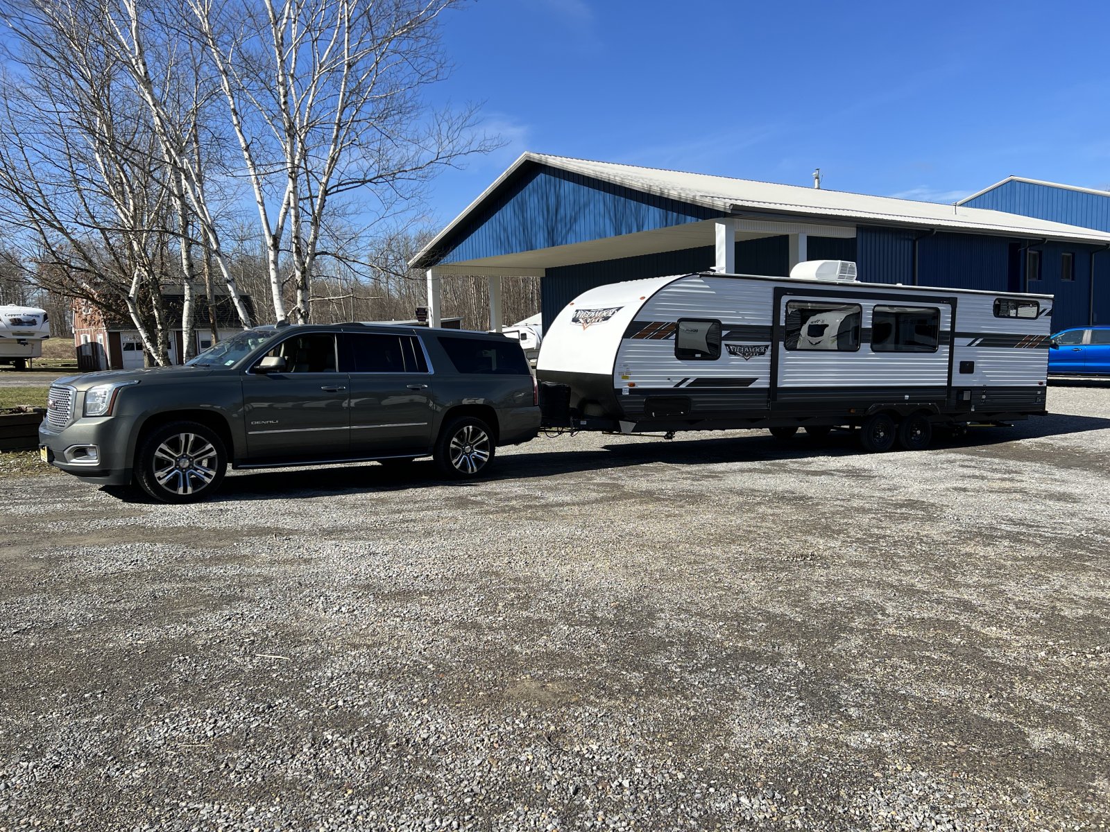

I’m a new member and spent the better part of the last 24 hours reading many posts on this forum. I have a 2017 Yukon Xl Denali 6.2 with 51k miles and located in New Jersey. I had a 21ft travel trailer and just upgraded to a 33ft 6,200lb. From what I’ve gathered on the site I should definitely be flipping the pill before my maiden trip. But at 50k my brakes are due for a change and I intend on traveling west into the mountains in the coming years and am considering upgrading the brake system.
It appears many have recommended the brembos, wilwoods, and the prostops. Cost is a consideration for me, but not to jeopardize braking with my family in the truck.
Brembo or Wilwood don’t make rear sets? I am considering going brembo in the front and then a pro stop caliper in the back to match the red, but with solid rotors and alternative pads due to some reviews on here about the prostop pads.
Does anyone have any other suggestions or recommendations?

Great looking setup!
I tow a 7000 lb (loaded up for camping) camper with a 2012 XL Denali. Last year we made a trip out west to Yellowstone and the Tetons from Virginia, and we also pull over the Blue Ridge mountains often. I've never had any problems getting slowed down or stopped with the factory brakes on mine in any conditions, including panic stops. Still have the original pads on both axles at 130K. The key, I believe, is getting the trailer brake controller set up right.
