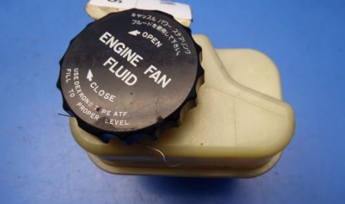

you should check your Engine Fan fluid as well
