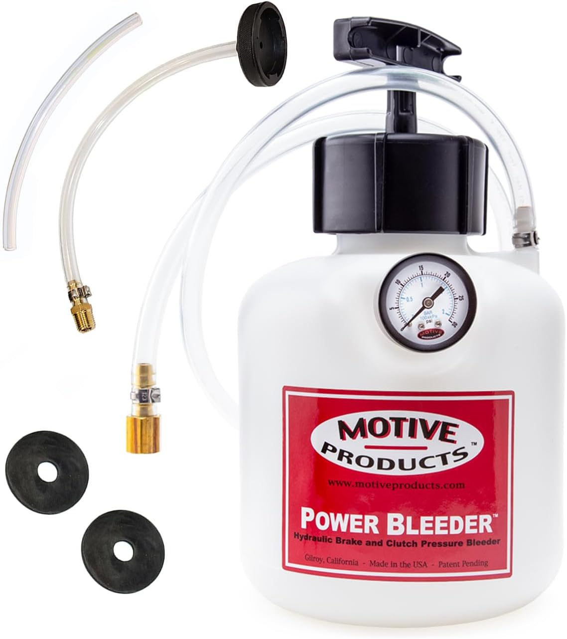

That is the one nice thing about the Motive power bleeder.... It prevents letting the brake fluid get too low in the master cylinder.

Everyone needs this: https://www.amazon.com/Motive-Products-System-Bleeder-Trucks/dp/B000TK9FE8/130-9146754-1576554?th=1
One-man jobs are a breeze, and you don't need to fill this with the fluid, just top off the vehicle's reservoir, and add fluid for each caliper. Plus, you can buy adapters for every make/model out there. I pump mine up to 15psi, and crack the bleeder until the fluid runs clear for a little bit. Brake flushes take 10 minutes (after you spend 20 mins jacking up your rig, and taking off all the wheels).
I wish I would've know about this one before I bought the vacuum bleeder from Harbour Frieght
