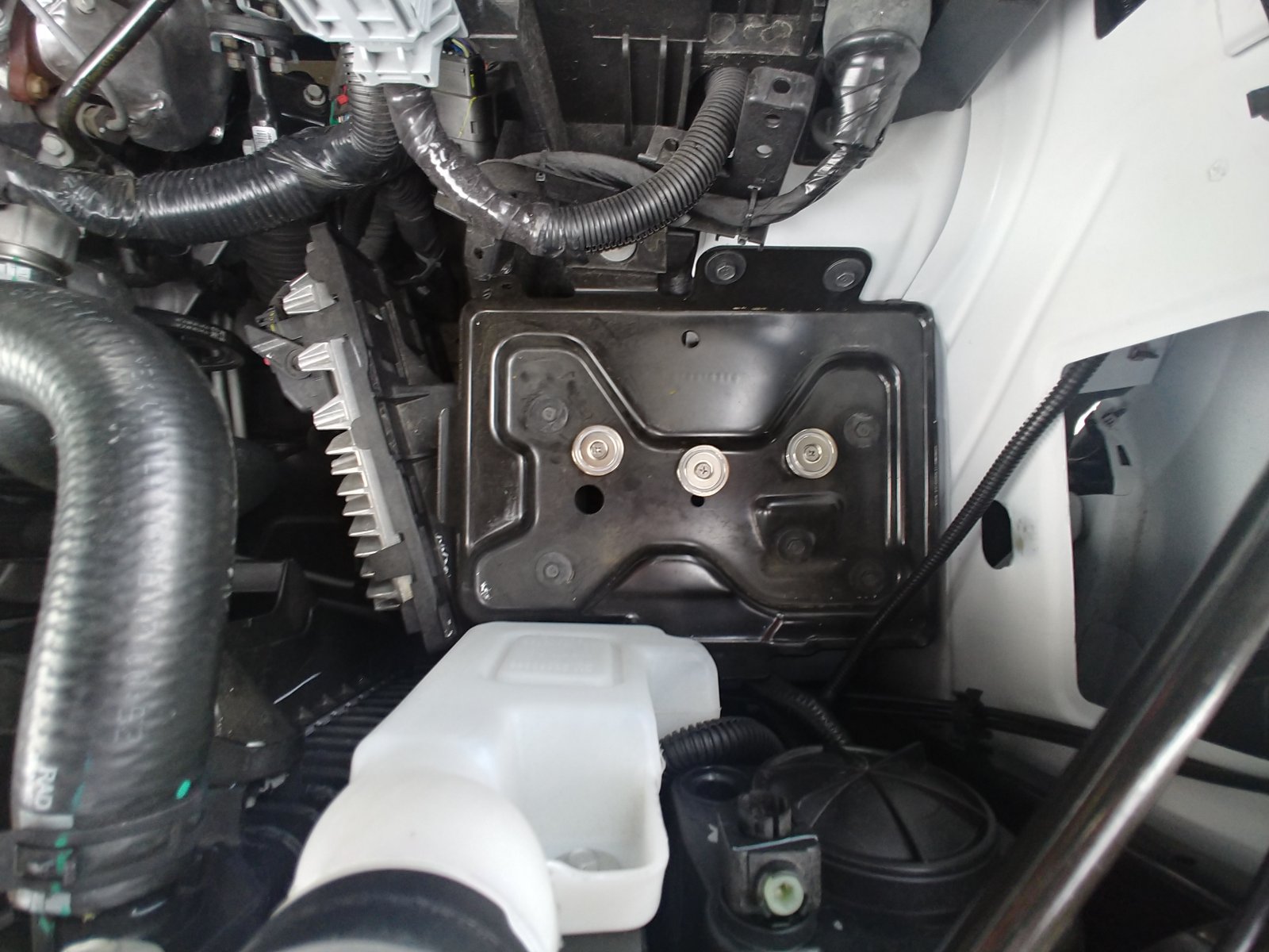

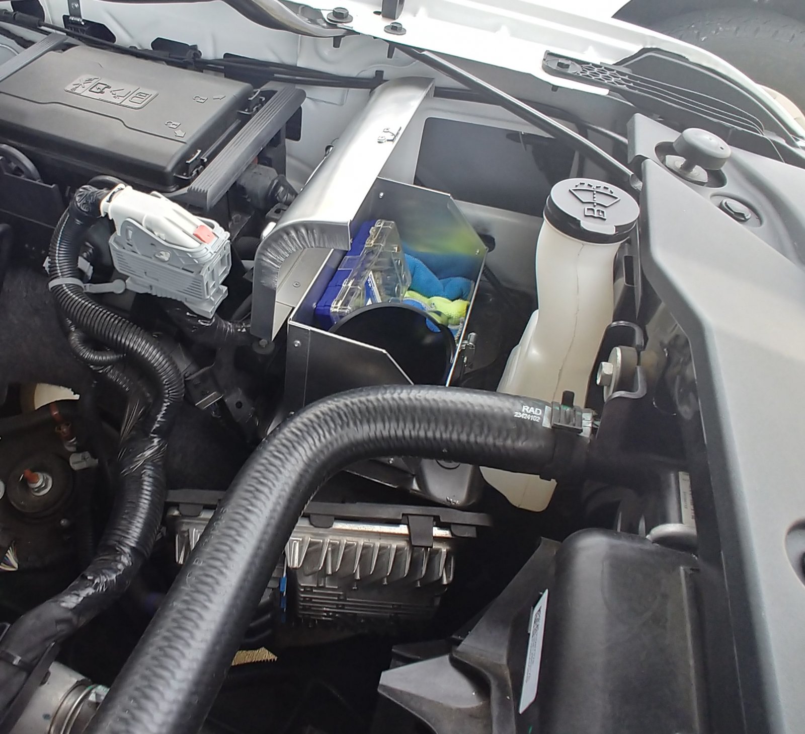

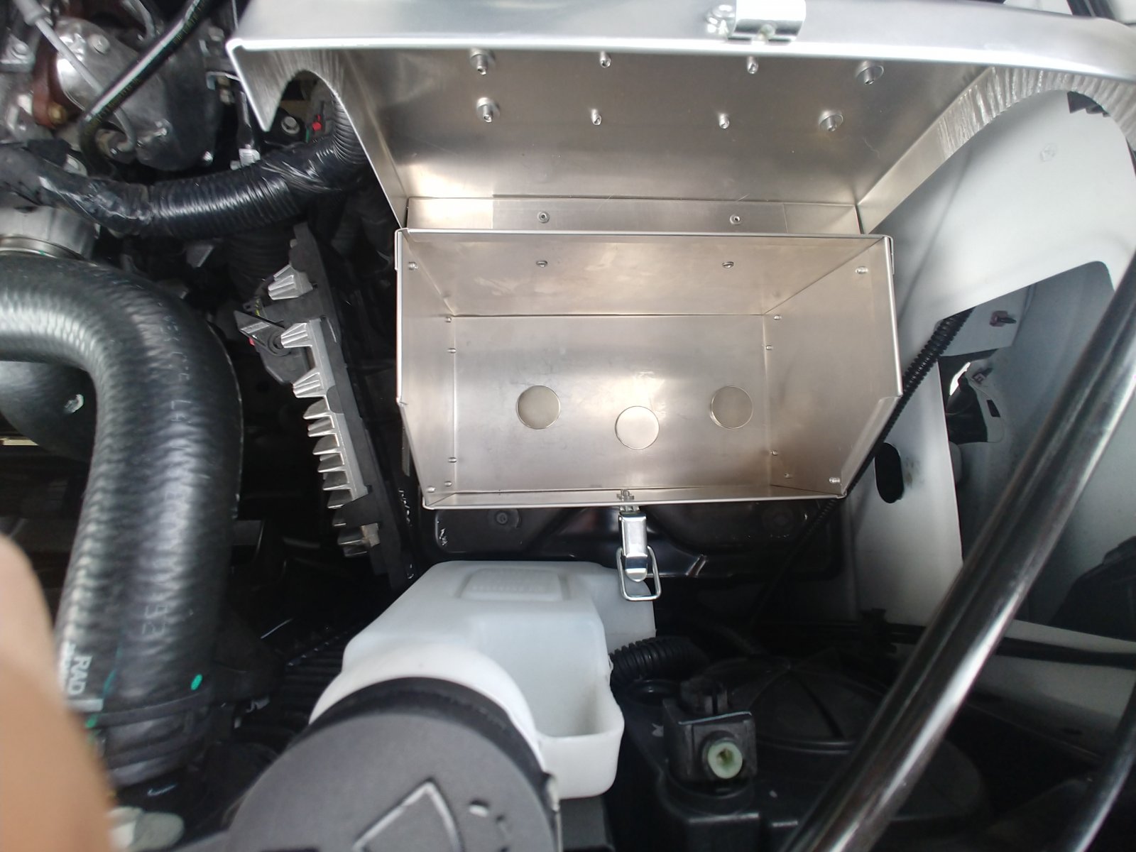

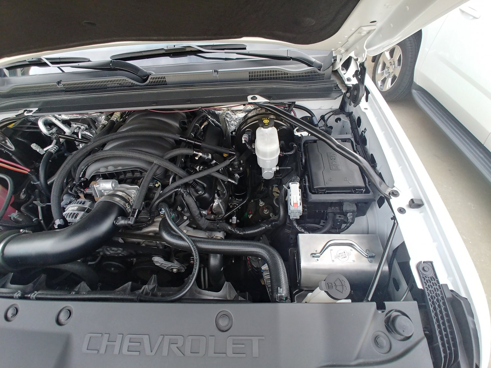

Alright guys and gals. I've been searching for a small box to mount in the secondary battery tray location. I wanted something that provided both form and function. Tried a few ammo boxes and a few different tool boxes but nothing to my liking. Finally found a dude on etsy selling hand made aluminum lunch boxes. Similar to old school miner's lunch boxes used in the 20s and 30s. Anyways, I found the box here
https://www.etsy.com/listing/478653...-proof-metal-lunch-box?ref=shop_home_active_3
For mounting it, I just used magnets.
Looks super cool and functions as I wanted: that is, a place for some rags, funnel and a small tool kit.

That's cool. Expensive, but cool. So the regular size of lunch box fits and you can open the lid and use the latch okay?
Tk59194
Tk59194
Dec 29, 2017
345
338
Yup, no problem. Works great. Bombproof!

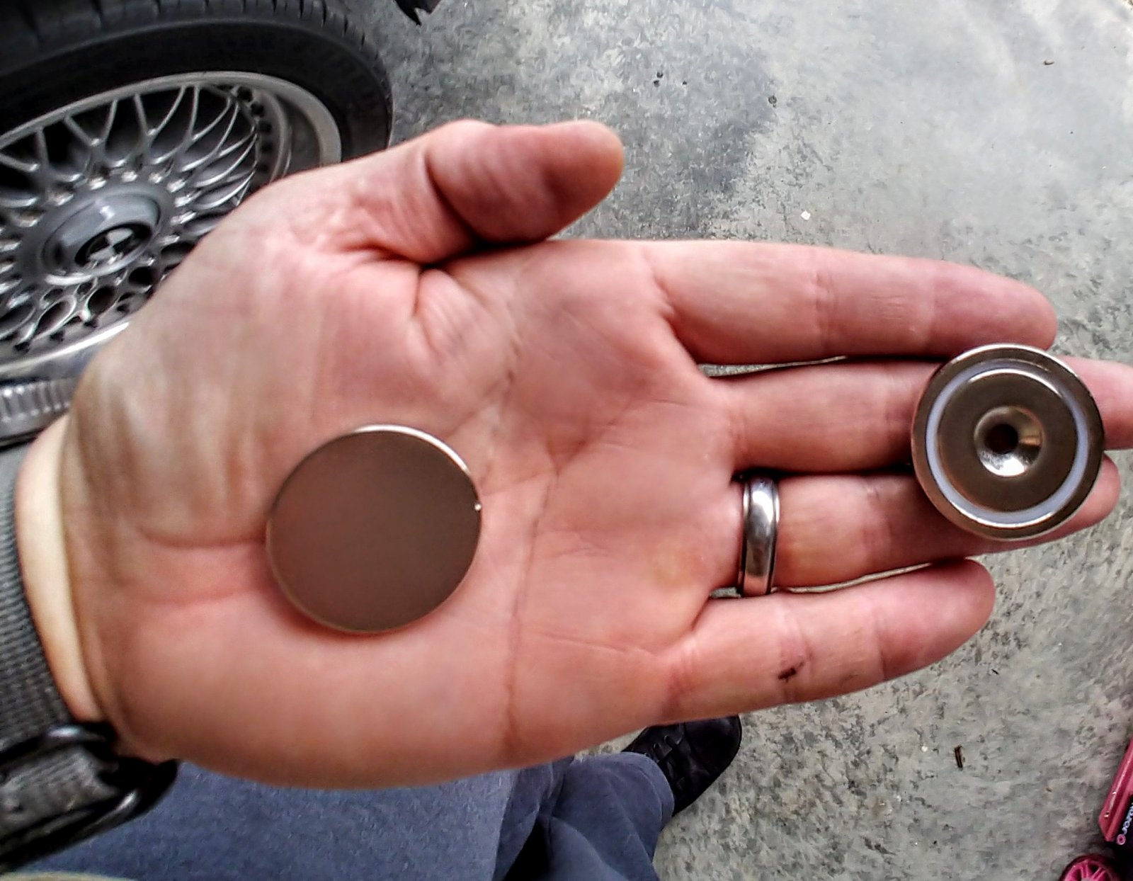

And what kind of magnets did you use? You just lay them in the lunchbox and they hold securely through the aluminum to steel tray?

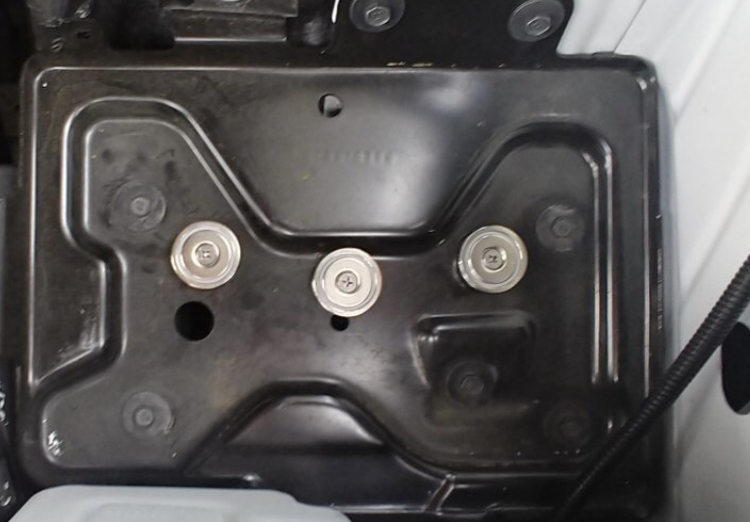

I appreciate the help.... like the idea!
Yes Sir. Ordered some strong neodymium magnets from Amazon. They magnetized through the aluminum and onto the magnets I installed in the tray. See picture 2.

Well, interesting.... magnets don't stick to my battery tray. I bought the metal box and magnets before I realized this. My vehicle is a 2018. Maybe they switch from steel to some other type of metal, but sure doesn't work. My bad!
wjburken
Dec 26, 2017
10,314
29,540
Eastern Iowa
If you look closely, he screwed some magnets to the battery tray then attached mating magnets to the box.
