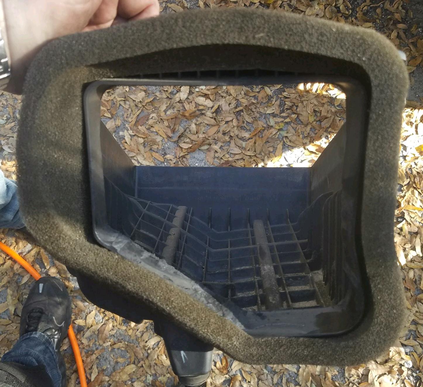

Here is a before shot of the air box.

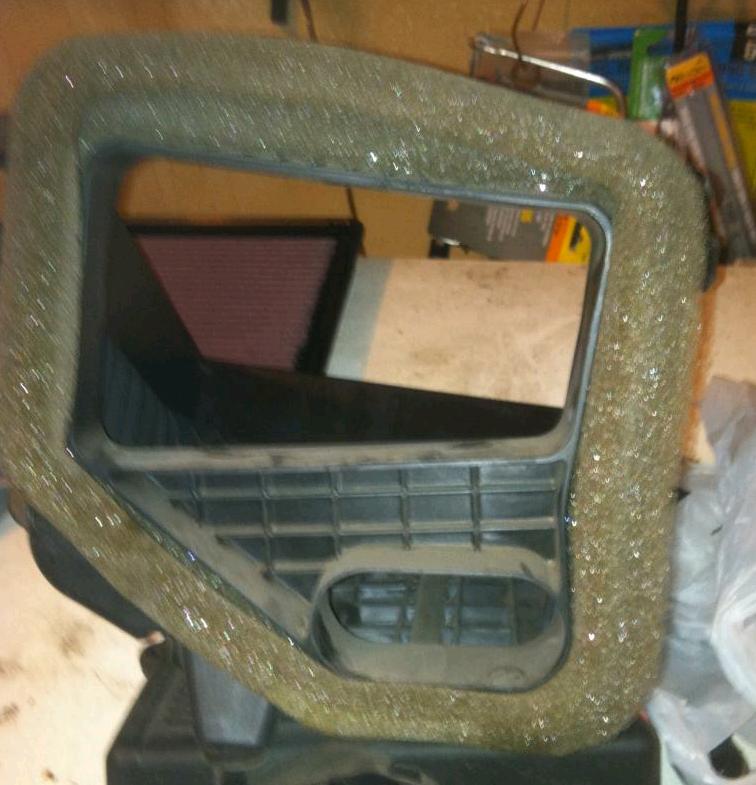

And an after.

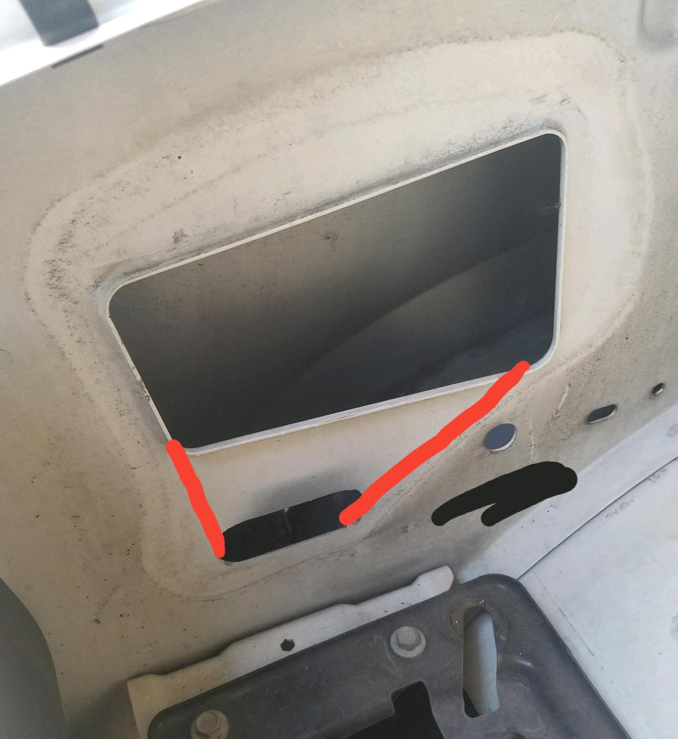

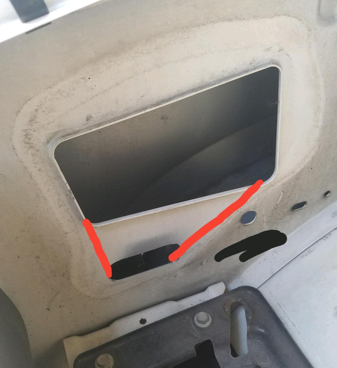

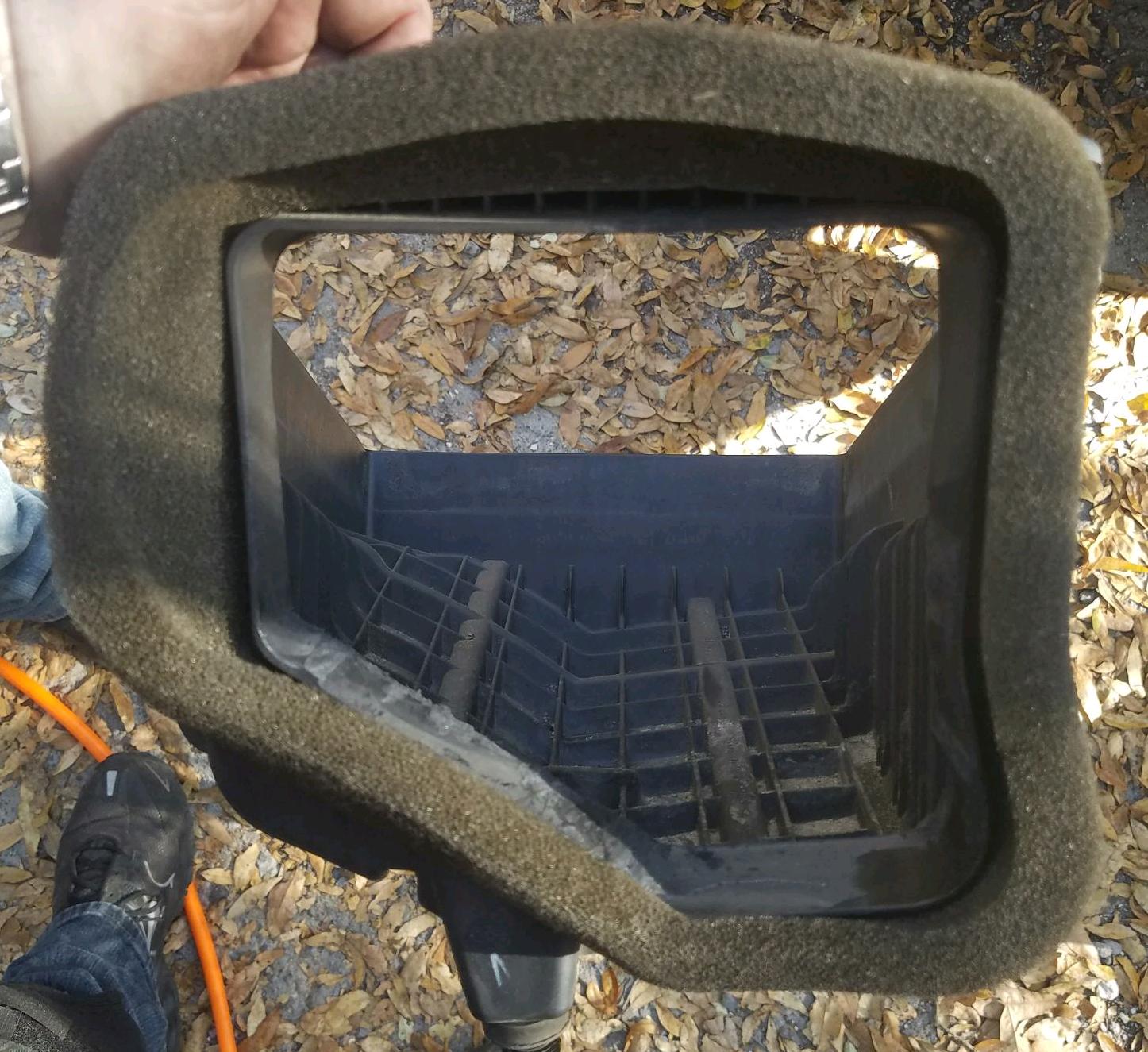

And the inner fender, showing where to cut.
