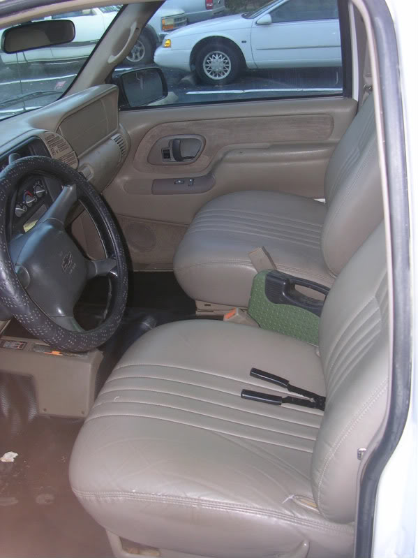

Pics:
---------- Post added at 07:53 PM ---------- Previous post was at 07:33 PM ----------
I followed the tail light wires checking all the plugs if they had power to the passenger side tail light wire all the way up through the fire wall to that relay box but I dont know where to go from there??? Does anyone know how to take that box out or where to check for the passenger side tail light brake/signal in the interior with a multi meter?
