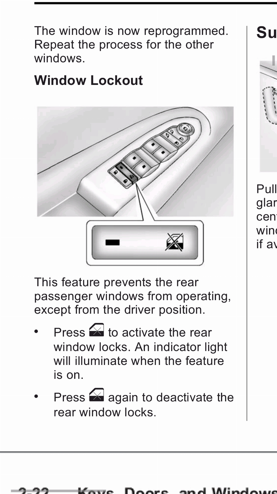

Check and make sure you haven't inadvertently pressed the rear window lock switch on the drivers door armrest

window lockout switch is not the issue. checked that first. even cycled it a few times to make sure that there was not any weird gremlins.
