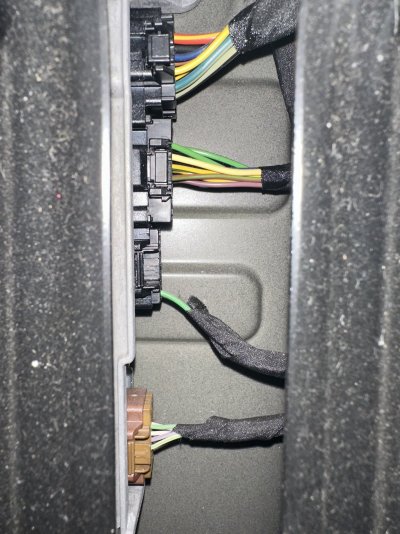

I was curious if my 2016 SLT has ANC equipped? I’m getting a kicker sub and amp installed and my sound guy said he can cut the anc line or I can order a bypass. Which I did but all the videos point towards a Denali only having anc. And multiple videos, the connector that’s gets pulled for bypass has multiple wires going in. Mine only has 1. So I would like to confirm my SLT doesn’t have anc? Thanks!

well a couple ways to tell
1. if you have the anc mic's in the headliner or not (normally one is over the driver beside the ambient interior temp sensor, both look like little speaker grills so there would 2 of these over the driver, the 2nd one would be over the passenger.
2. call or go by a dealer give them your vin number and have them print out your build sheet, the build sheet will show if it has anc or not

Thanks for the info! It only has one mesh grill above drivers side. Not 2. So that fixes my confusion, thanks!
