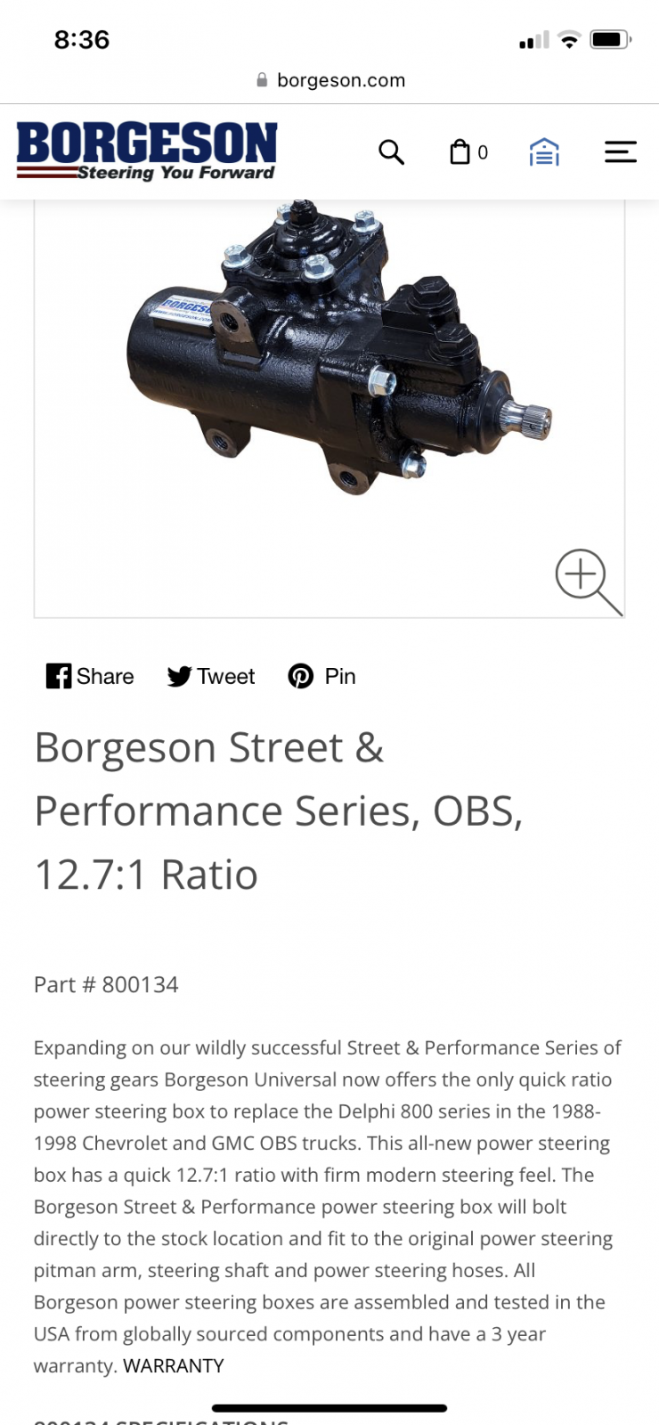

Interested as well. Do you know how a quick ratio would handle versus the stock? Believe it was 15:1?
Two things look promising: it’s assembled in the US and they painted the housing parts before assembly instead of just blasting everything with paint like the cheap remans.

According to their tech support the close ratio title only applies to some other vehicle, not the Yukon so the 3 turns lock to lock remains the same. I also ordered the U-joint steering shaft to go with the new steering gear which eliminates the rag connector.
With the oem 15:1 ratio it takes 3-3.5 steering wheel turns for full lock. The performance ratio12.7:7 takes 2-2.5 steering wheel turns for full lock
