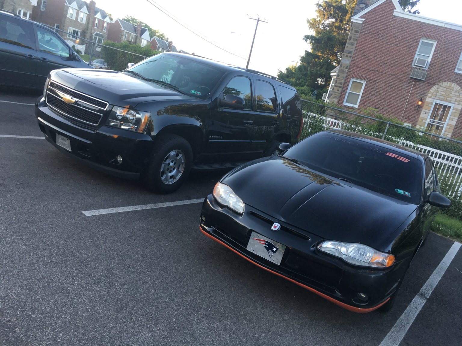

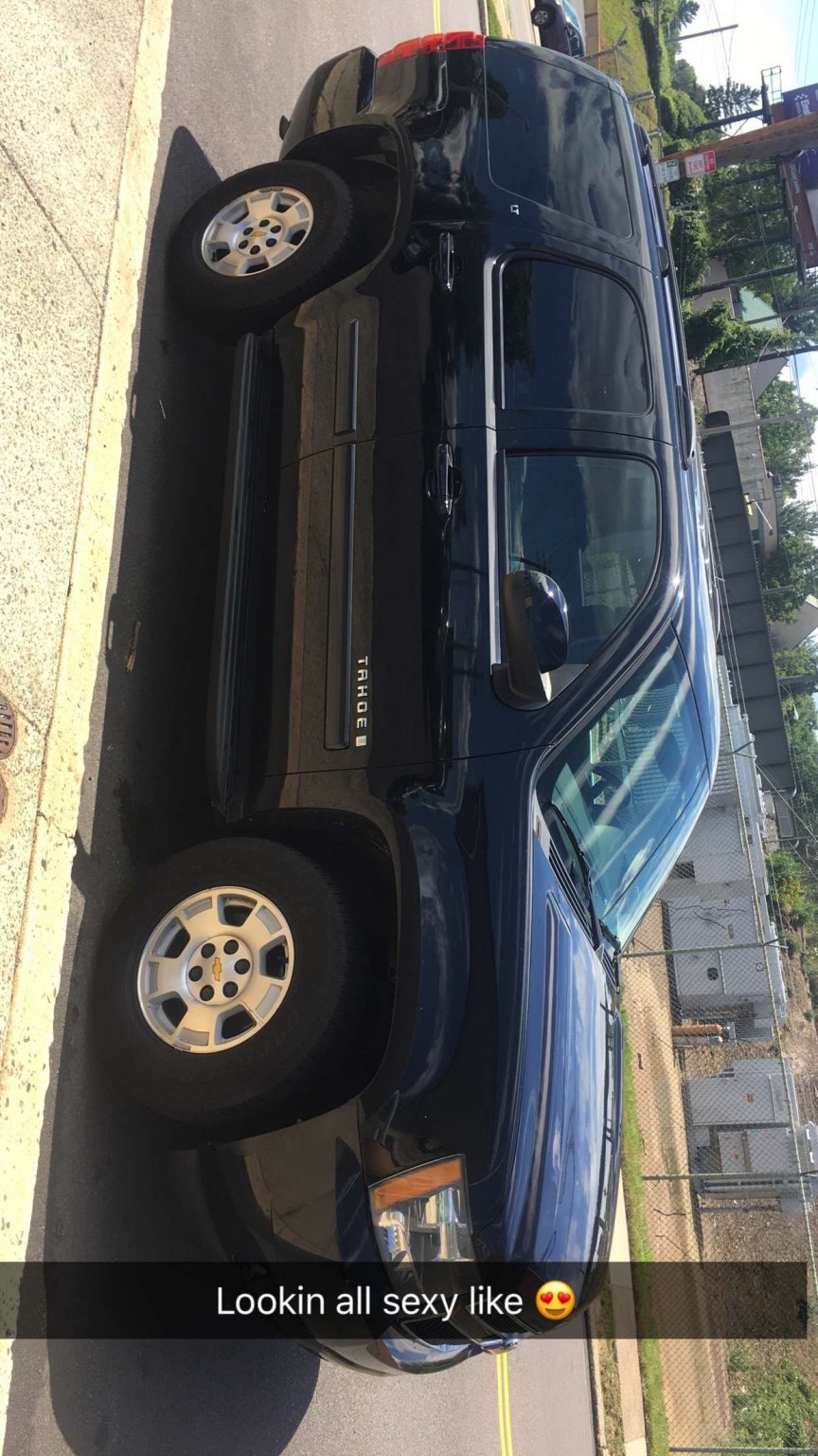

I just got my 08 tahoe lt about 2 weeks ago I know it needs an oil pressure sending unit switch and something with the evap I gotta change under the spare tire I forgot what it was called. I changed the oil and replaced the air filter. I know I gotta change the sparkplugs but with these newer cars do you also change the short wire or they are fine? My other car is 01 Monte Carlo ss. Also what can I do to boost fuel economy my app says I get round 11.9 mpg and the one on the truck says about 11.2
