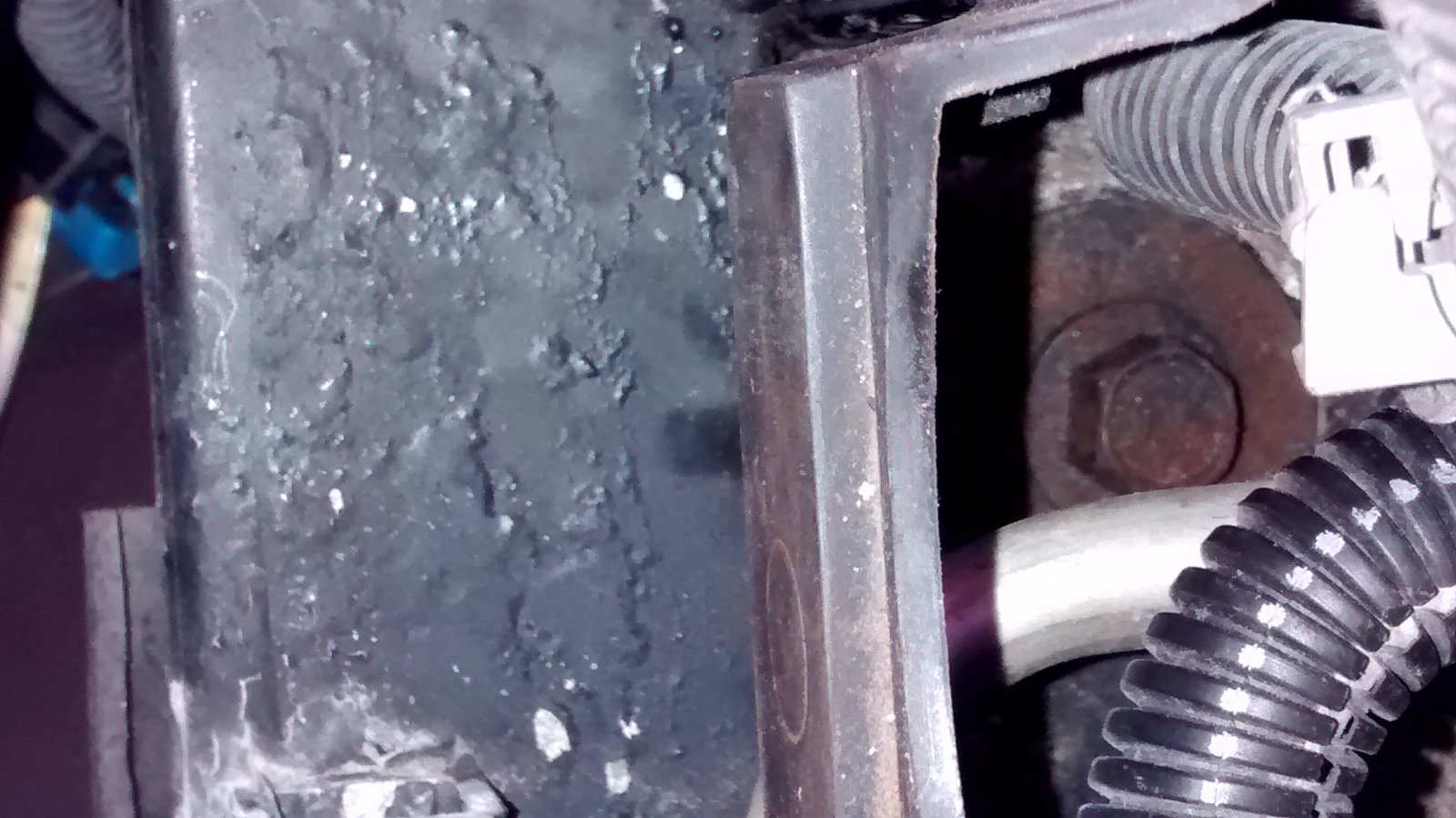

This was one of the body mount bolts.
I also think that a couple of the captive nuts are spinning.
My 2 hour project just multiplied exponentially.

Well, I lucked out in that just the one bolt broke off and the rest can be removed in one piece. I also lucked out in that I figured out how to get it out - I think. The one that broke off was just in front of the rear wheel, driver's side.
Option 1 is if I have enough sound bolt threads left that I can Siamese 2 nuts together to spin it out. I have to remove that wheel and the wheelwell liner, then drill a 1/2" diameter hole so I can give the captive nut a bath in PBlaster first.
Option 2 : If the threads are bad all the way up, I will have to cut an access panel out where I drilled that hole, then use an air chisel to separate the nut from the bolt. New bolt, new nut and weld that cap and the panel back in place.

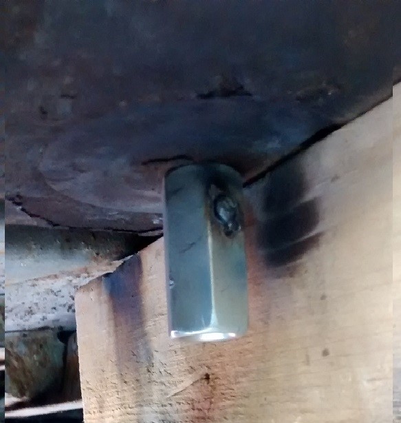

This is what I had left of the bolt that broke after I chased the threads as best I could. And look at that rusted-away platform ! 3 of them were in this piss-poor condition.:
I bought a coupling nut and tacked it on :
If I had to do this again, I would have gotten the non-hexagon type coupling nut. This one didn't fit within the metal bushing shoe(?).
