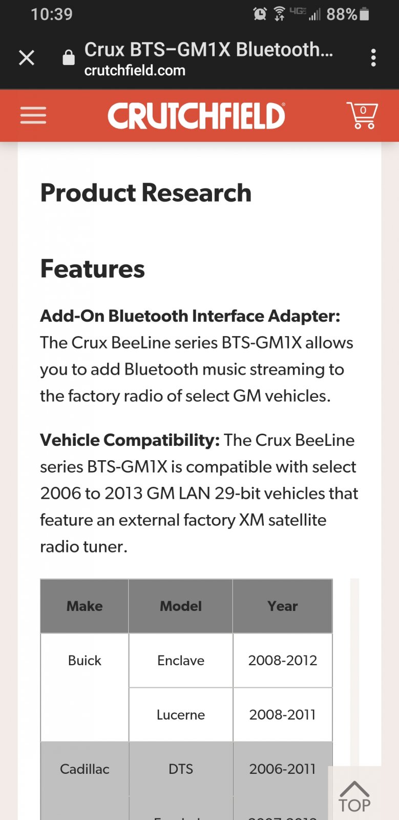

That may not work if your XM tuner is built into the radio head unit.
I bought one of these a couple years ago and I couldn't find the XM receiver that was supposed to be located behind the glove box. My XM antenna runs directly the the head unit. I returned it.
Last sentence on this page. Look behind your glove box before ordering to make sure you have a separate XM receiver

Nothing there. This won't work. Back to drawing board...
