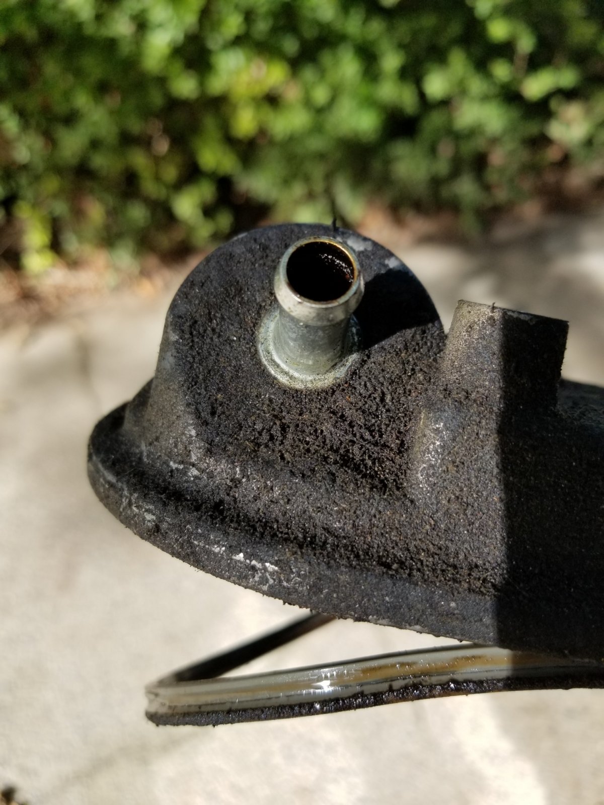

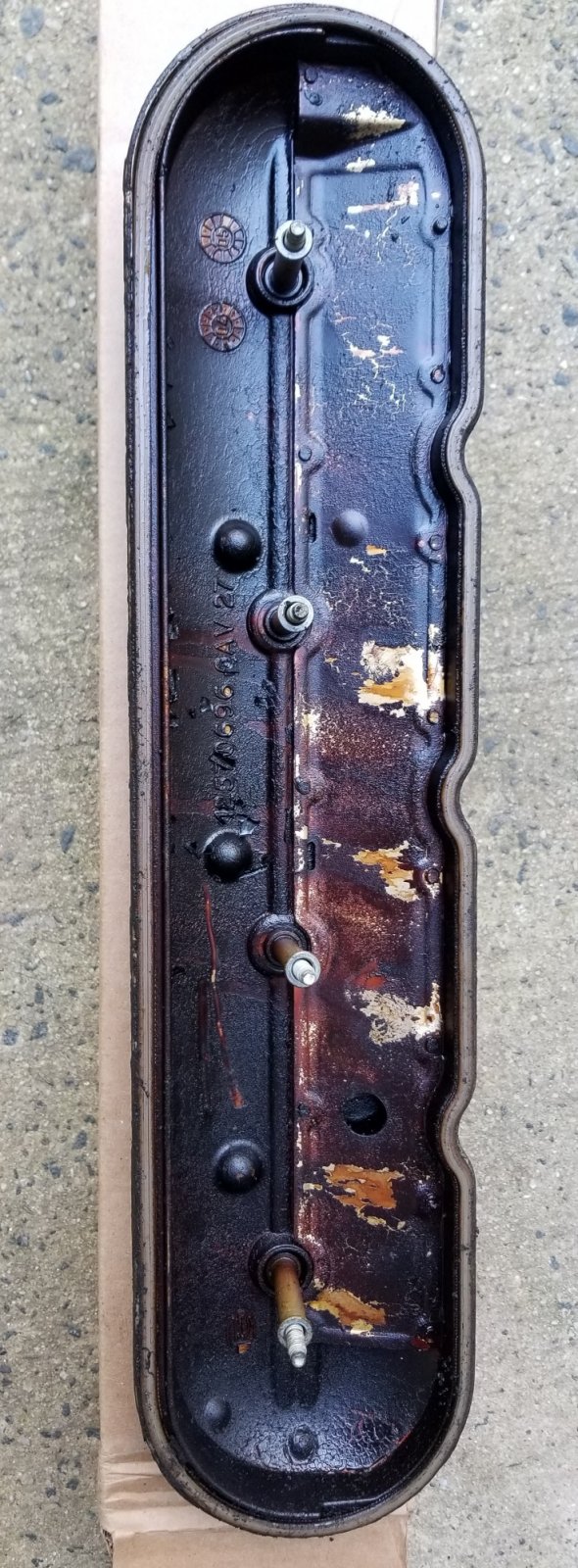

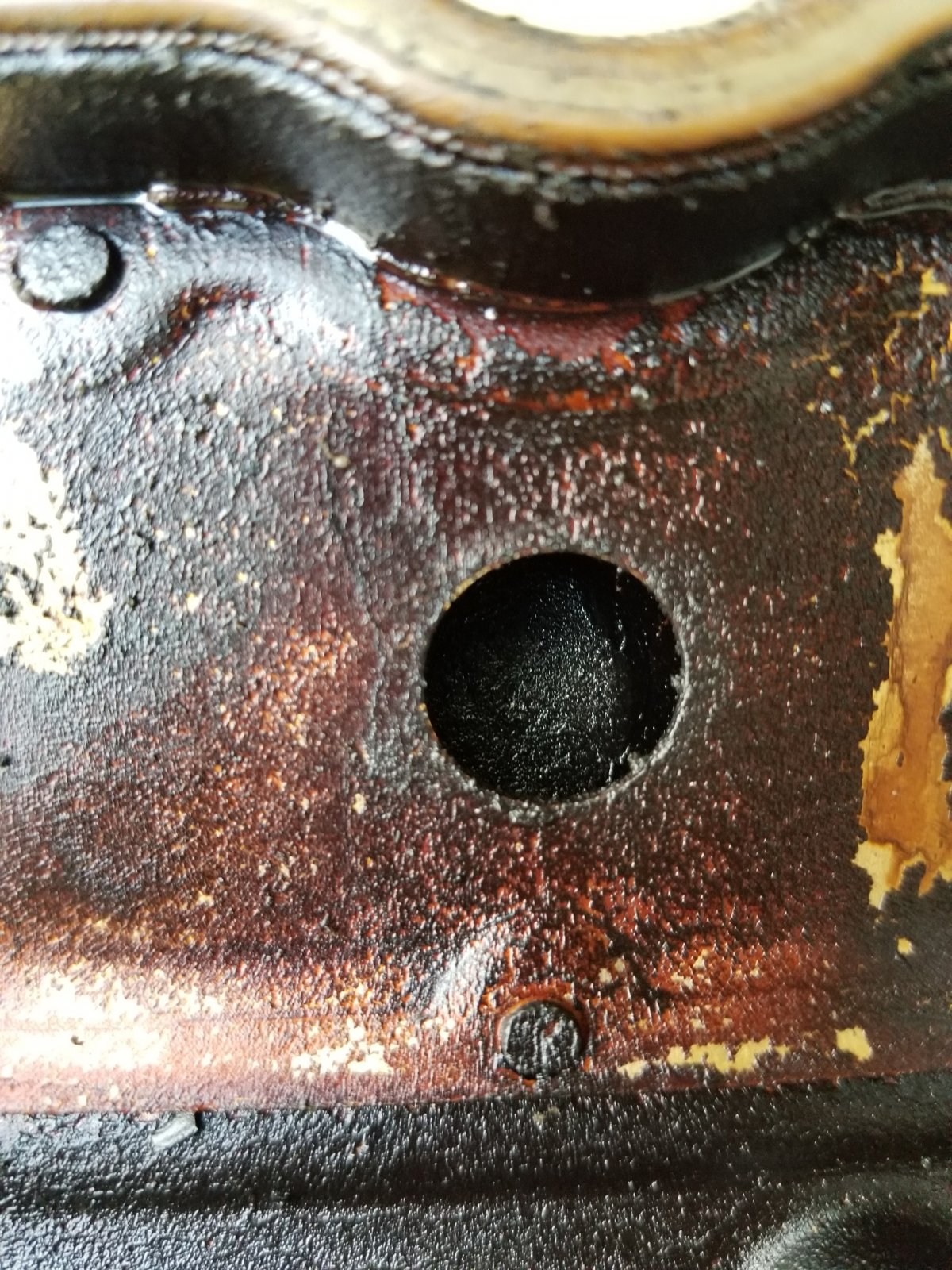

Replaced the left side valve cover (built in PCV valve) as recommended with the updated design-valve cover GM Part # 12570427. Pictures of the old valve cover shown here. Quite a bit of buildup at the drain openings which probably allowed oil mist to move through the PCV valve. We'll see if this rectifies the situation. Thanks for the tips everyone.
Tahoe left side rocker cover .jpg Tahoe left side rocker cover 1.jpg Tahoe left side rocker cover 2.jpg Tahoe left side rocker cover 3.jpg Tahoe left side rocker cover PCV 1.jpg
OR VietVet
GMT800 2005 Tahoe Z71
Navy Supporting Member
Oct 8, 2014
23,719
44,161
Willamette Valley
While the updated valve cover can't hurt, I agree with @Scottydoggs and @89Suburban say. At that mileage the seals are likely the cause of the blue smoke at start up. The longer you sit after shutting off the engine, the more smoke you see. If I was really doing it right I would pull the heads and do valve guides as well and surface the heads and do new head bolts and gaskets. The easier patch is just doing the seals.

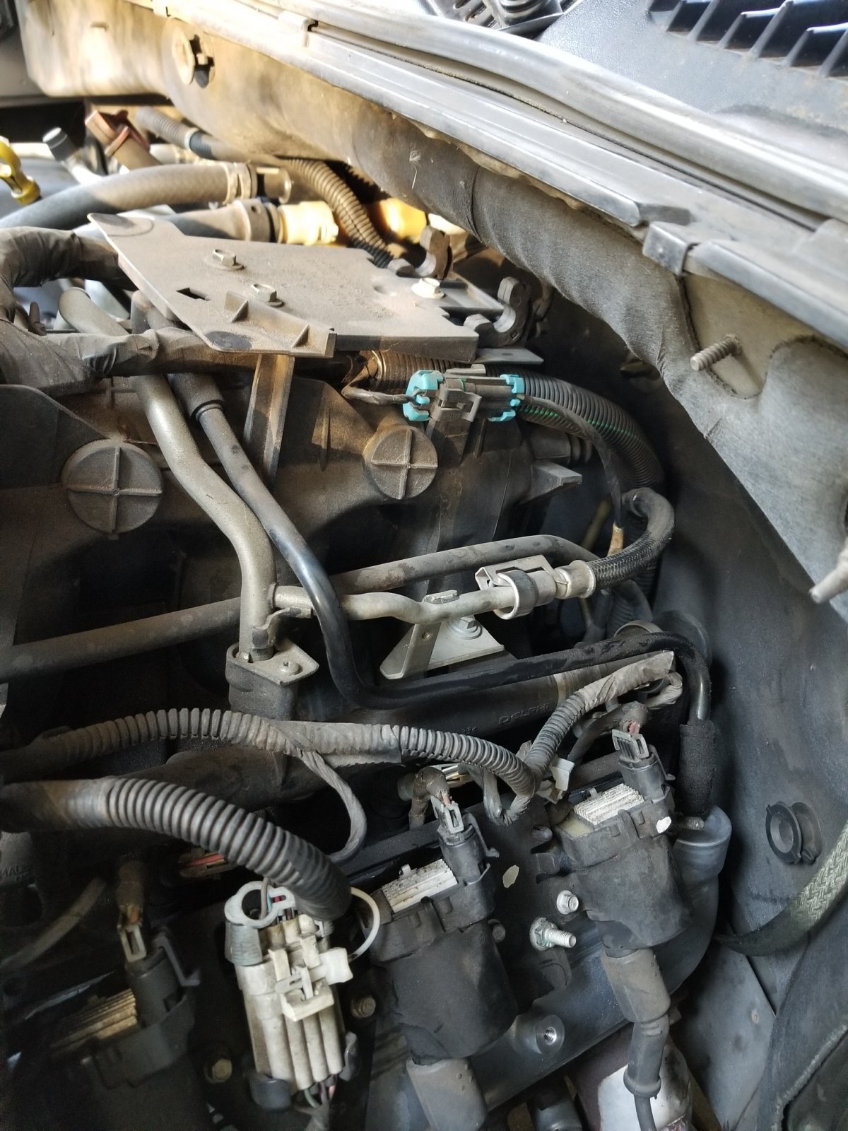

So far no blue smoke from the tail pipe at start up or anytime thereafter. Can the forum members assisting me with this post help me find the correct AC/Delco part number for the hose that comes out of the PCV valve and feeds over and into the top of the engine? This is a 5.3L 2005 Tahoe, VIN #1GNEC13T25J209032. I know for sure AC/Delco part # 12582227 is not the correct one. I thought I would replace that line now that I have a clean valve cover and clean PCV valve. I can only imagine the residue in that line which is the reason I thought I would put on a new one. Thanks for the help!
Scottydoggs
Dec 16, 2017
2,882
4,520
NJ
id re use that line, why spend money needlessly. if you think its caked up spray it out with brake cleaner. or just put a catch can between them two ports.
