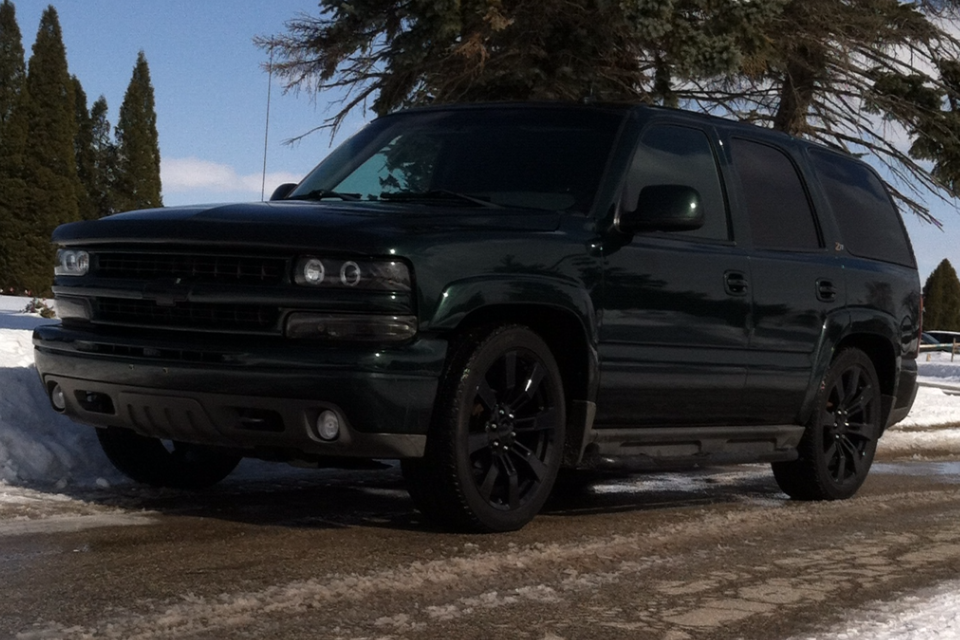

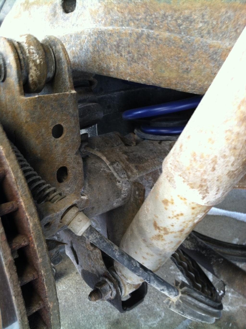

I wonder what shocks are those?
Rear need shock extenders
im looking at your bumpstop to axle and there is not that much clearance. I would pull them out and cut them down about 1 inch.
Right now the rear shocks are compressed no extenders and i bet those shocks arent made for lowering. pull off rear bumpstops cut them down and then do the rear shock extenders/belltech sp shocks. I sell them for $200 shipped to your door and that would be a good starting point along with cutting off the bumpstops
