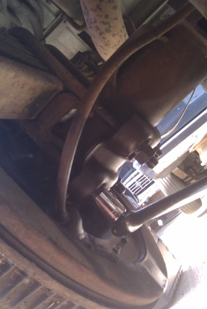

:hands: Shit happens. Not exactly what you want to be doing in the desert though. The truck we pulled the rear end off of, all the hardware was corroded on. Took half a day to get the ***** off. Geez, it was hot. Finished putting it together late the next morning under the hot ass desert sun. Then drove back to San Diego, three hour drive. Made it back in time to shower, eat and go in to work a 12 hour shift on night crew. Just got off.
Got the new axle on, same gear ratio but no locker at all. While the truck is rolling I have time to weigh my options. Take my busted rear end, and rebuild it Bionic Man style, better, faster, stronger. Build it up nasty as hell.
Or, go balls out and get a 14 bolt and convert that. The junk yard I got that new 10 bolt out of had a good number of them. If I go that way, might as well convert to disc also.
Or, go 12 bolt.
Or, there is a company that makes a 12 bolt diff carrier that bolts onto a 9" housing. Meaning if the problem ever comes up again, I could just swap the diffs, Ford 9" quick. But that shit was expensive. I'll post a link for that when I find it again, but I'm tired now since I've been awake for 24 hours now. It was Currie I think.
What ever I do, I'm going 4.10.
So, guys, help my decision making process. Giving some pro/cons, opinions.

The guy in the red truck is a friend I always go wheeling and camping with. Funny thing is it's usually his truck that breaks. But I decided to push it with some rock crawling. It was just the one rock. Biggest rock on the trail. Was almost over when the tire let go and dropped off and started the bounce.
If you can't tell, he has no bed.
The thing holding up my truck is my spare tire carrier. Which I rescued from the trash only a few days before this trip. Stripped the rust and painted it. Somebody made it and made it tough as hell.

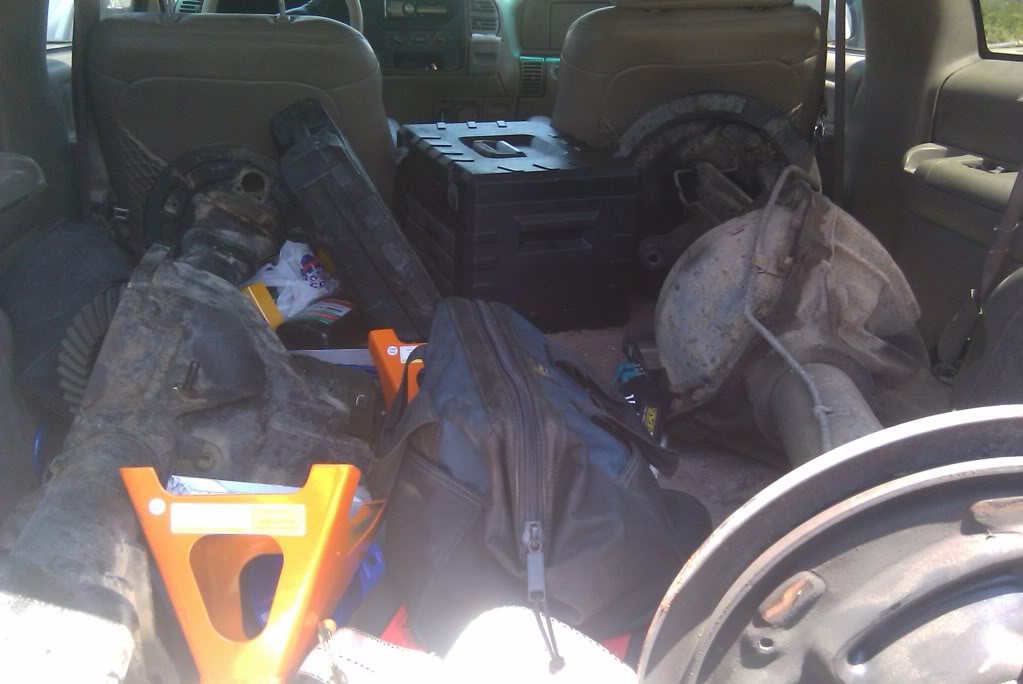

Independence Day update:

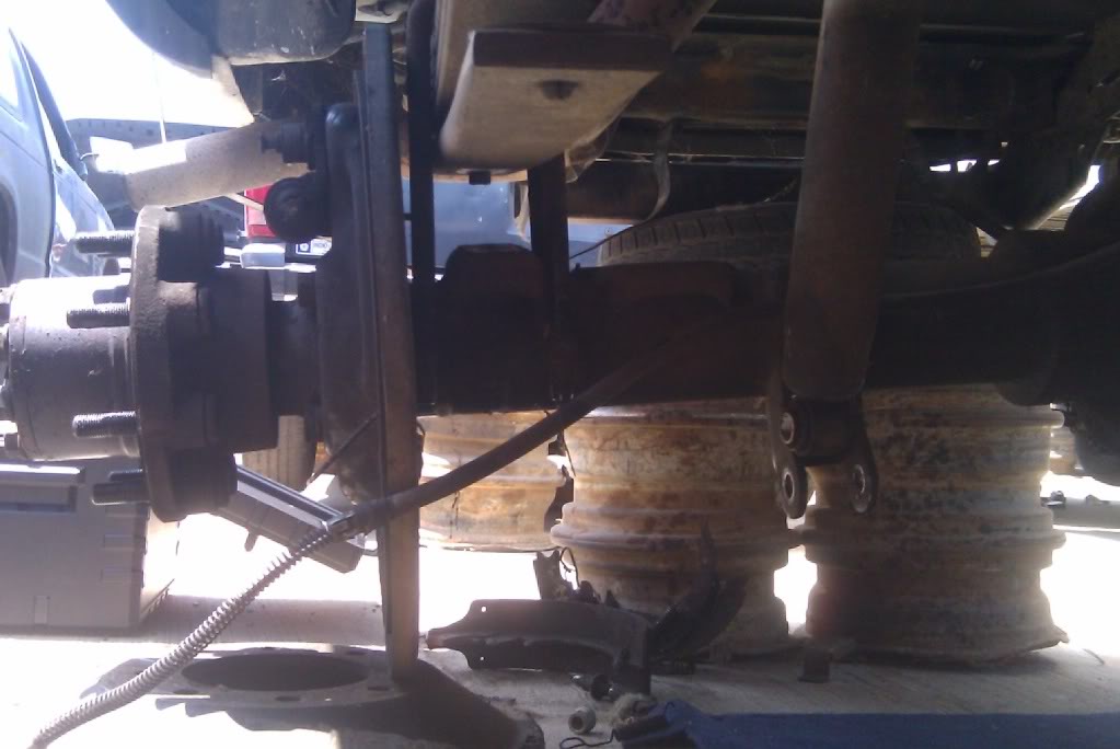

Went back today with the ol' tape measure, the most scientific instrument I own. And it seems all the mounting surfaces are the same size and same distance apart. Even the yoke appears to be the same size. So, I started pulling.
Learn from me and I suggest 2 -3 people even if those other two are only to help lift/watch for spiders. I read this thing weighed 550 pounds, I was hoping it was an exaggeration. It was not.
Did I ever tell you guys I don't like spiders. Especially shiny ones.
Bring a couple cans of BrakeKleen and WD-40. This will help loosen the hard ware and kill spiders.

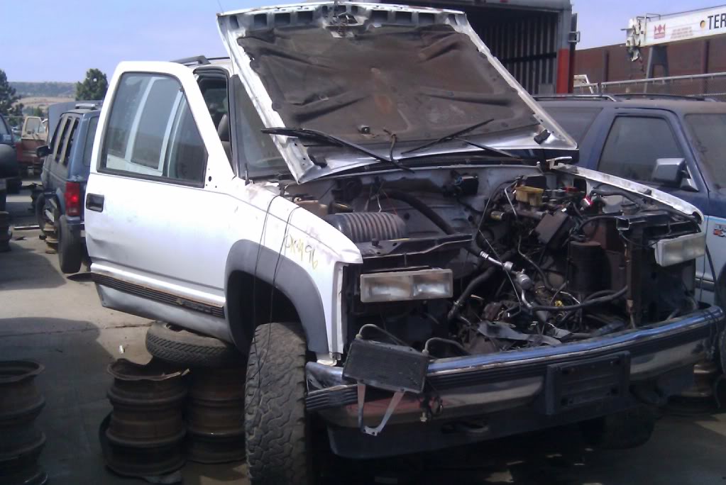

The donor truck. A 1996 2500 Suburban:
The axle:
Mother ******* spiders. "How's WD-40 Taste, *****."
Mother ******

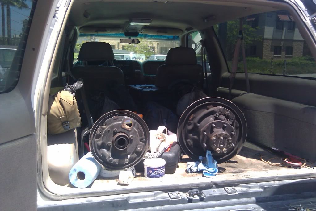

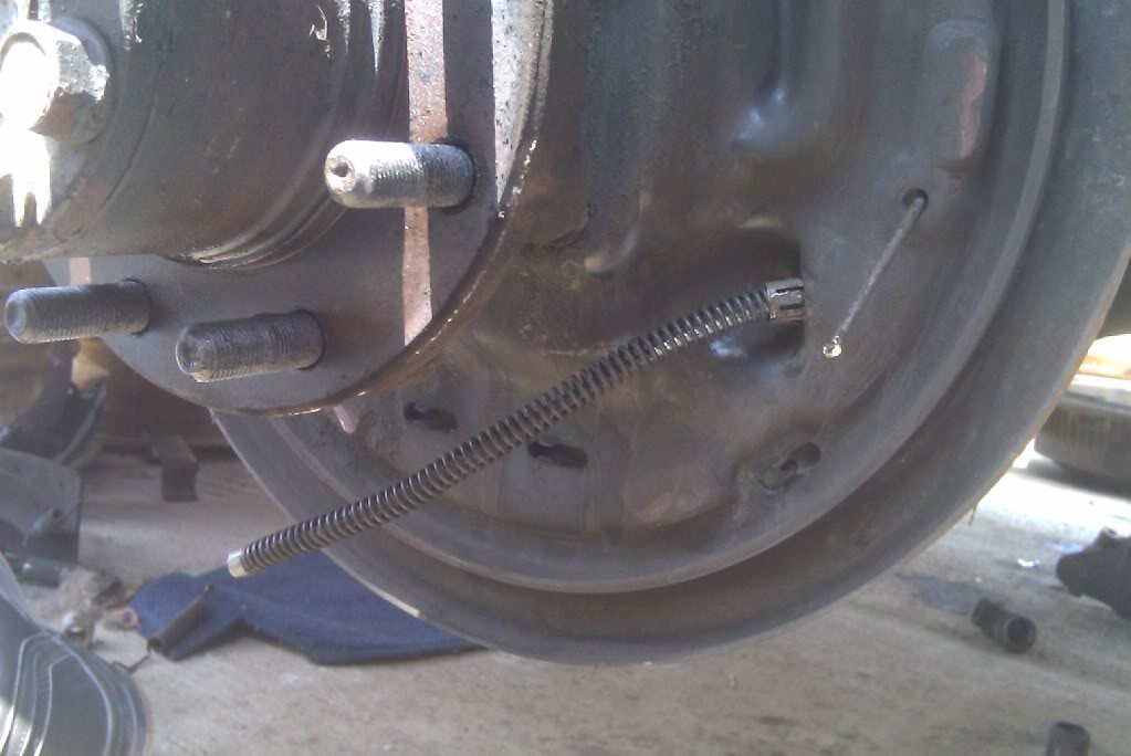

I pulled and ditched all the brake stuff. Since 1: The shit is huge and 2: I'm going to convert it to disc. The drums come off just like ours, though these were rusted on. Some WD-40 and my 3/4 drive ratchet hammer broke 'em free. The E-Brake cable and that little clip there, yeah, that clip. He's an *******.
These u-bolt nuts were 15/16" The shock bolts were 21mm.
This one played the game, "Wait 'til you turn your head and I disappear so you worry about wear I am the rest of the time you're here."
One side off.
What the ****?!
Almost. I left the brake lines on the axle. That little union there is held to the bracket with a 1/2" bolt and the lines were 9/16" wrench.
She's free.
In the Esca-Hoe. Next to the blowed up old 10 Bolt.
Best side by side/size comparison you're gonna get for now. Because I don't feel like muscling either of those around anymore.
These thing was a pain in the ass to get into the 'Hoe. The 10 Bolt, if I had to, I could load by my self. The 14 bolt, you will not be able to load by your self. Unless you're like, Jay Cutler's big bro or some shit.
