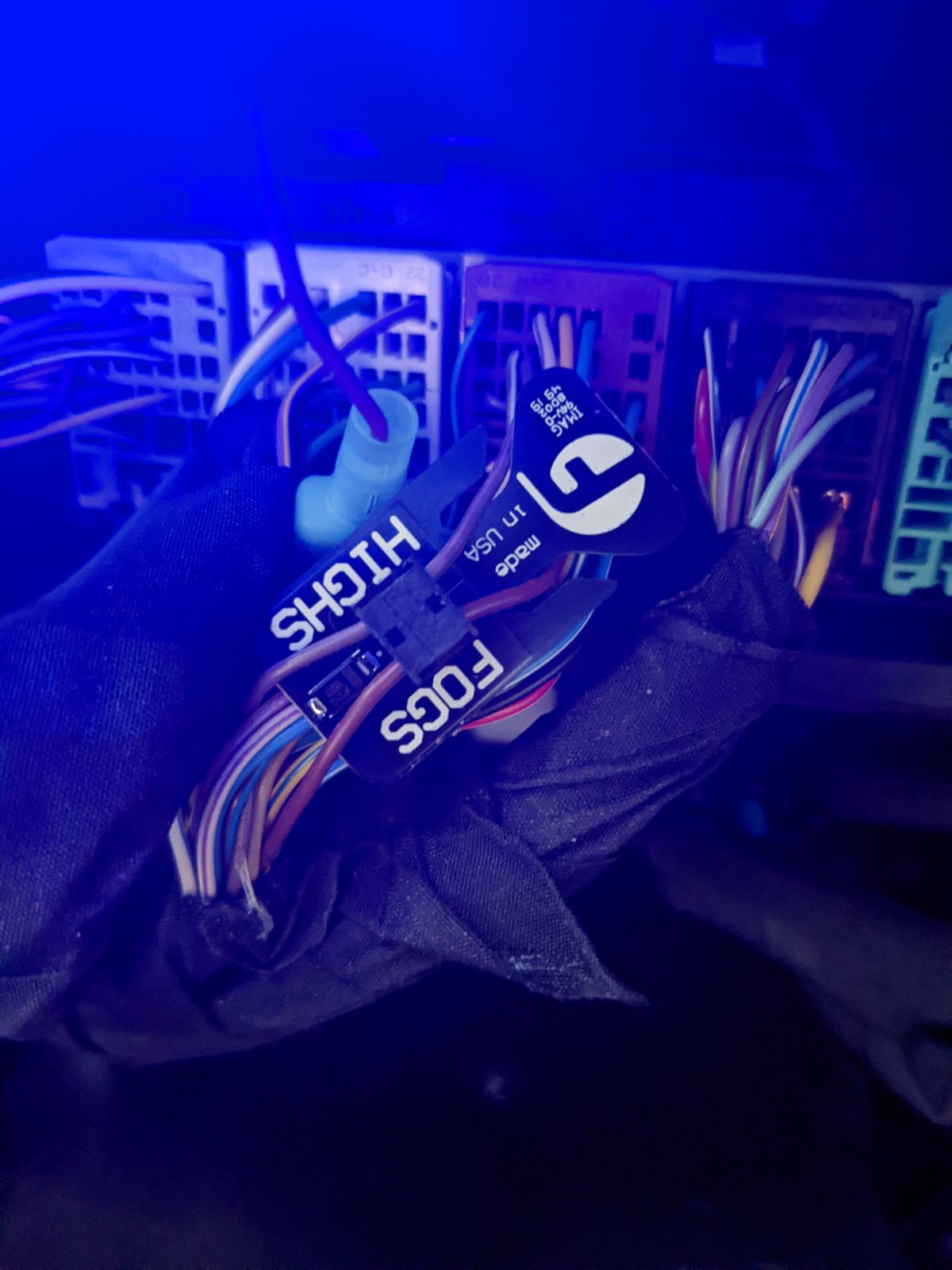

Got the fleece high's & fog's board installed, super easy compared to the yukon

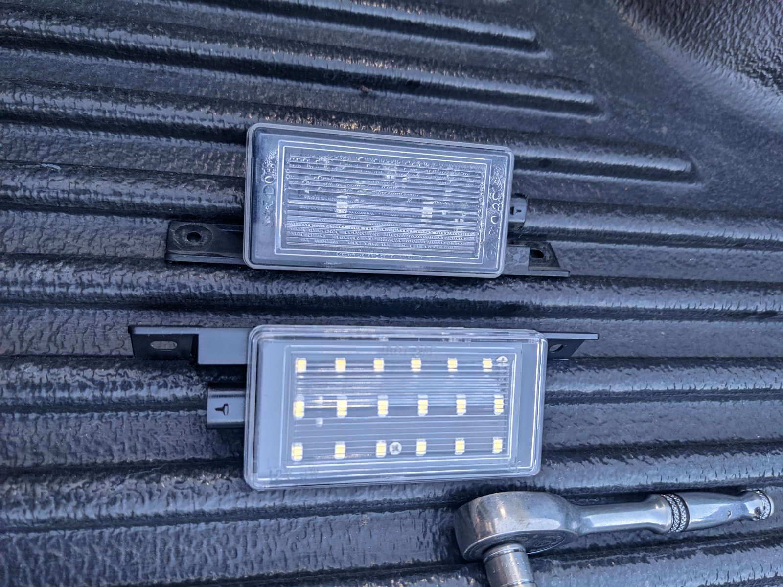

When I was moving the inventory and cargo shelving from my old work van to my new one, I grabbed the flush-mount LED cargo lights as well. I recorded the dimensions of the rectangular holes in the roof supports they snapped in to so I can cut perfect holes for them. I might replace the surface mount LED pods I currently have in my rear hatch.

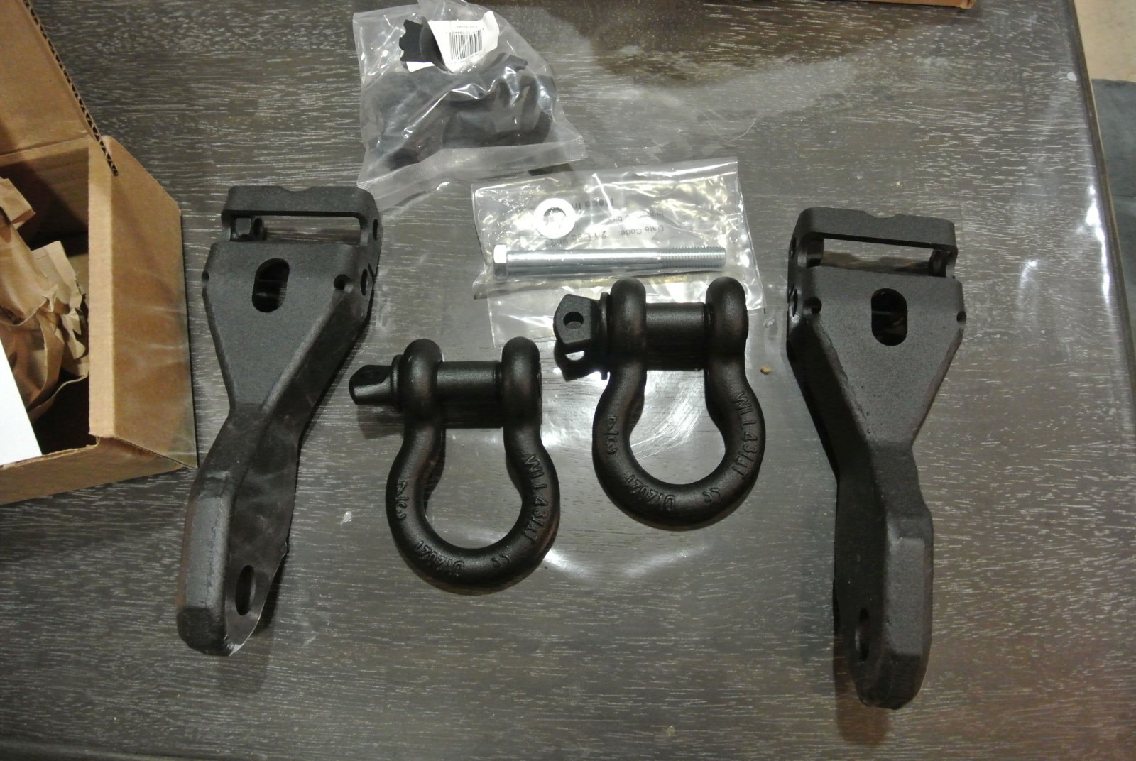

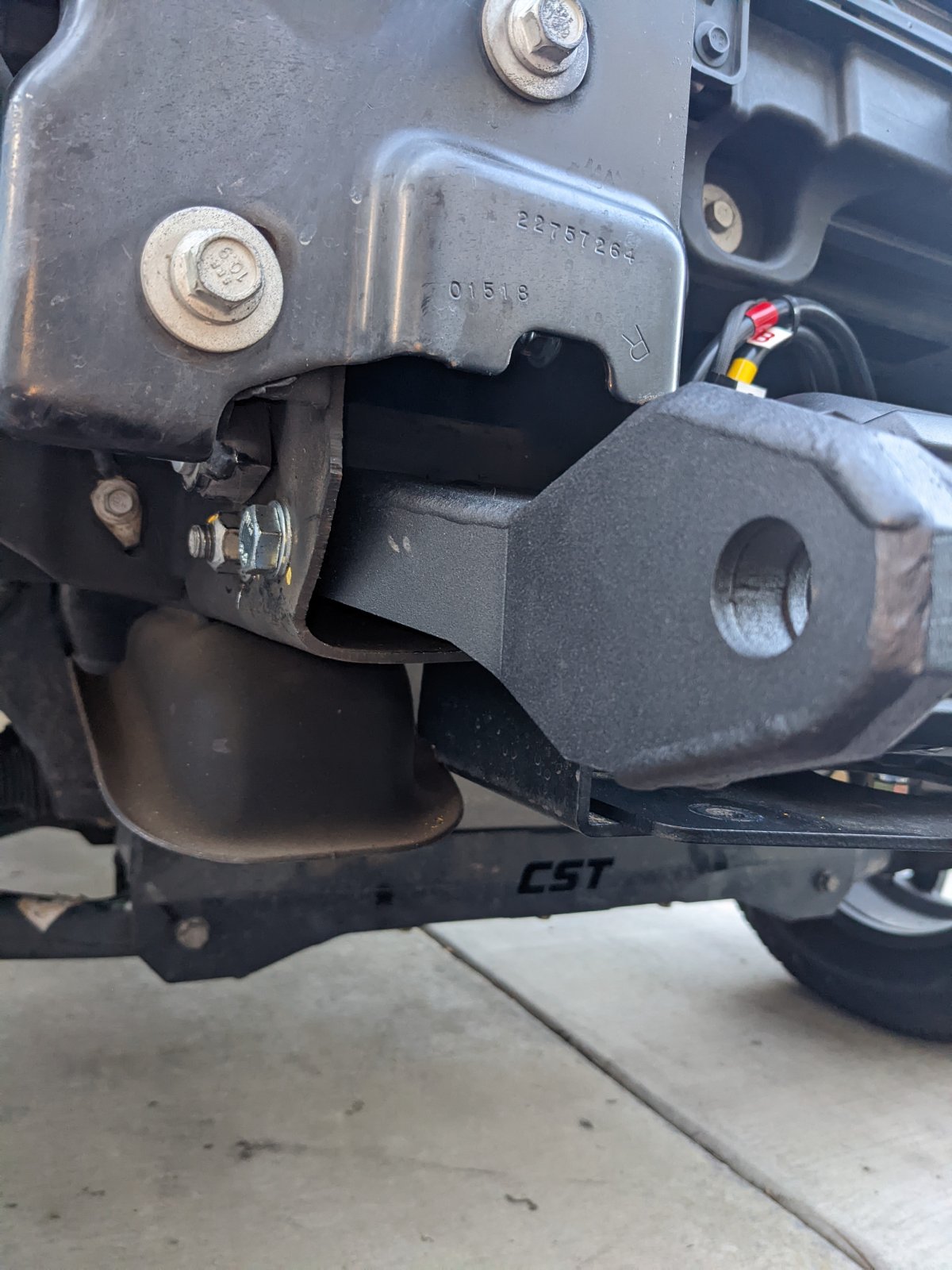

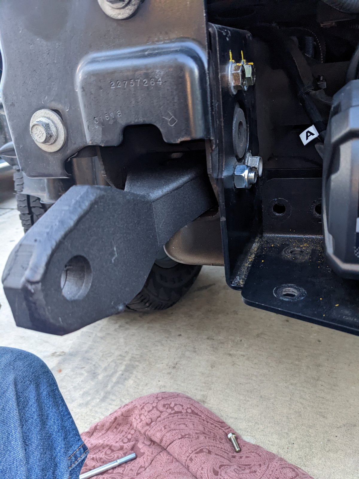

I was going to try and put the d-ring kit on today but it looks like the winch is def in the way so going to take more work than I thought gonna half to be a weekend project.
30,478
47,822

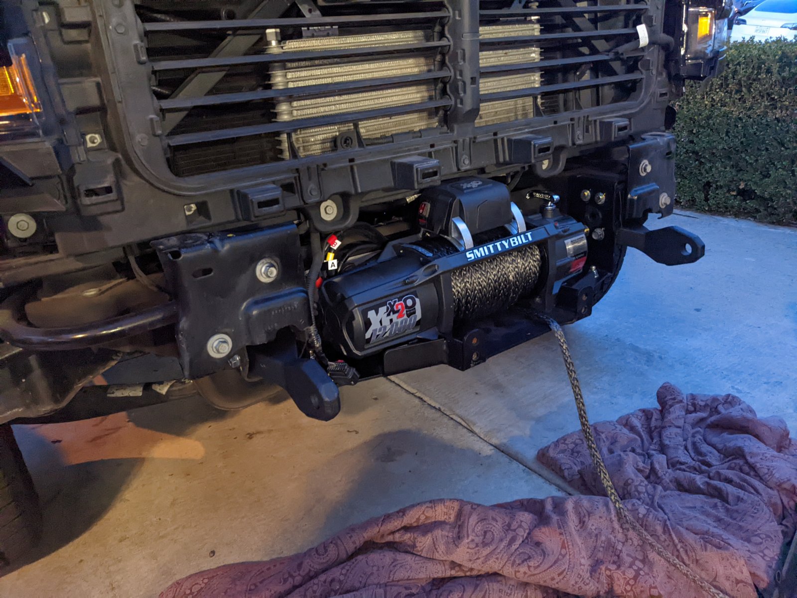

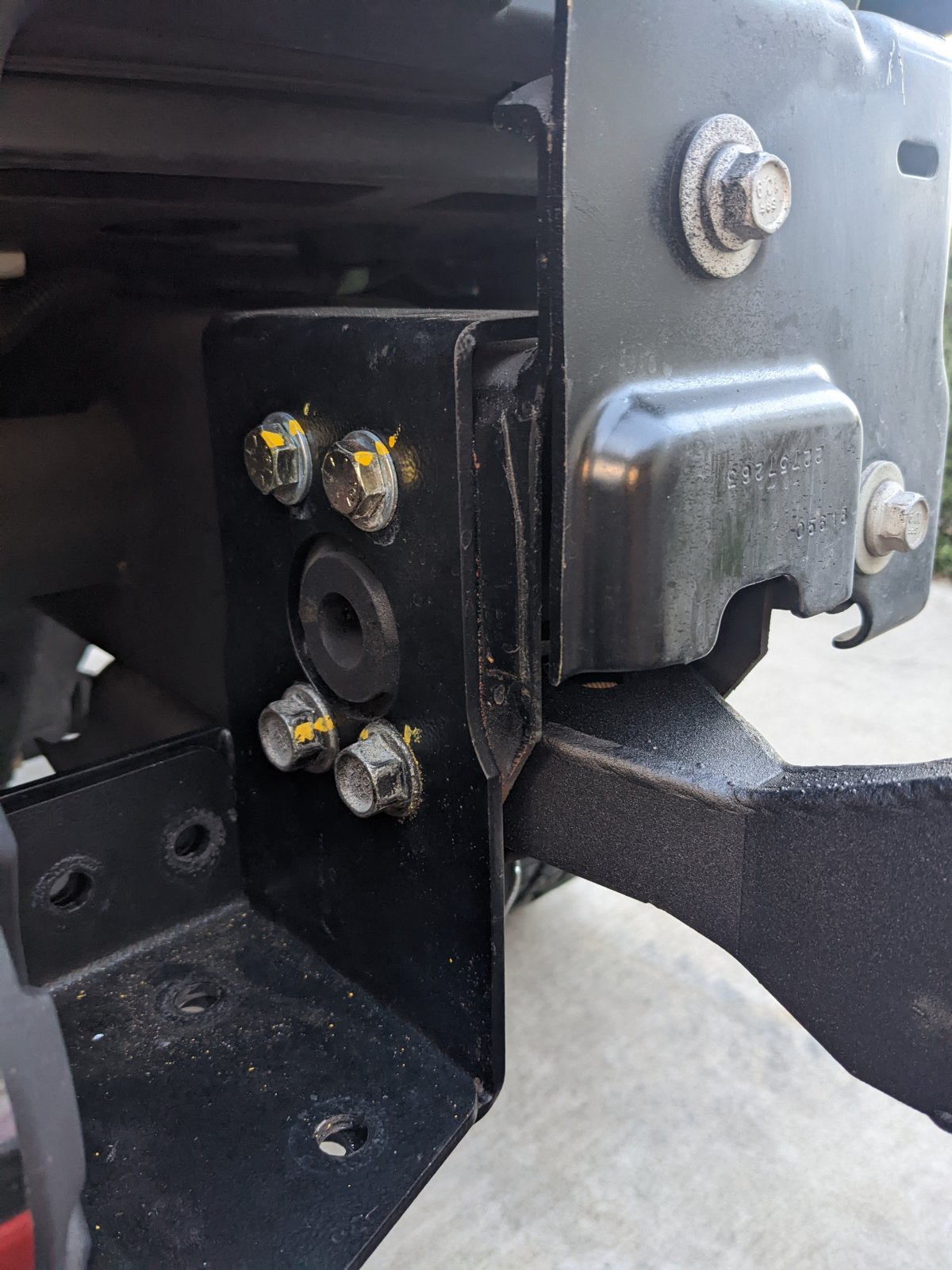

well this took a bit more work than expected, had to take the grill off, to get the bumper off, to unbolt the winch, lift it up get the tow hook bolts in & out and then put it all back together.
had to hit a couple hardware stores to get a bolt as well, drivers side was easy once the winch was moved, passenger side I had to thread a bolt in reverse because the winch mount has a extra bolt hole. Initially I thought I was going to have to have a nut welded to the bracket but everyone was closed so after a little brainstorming I figured out I could thread a bolt in the opposite direction and still add a nut, so hours later lol it's done and of course it's dark now so I will get another picture tomorrow
