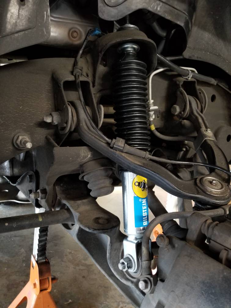

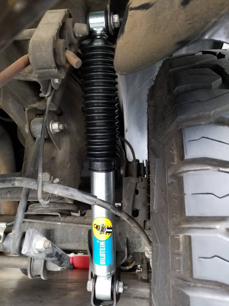

I installed the Bilsteins this weekend. I must say they are amazing! The Ranchos were totally shot! I am so glad I made the switch, and the truck rides much much better. Thanks for all the help and replies TYF crew! [emoji106]
