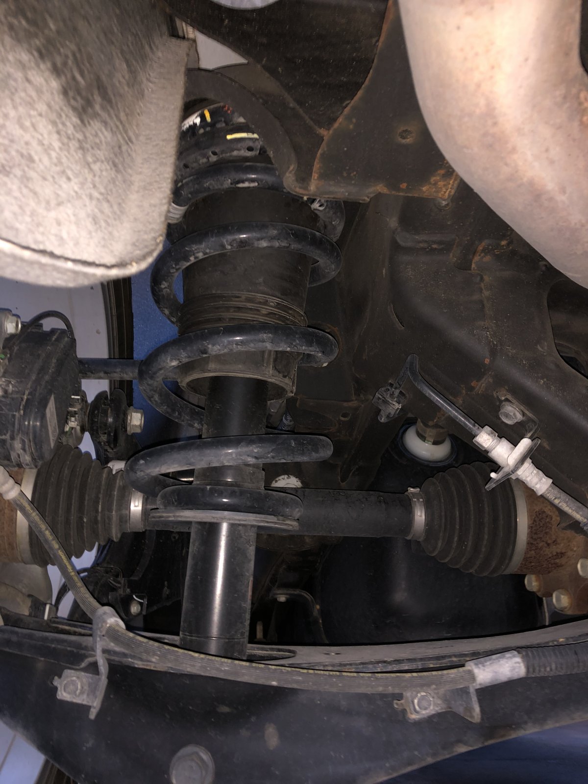

Well i looked online at pics (wife isnt around to look at her vehicle) and they do indeed have a coilover shock type setup out back as well. So i dont see why these wouldnt work.
I initially thought they just had regular coil springs and separate shocks…that does not look to be the case with the pics i see online.
These should work just fine. I personally would not go much more than a few inches of added height though without dropping the center sections, as it may be difficult to get the alignment back into spec.

Yep. Definitely a coilover shock in the rear too.

Yep. Definitely a coilover shock in the rear too. View attachment 379707
Yep, looks like a suitable candidate for the Bilstein 5100's. Who's going to try it first? :)
