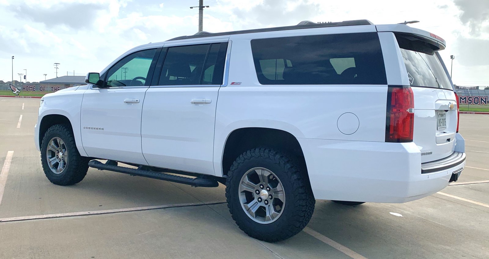

Nice Setup...I've been going back and forth with 4 inch Readylift kits and level kits but I think I'm gonna do the Bilsteins after looking at your rig. I know it's gonna be a little extra but I think it'll be well worth it...if you don't mind, I had a couple questions.
1. Ride quality with the 1 inch spacer in back...is it pretty equivalent or better than stock...could you do without the spacer in the back and still had a nice level??
2. Planning to put smaller 33s (285 65 18) w Bilsteins to highest setting. Do I need new upper control arms?? Or am I cool with stocks. Planning to run my stock Rims.
Thanks in advance!!.This is the first time I'm touching anything involving suspension so I'm going in a little hesitant.. but I'm sure it'll be just fine once I see the difference from stock.

1” spacer with ride like stock. UCAs are not 100% necessary but are a good idea; you’ll need to ensure the UCA clears your wheel and tire combo.
