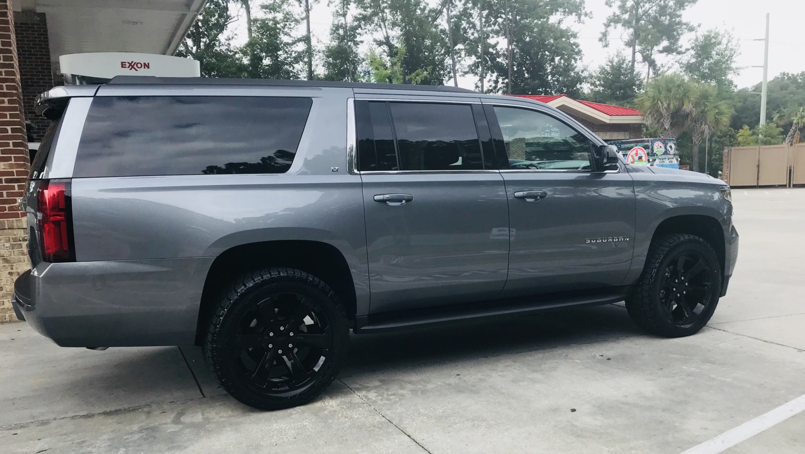

I have a 2017 suburban lt Z71 midnight edition. I have the black 18 in wheels. Swapping them out for a set of 20s. On stock ride height will 275/65/20 rub at all?

Larget tire I have had someone use is a 33/12.50/20. I suspect the 275/65/20 should clear. I have had a few customers use that size on the GMC Sierra Denali 1500 with our smx-gm725M leveling kit.
