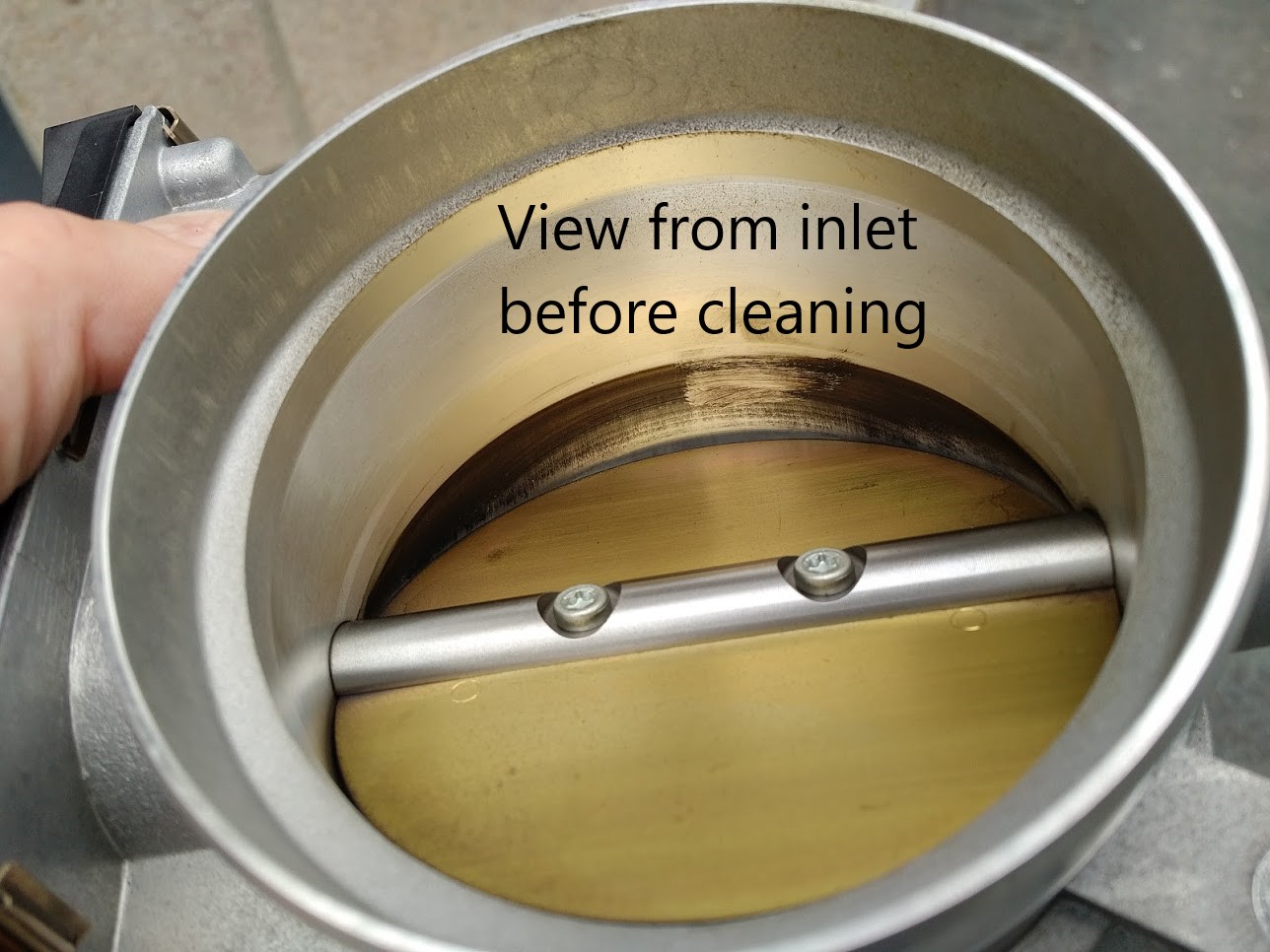

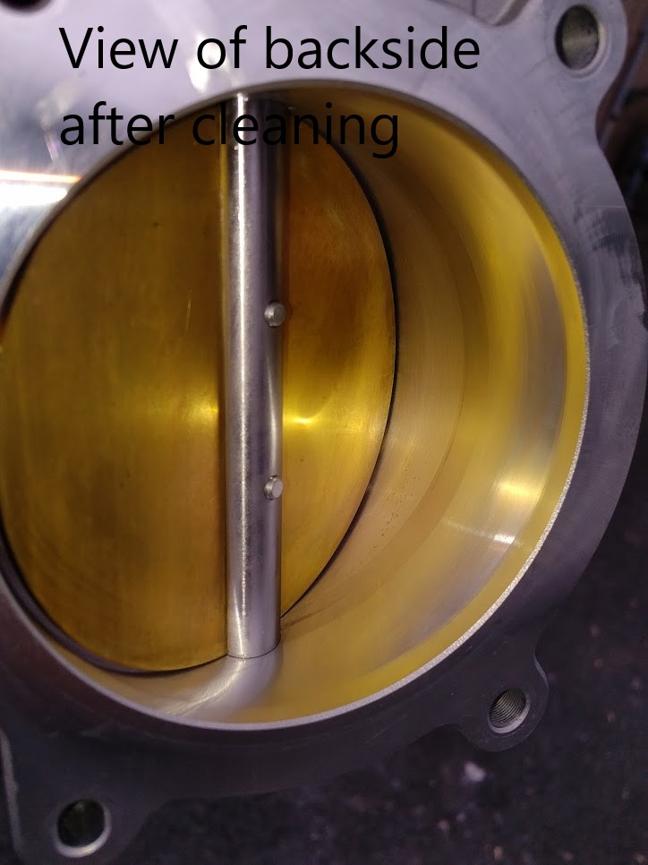

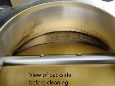

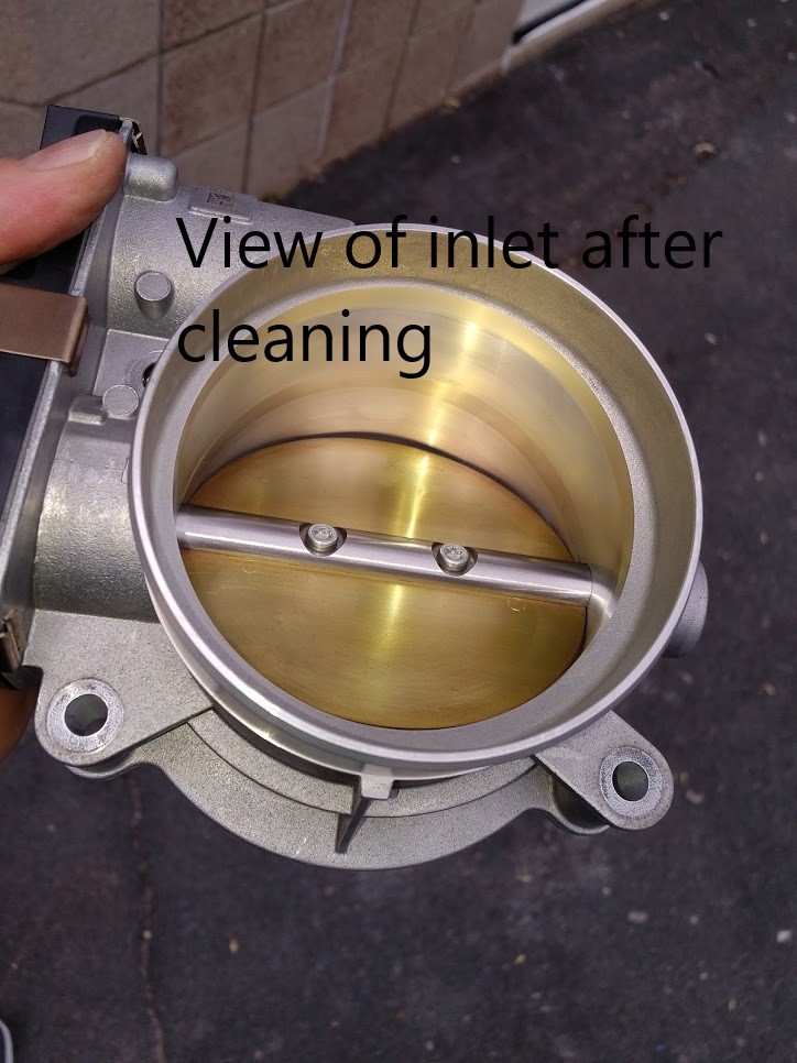

I'm following up on my original post and also saying thank you to "Wildcatgoal" who suggested it might have something to do with the throttle body. I finally got some time to dig in to things and decided that the throttle body being dirty was a good bet - In spite of having only 12,000 miles on my Yukon. I bought a can CRC MAF cleaner and also CRC throttle body cleaner and first hosed down the MAF so it could dry for a while while I accessed the throttle body. Once I had a view down the bore I saw a fair amount of black gunk, so suspicions confirmed I removed the throttle body for a good cleaning. Half a can of CRC later aling with rubbing with a rag, toothbrush and finally polished with some very fine steel wool it appeared to be as clean as it could get. I read online that you aren't supposed to move the butterfly as it could mess up the calibration, but if I didn't move it I could not have cleaned it very well. The faint ring around the inlet bore is a machining mark. After reassembling everything I took it for a drive and can say that this solved my problem! This leads me to think that my next purchase needs to be a "catch can" as I'm clearly sucking a whole bunch of crap from my breathers. Or else, every 10K miles I need to do the cleaning.
IMG_20200522_1439054.jpg IMG_20200522_1439252.jpg IMG_20200522_1454211.jpg IMG_20200522_1454376.jpg
