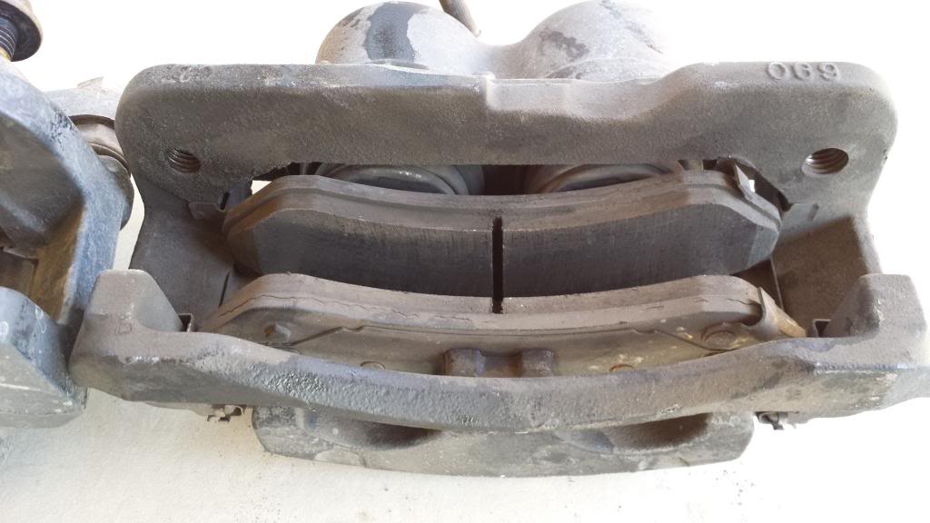

Hey guys... Guess what I did today....
Got the bigger brakes from a 2008 Tahoe 4x4! I wanted to go bigger, but 14" or 16" rotor kits are a bit pricey... My 2006 GMC Yukon does has the Hydro Boost.
The Rotors are only 1" bigger...
The calipers are beefier too...
Brake Pads are different too...
GMT800
GMT900
Now for a test drive... I was skeptical the 1" would make a significant difference... But I can hear the front tires crying for traction... The Yukon stops pretty good!!!
