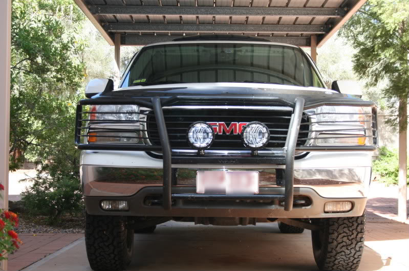

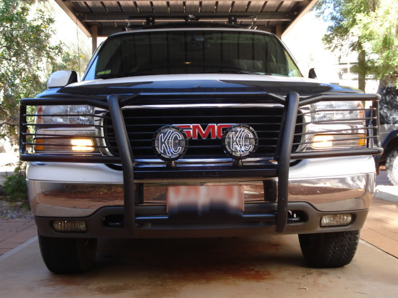

Oh , here this might help. First pic is the yukon, bone stock (uncranked t bars) with 265/75/16's. Second is with superlift keys, and bfg ta 285/75/16's the difference is pertty apparent and i feel this is perfect for what i need here in the outback, a big lift out here means a big tow bill when you roll it.
BEFORE:
AFTER:
