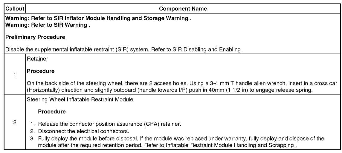

What is the best tool to use to remove the air bag. I've heard aline wrench I've also just heard something to poke the releases. FYI i have read the sticky didn't really help. Any help would be appreciated.

Which air bag? The procedure for the steering wheel airbag is:
