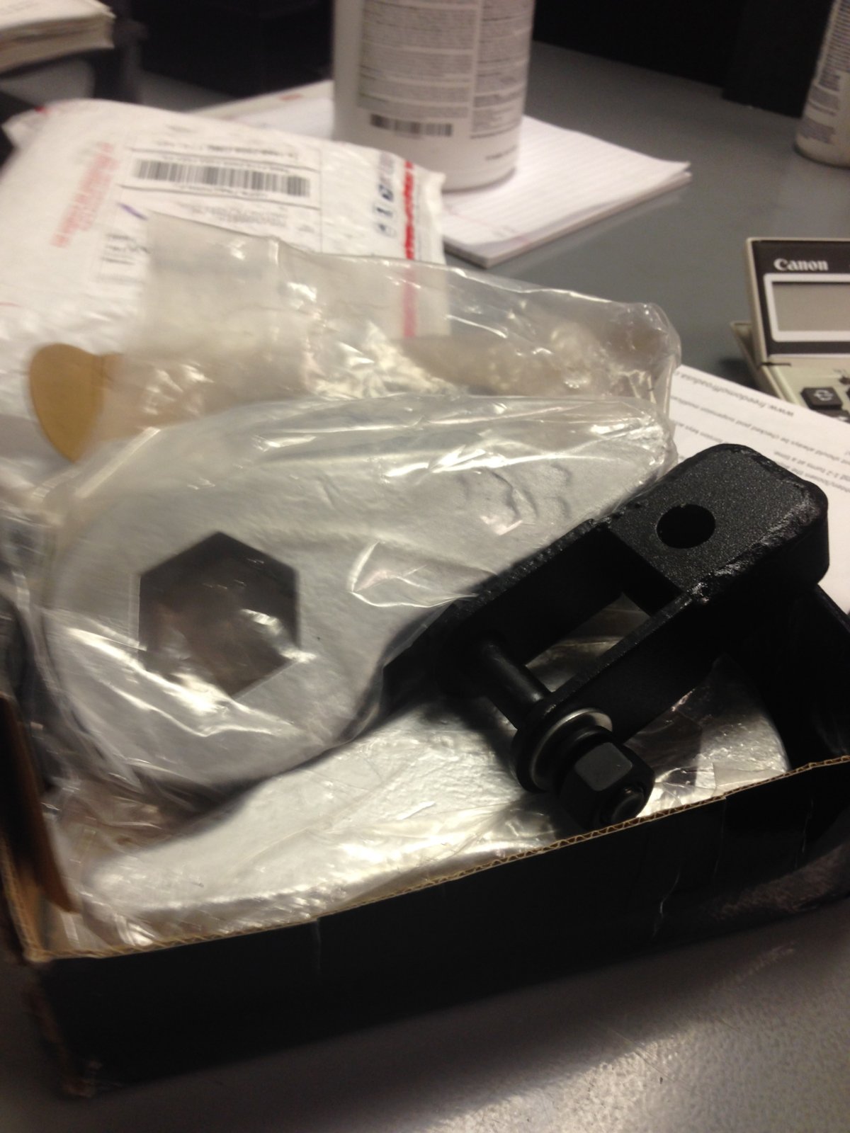

I went ahead & ordered a cheap eBay kit complete with shock extenders.
http://m.ebay.com/itm/271816730105?_mwBanner=1
I really just chose 1 that had the fastest shipping so that it will be here by Friday when I get paid; get some new front brakes, replace the torsion keys, maybe fix my wheels up and mount the bigger tires all in 1 go.
I will replace the back brakes and install a set of spring spacers (pending shock extender fitment) next week & proceed to roll hard.

The $45 eBay kit already arrived via standard 2-day shipping; the online tracker couldn't even keep up, it got here so fast! Nothing cheap about this gear, though.
It's no $250 maxiCam setup, but it should work. Man I wish I was wealthy. How nice would it be to have 1/4" adjustments (1"-3") built into your torsion bar keys?!

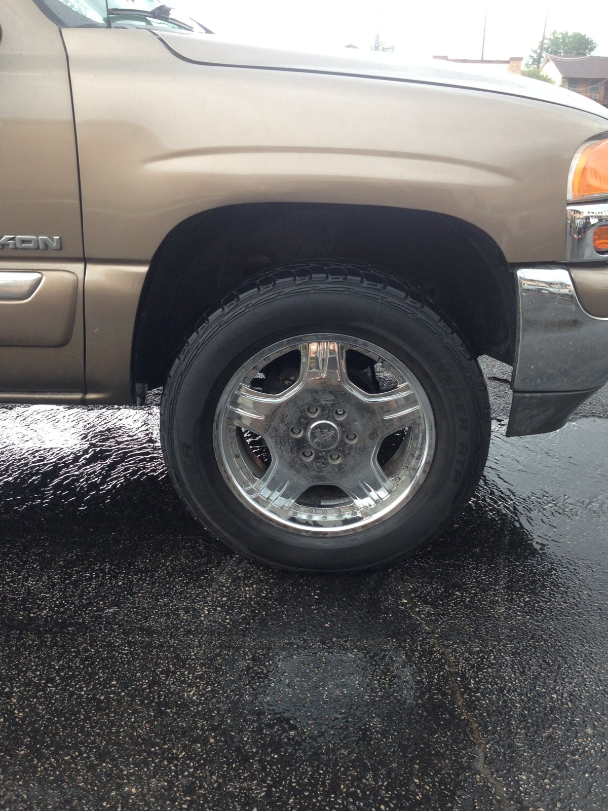

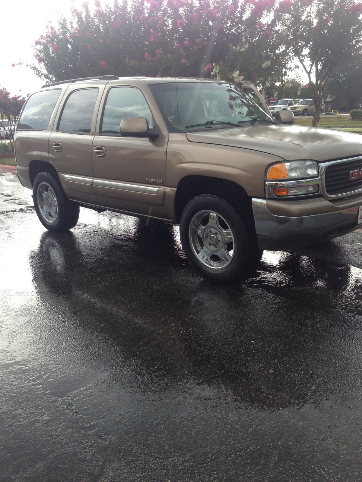

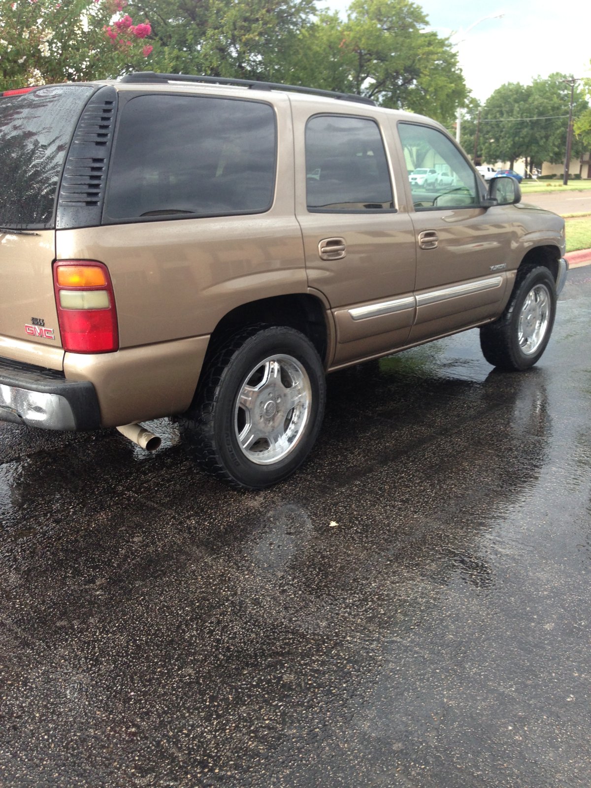

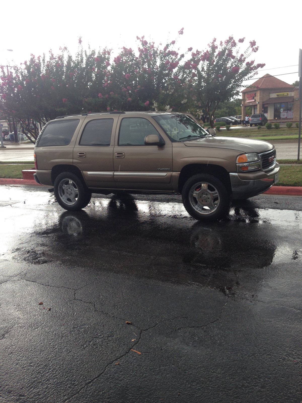

Replaced the torsion bar keys today. Want to have the new tires put on but it's so expensive, not including the alignment, I will have to call & shop around first. So far I know of a $30 difference in mount/balance & another $30 difference in alignment cost. I still want to raise the back of the truck 1" or more. I prefer a slight rake
