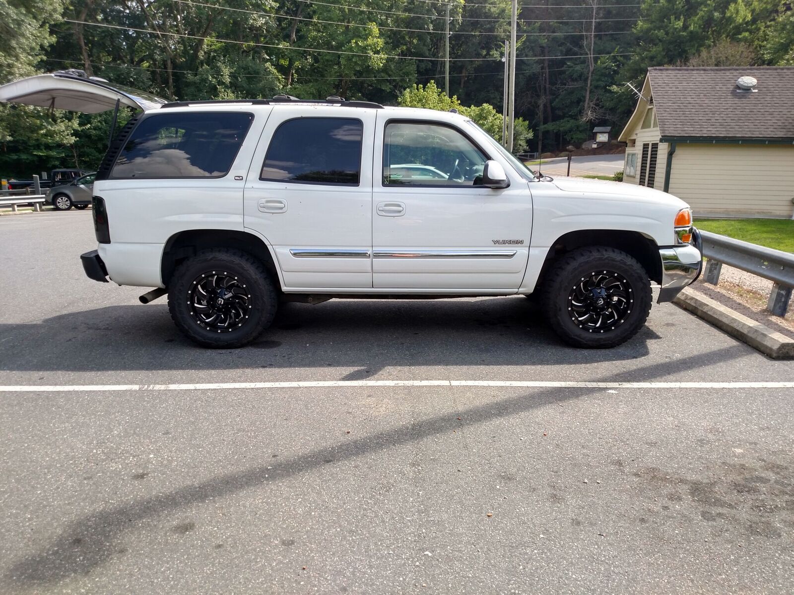

I have 100$ rough country keys and they are cranked level, no coil spacers. I told the shop to level my truck when in got wheels and thats what they put on. leveling keys will make your truck level and should add a little bit of height all around (mine is about 2 inches higher). you can get a full leveling kit with coil spacers and stuff (supreme suspensions has a good one) and it will add more lift than keys. some people on here have ebay keys and they say they work fine, and some people even have keys from older Ford trucks. Like i said, keys will bring up the front, a full leveling kit raises ride height more. I like the rough country keys, highly suggest them. they are a good price and i cant tell a ride difference from stock
What size tires do you have on your yukon? It looks sick!!

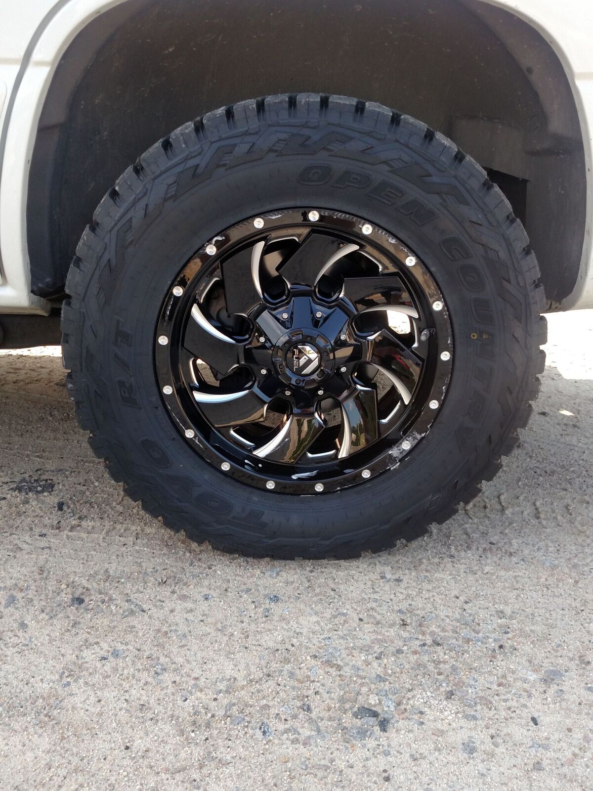

thanks alot. i have 33 inch tall and 285 wide with a 18 inch rim. I RARELY rub and the shop didnt have to trim. i think a 295 could maybe fit with some trimming
