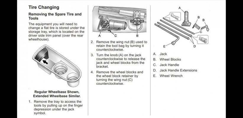

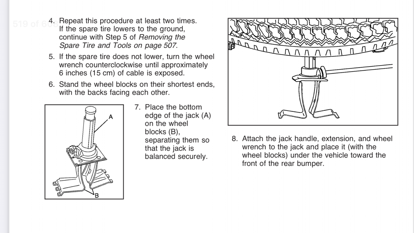

I'd drag around a dedicated floor-jack, but they eat up space, and instead have one of those bottle-jack/jack-stand combos. I think it came from The Homeless Despot. The last thing I want is a jack dropping on me on the side of the road, so the built-in jack-stand is a good thing.
Apr 11, 2018
7,124
14,375
St. Louis
I can't remember if it's our 2001 or 2012 that included 1 or 2 metal wheel chocks in where the jack mounts
EDIT: Yup, the 2012 came with chocks
a4edwin
Nov 14, 2011
949
239
ny
My 03 had the wheel chocks. They’re supposed to help release the spare if it’s locked in. My 07 didn’t come with anything not even a spare.
