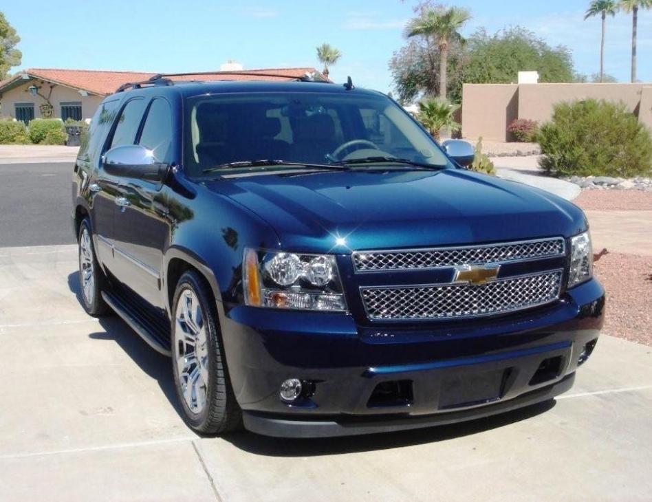

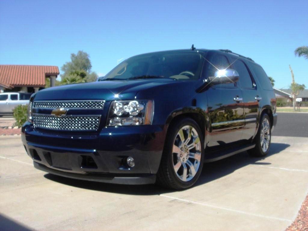

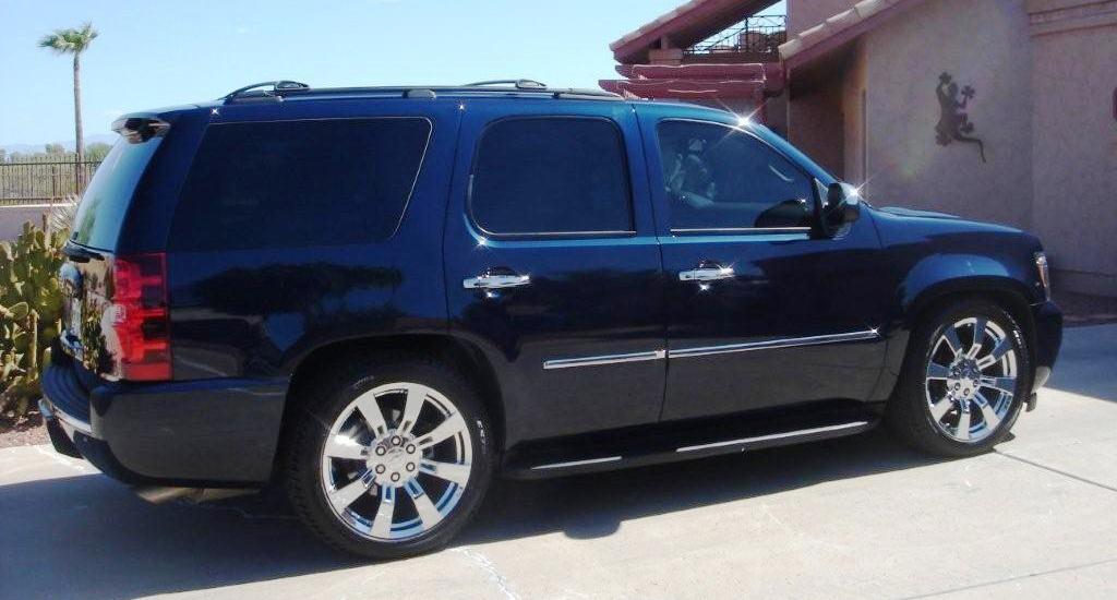

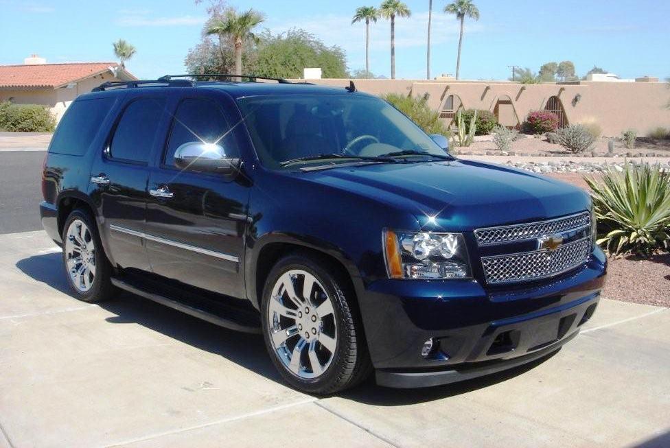

Here are the pics as promised. And I see even with the bushings, I'm still cambered in a little bit- getting the alignment tomorrow. But the wife is really happy with the new Hoe now that the Belltech 3/4 and Eibach sways are installed. Cheers!

That looks real good man, I keep throwing around the idea of getting a new 4" drop kit over my 3".
Yours will help the decision.
