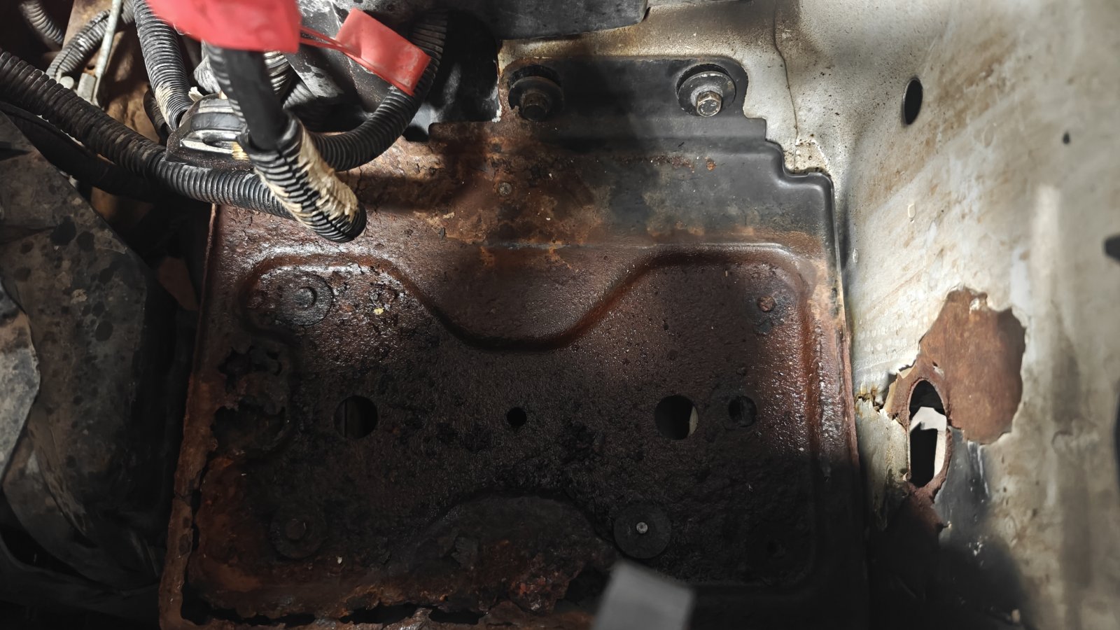

Tried to tackle this today. I'm gonna have to revisit this later. I have 2 bolts that the heads are rusted down enough that a socket won't grab and 1 that snapped. I do have a set of extractor sockets but not with me.
