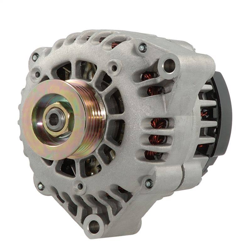

Hey all,
we were driving home last night 8hr drive. I noticed the headlights dimming. At first I thought it was my eyes messing with me after driving 7 hours. After about 20 minutes of the lights flickering from bright to do, the battery light intermittently came on with message "battery not charging". The voltage gauge looked around 12, but then went back up to 14.
What do you guys think, alternator? Loose connection, battery?
J
Jon Chimpo
Apr 20, 2017
152
186
I checked the connections after work. Everything is tight. Went to autozone for a test, yup, alternator going out.
So they don't sell any new Delco 145amp alternators, only reman. So i want Delco, but a new Duralast has a lifetime warranty, and is the same cost as Delco reman with 2 year warranty. What you guys think?

Well looks like if I want a new Delco, it's going to be a dealer only item. Called a dealer, it's $645+tax +65core.
Given this info, I'm thinking New, lifetime, Duralast altornator.

In the future I might do that on my BMW, that's more of a future collector car. My Tahoe will never become a collector.
Bought the Duralast with the lifetime warranty. Installed it in 30 min, done deal.
