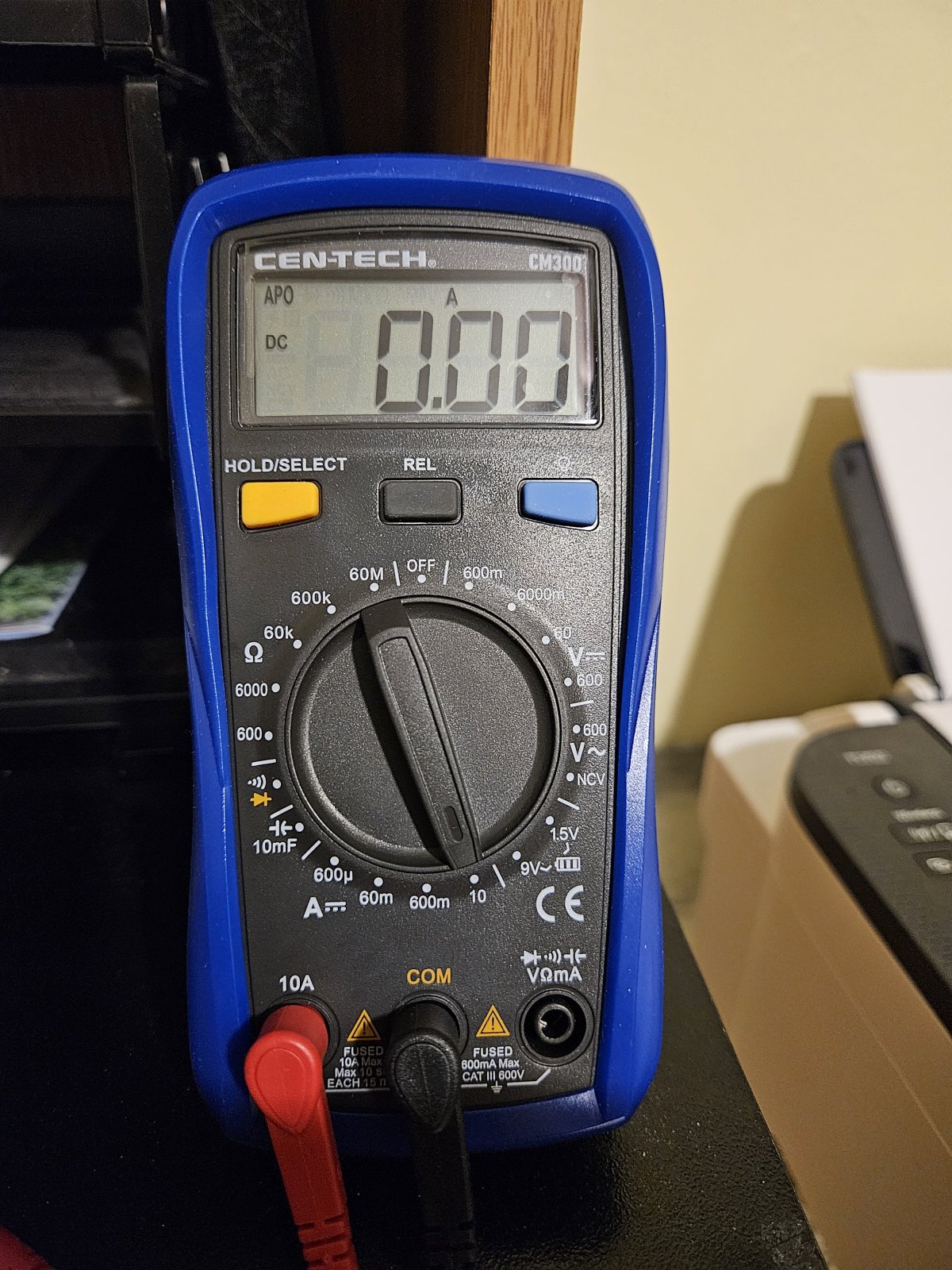

When I follow the video above, I get no reading at all, 000 between the negative terminal and the negative cable. It doesn't matter if I have the red cable on the left or right terminal. When I say cable, I'm talking about the leads to the multi tester, not the Tahoe battery. I even bought a new meter, a cheap one, but a new one. Pic attached.

you still have battery positive cable on?, this test only works with the positive battery cable attached the negative cable disconnected and meter connected between the battery negative post and battery negative cable.
Yes, the positive battery cable is hooked up to the battery.
