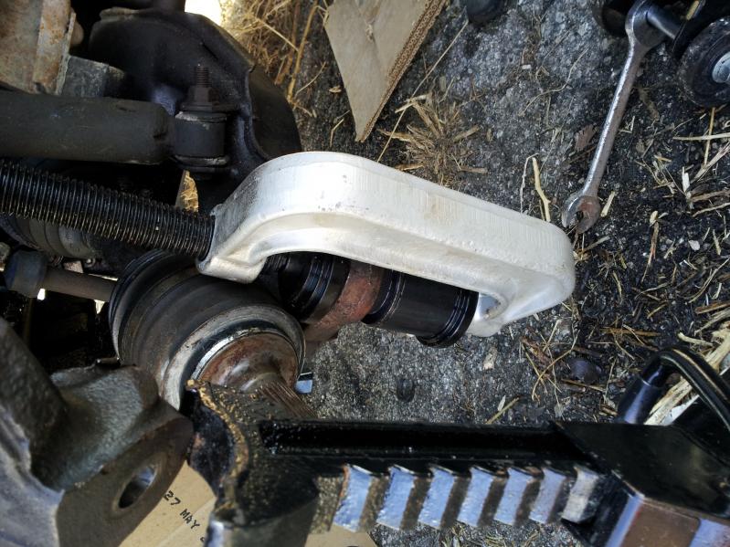

Now to get the new one to go in! It is not wanting to press in.... getting really tired of this job.
mattluttrell
Feb 4, 2014
203
11
Sometimes you can torch the hole and freeze the ball joint. You can also modify (grind) on the tool adapter if it isn't lining up.

You can buy it from Harbor Freight for $40 or so.
No. No no no! The Harbor Freight balljoint tool is crap. I own one, and the C-clamp bent up the first time I used it, while installing a ball joint on my Yukon. No impact gun was used, just a long ratchet. In other words, I bent up their sorry excuse for a clamp with my bare hands. The bending of the clamp caused the balljoint to be installed in at an angle.. it was ridiculous. If I had to use the HF tool, it would have taken me hours of re-positioning the tool to compensate for its weakness. But don't take my word for it... have a look at the pages and pages of reviews on harborfreight.com that detail the weakness of that C-clamp.
NAPA sells (and loans!) the Evercraft kit, which I had to switch to.. it's solid. OTC also makes a solid kit that a lot of people like, and generally, I've had good luck with OTC tools. Amazon has it for $107 shipped to my door.
