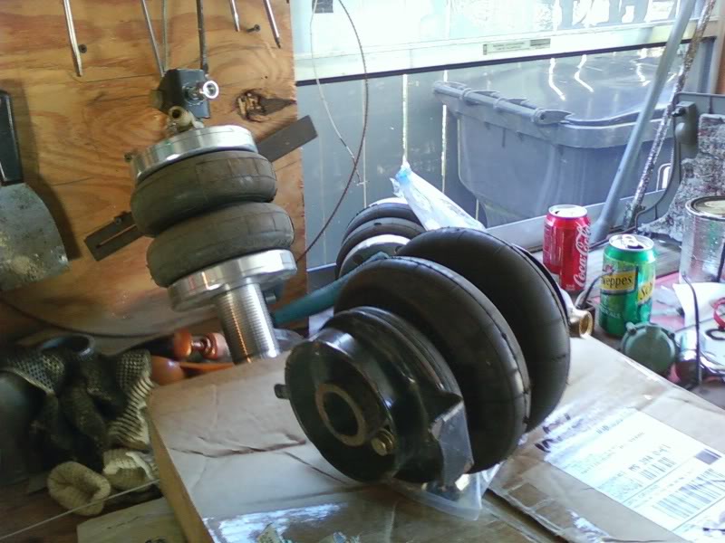

so i only got to bag the rear cus when i went to go do the front, the dump valve kept sticking open, but here are some pics and a video...
free travel mod..
FRONT BEING DONE AS SOON AS THE NEW VALVE COMES IN!

So are the bags in place of the springs? I don't see them..

yea i forgot to take a picture of when i put the bags in place of them

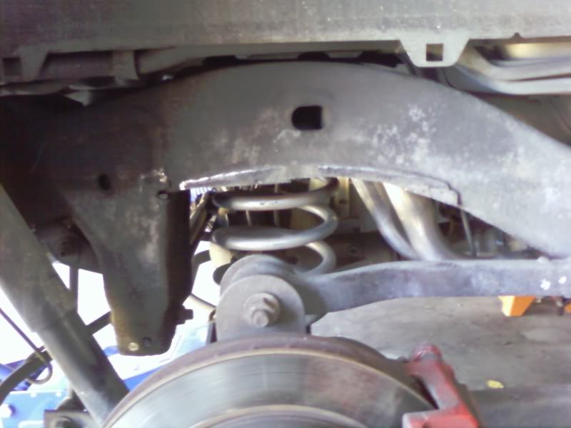

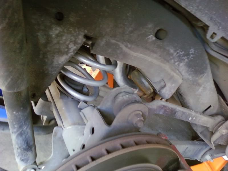

those pictures where u see the spring are just when i did the free travel mod before hand

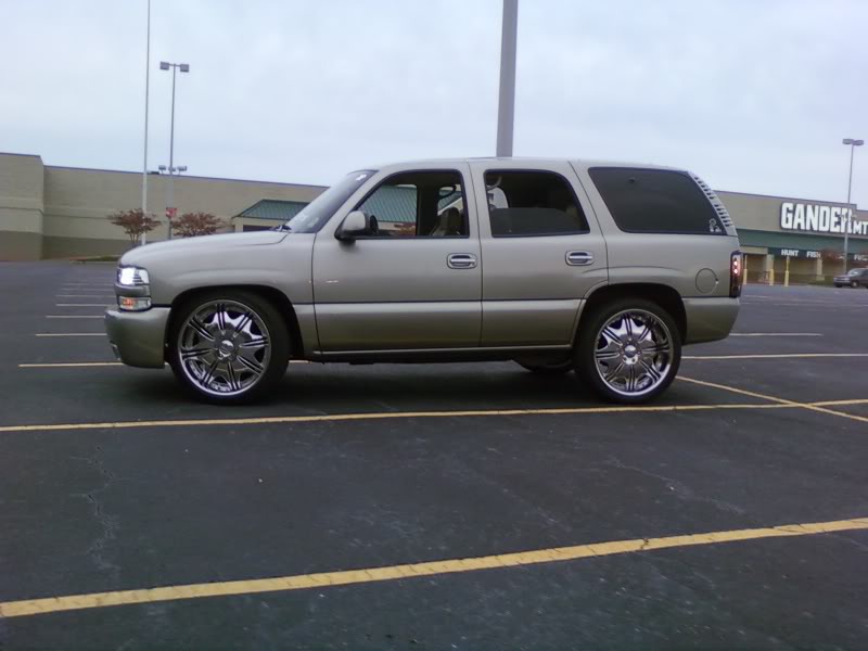

Looks like a damn good mod especially for when putting extra weight in the truck. What is it costing you so far? How's it ride?

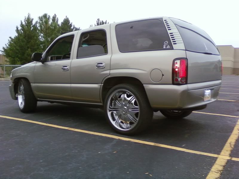

i rolled the passenger side but it didnt do any good the tire sticks out too far, but on the driver side it didnt need to be rolled, for some reason on all chevy's the axle isnt exactly even in the rear...its odd but ive always been wanting bags and ive slowly been accumulating all the parts, i started getting everything this past summer and finally got the rest of the kit in a few weeks ago
The angle of the panhard bar shifts the axle to one side when lowering, and towards the opposite side when lifting. An adjustable panhard bar will help center it a little better, but it will still shift while airing up and down.

rides pretty good, i dont have the sway bar on either and when i took it off and still had the springs on it rocked alot on the interstate and rolled more on turns, but now i have the bags on it doesnt rock or roll at all, it rides almost as if it was a factory cadillac deville, i will get a full idea of the ride when i finish the front..
