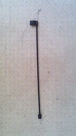

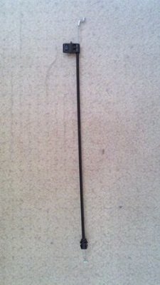

Following up on my outcome in case anyone else has the same problem down the road.
I have been confused by some of the comments on how to fix my issues and I have finally realized there are two latches and two cables on each seat. It sounds like most people are having issues with the latch that allows the bottom of the seat to lift. My issue was with the cable to unlatch the back of the seat so it can be folded down.
I fixed mine yesterday. I rocked forward the bottom section of the seat and removed the six bolts and removed the seat. The seat was the 60% seat. From there I could remove and replace the cable that goes under the leg of the seat to the latch. It was very easy to replace.
I got a new cable from my GMC deal for just over $50. It is part number is 12382372.
TThanks for everyone’s help.
Ron
