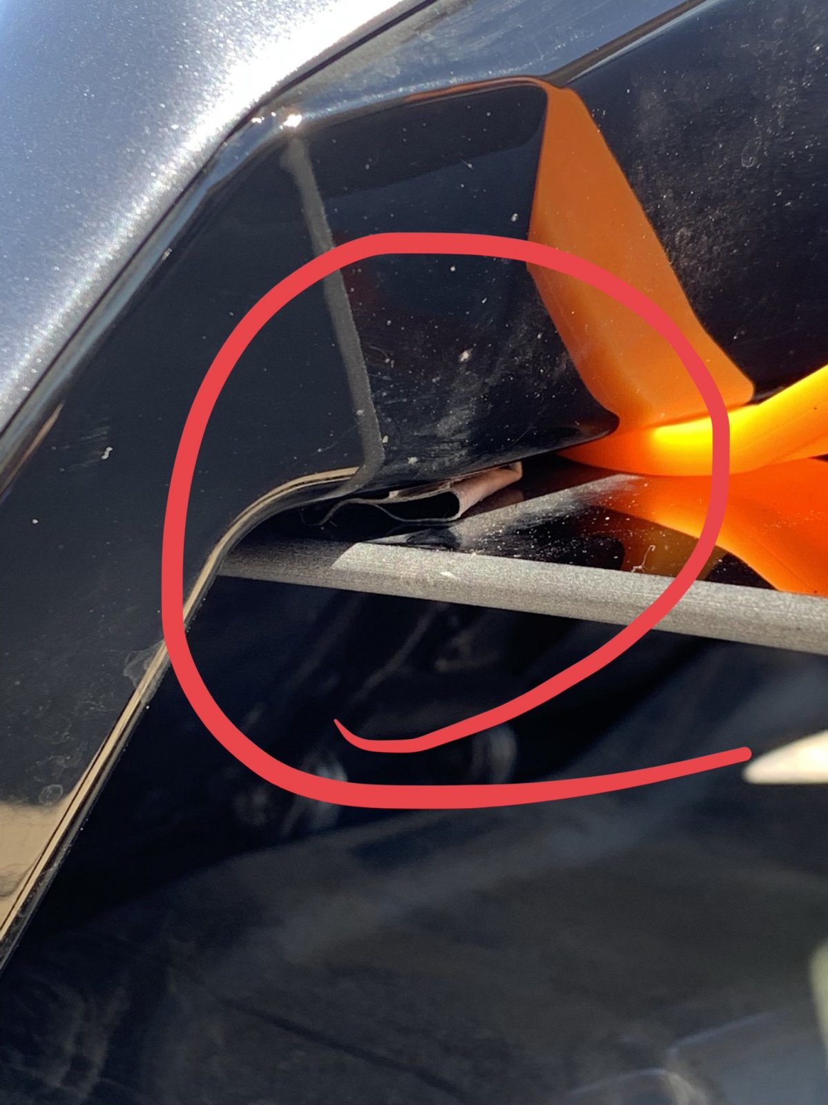

I did check that. I think I finally found the culprit, after adding felt tape all over the place. I think it was at the very top of the glass where it connects to the plastic "spoiler". The left side was solid, but I could play with the glass to make the very top right come slightly away from the spoiler. I added a couple small pieces of felt tape between the glass and spoiler, and that seems to have done the trick!

Unfortunately, I spoke too soon. It was similar to what DCmaynor did. Mine wasn't that extreme.
My issue seems to be really hit or miss. This weekend it was rattling like crazy, and then today it wasn't making any noise.

Mine is kind of similar to this. Sometimes I swear it is the glass, but at other times it sounds like it may be near the passenger door. I know there was a TSB about some metal tubing in the rear passenger wheel well. I took out the liner and added felt tape in a few spots where the the tubing was touching, but it didn't solve anything.
My next plan is to take off all of the plastic on the rear hatch and see if it has anything to do with some wires hitting the metal (kind of at a loss at what could be causing it at this point). I have added felt tape pretty much all of the way around the window. I know there is a gap (can move slightly) on the pegs that keep it connect. I'm thinking that this probably isn't it, due to the fact that it shouldn't move much when the window is closed due to the latch and the rubber likely holding it in place.
I am not looking forward to taking off the plastic on the interior on the rear passenger side, but that may be the next move if it isn't fixed when looking at the hatch. This is probably the most annoying thing in any car I have ever driven.

A little better, but not completely fixed. More padding and driving today.
Did the additional padding help? If so, I may loosen the window in an effort to stick padding/felt tape all around the window.
