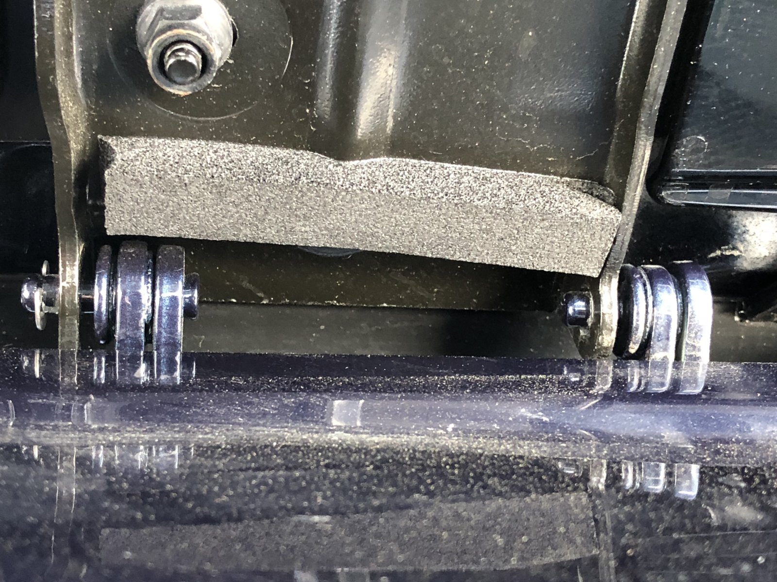

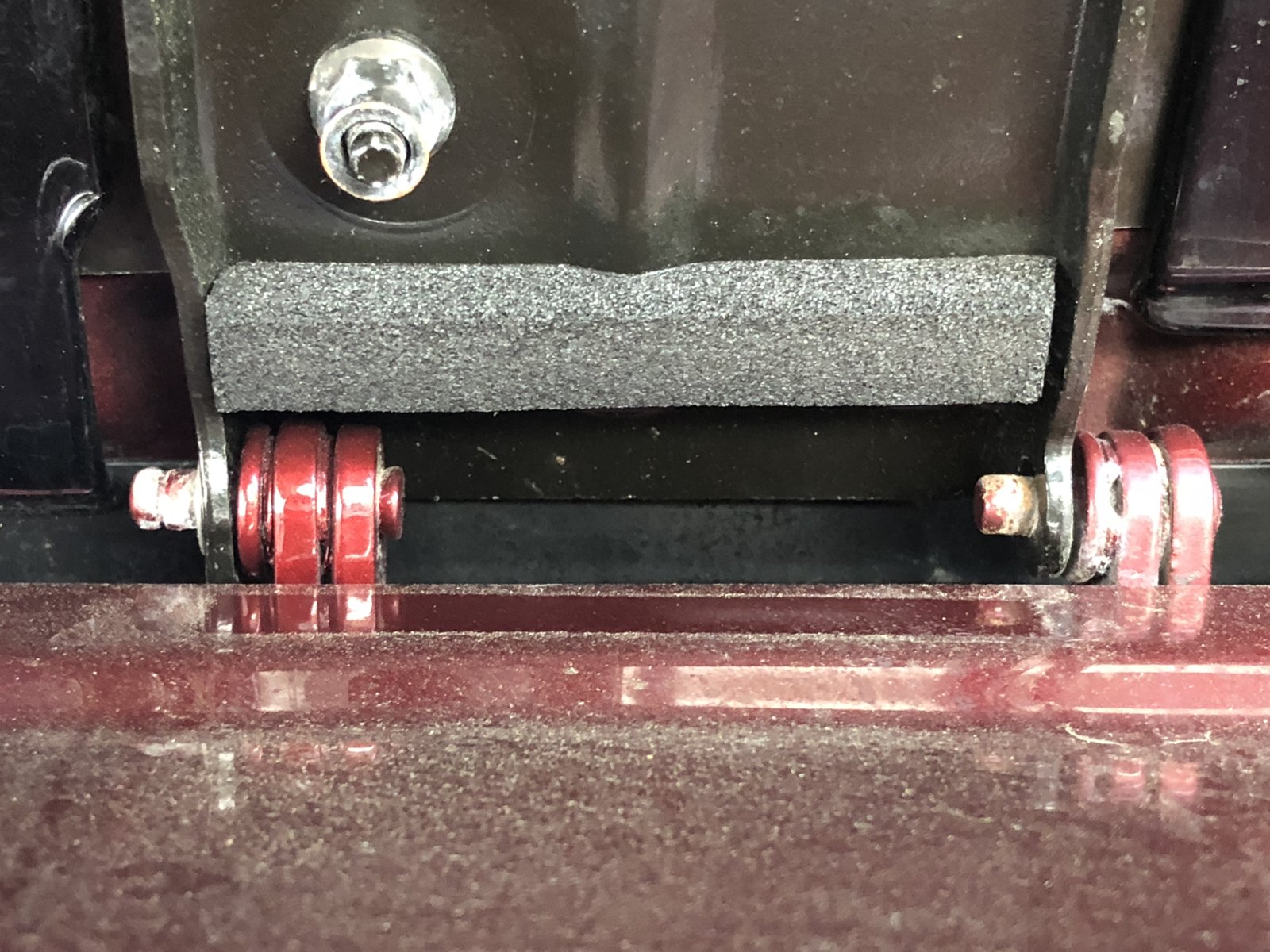

Went to the dealer today. They tried to say that there was a piece of molding that came loose. The tech drove the car and heard the noise but after the “repair” he did not hear it again.
Then I went to check. I shook the left side of the glass to show it wasn’t fixed.
Some pics
Blueinterceptor
Jan 20, 2016
1,161
686
The third pic is of the new trucks hinge. The blue one.
The first two or red ones are from my other tahoe that’s fine.
While I was there the service mgr and I checked a 2018 Tahoe that was also fine.
Tomorrow they will change the rear glass and hinge. Personally I think a rubber washer or o ring in that extra space you see between the hinge pieces will solve the problem.
Note that the pin on the left has a grove cut into it for the c clip to the far left. The other clips, have the c clips almost touching the hinge

They did change the glass and frame. Unfortunately the new glass has a scratch and they have to do it again. The new glass still shakes a little. I wondering if the pin is a different size.
Still waiting for the third glass
