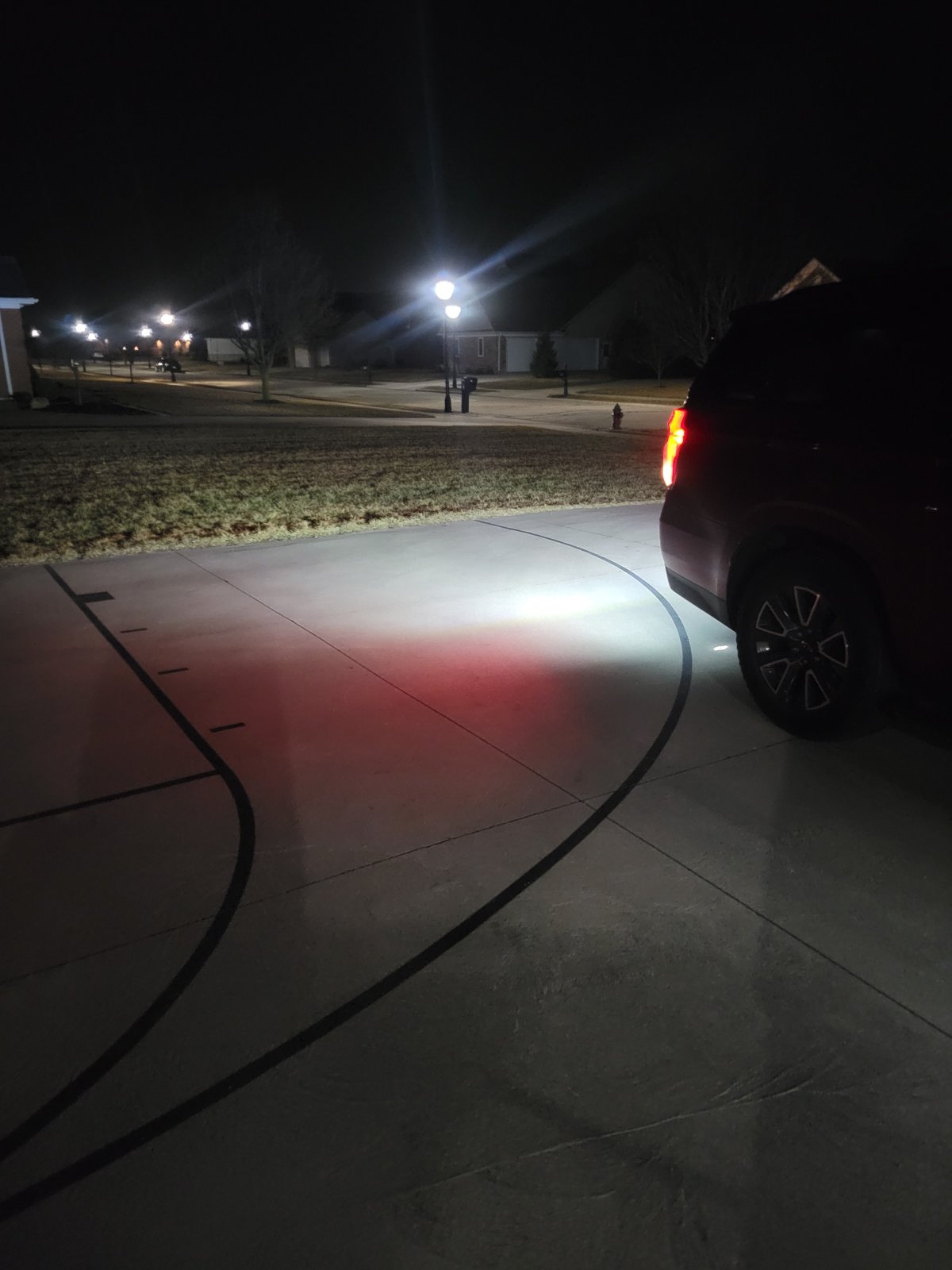

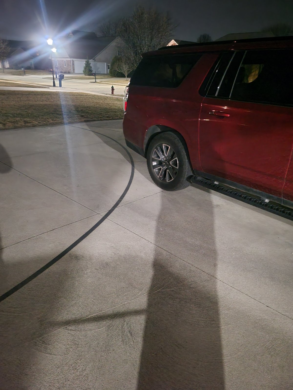

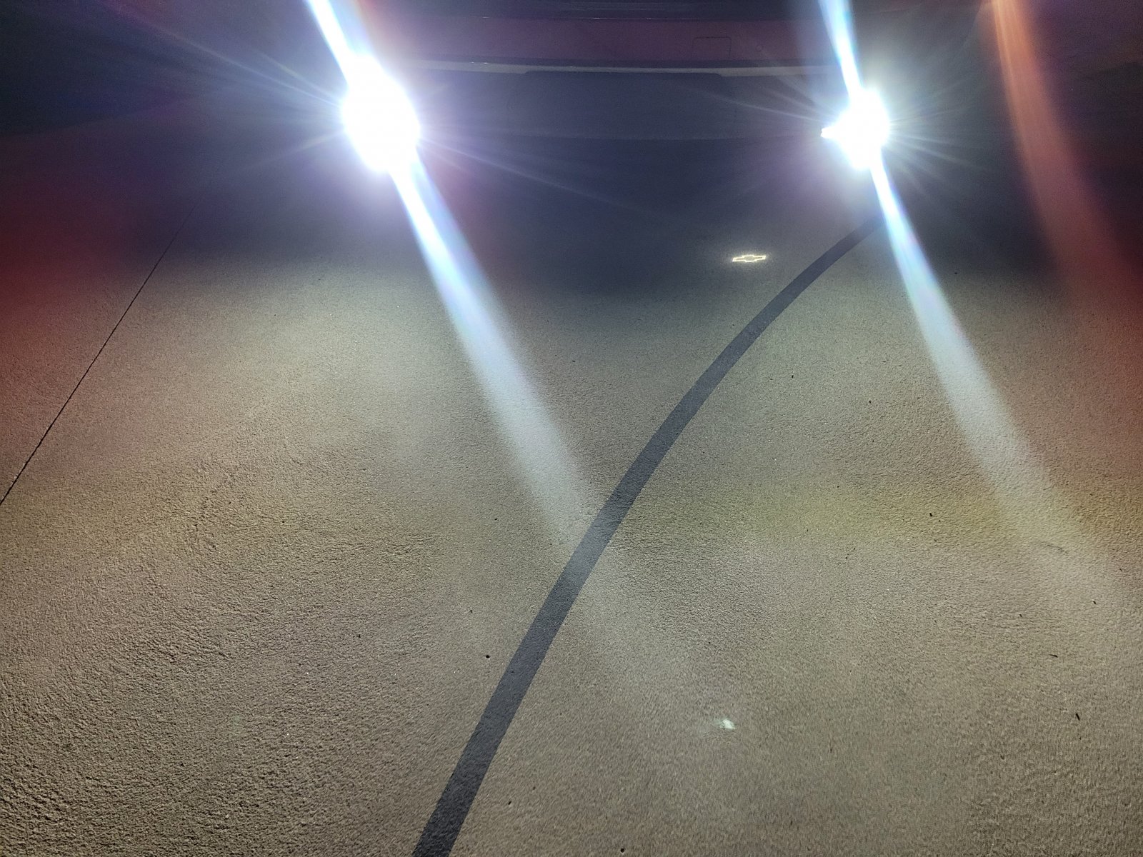

I agree the reverse lights are terrible
I added 2 slim 6 inch light bar to the under side of my bumper and used the factory reverse lights to switch the relay to turn them on I didn't want to add switches inside the cab

Here are some pictures

2 Questions: What year vehicle and what brand/model? Thanks for replying.

I read that LEDs throw a code on 22-24 Tahoes and Subs, any issues?
If you use a relay, you won’t need to worry about codes.
