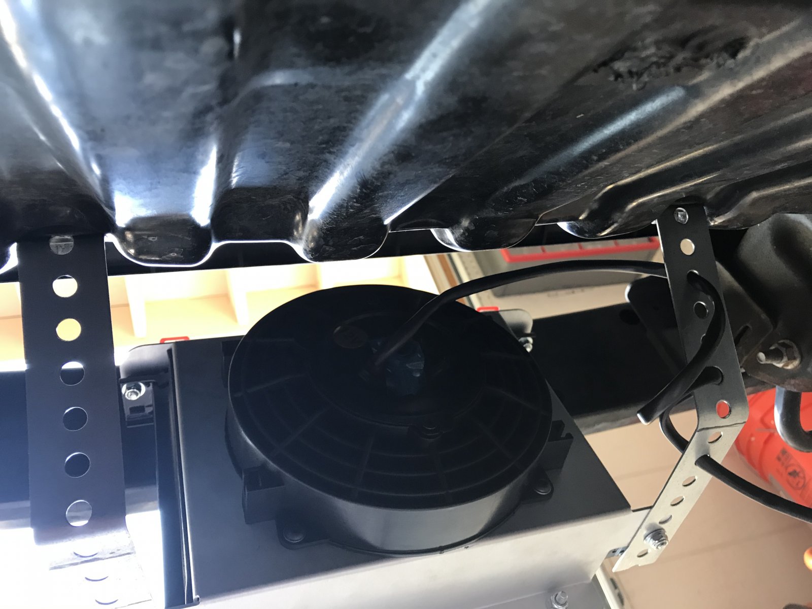

I chose the DERALE 13960 stacked plate design with a 500 cfm fan that draws 4.8 amps. I havent started the install yet but will be using the area behind the front facia under the bumper. the lower "fake" air inlet will be modified to allow air to enter. Big plans but havent acted upon them, plenty of room with the only challenge being the plumbing and my "perfectionist" attitude. We took the TT on a camping trip last week and on a 11 mile 6 degree grade the trans hit 238f. Way to hot! The outside temp was 103, welcome to my desert world. I did notice that it attempted to hold at 204f for allmost 5 miles but as the coolant temp rose to the middle between normal to hot the trans temp ran away. Had the hill been longer i would have had to pull over. I have commented before in regard to trans temp affecting coolant temp and vice versa. Ill try to get on this trans cooler install as im sure that removing the cooler from in front of the ac condenser/radiator and going from the factory 10 plate to the DERALE 25 plate will have me where i want to be. $236 shipped was the cost. I will do pic's on install with my daughters tutorial on how simple it is to take the pic, import the pic, attach the pic, yikes!

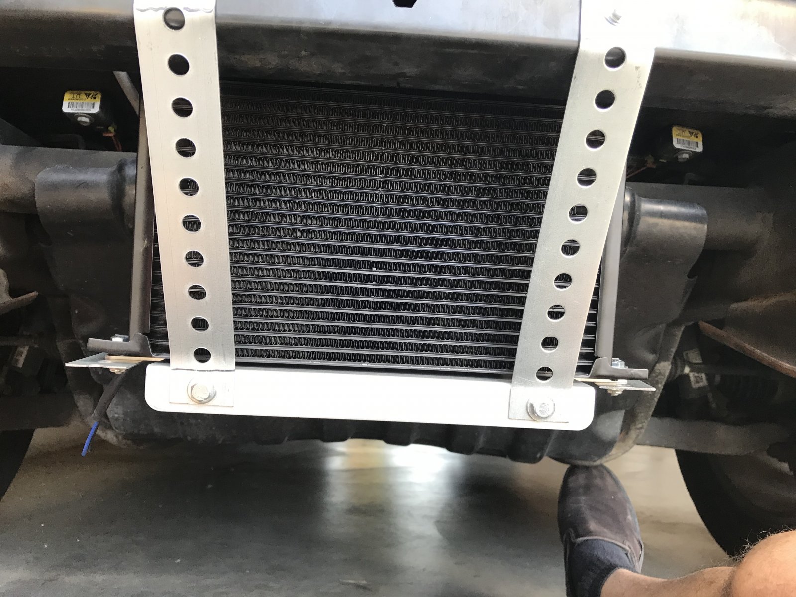

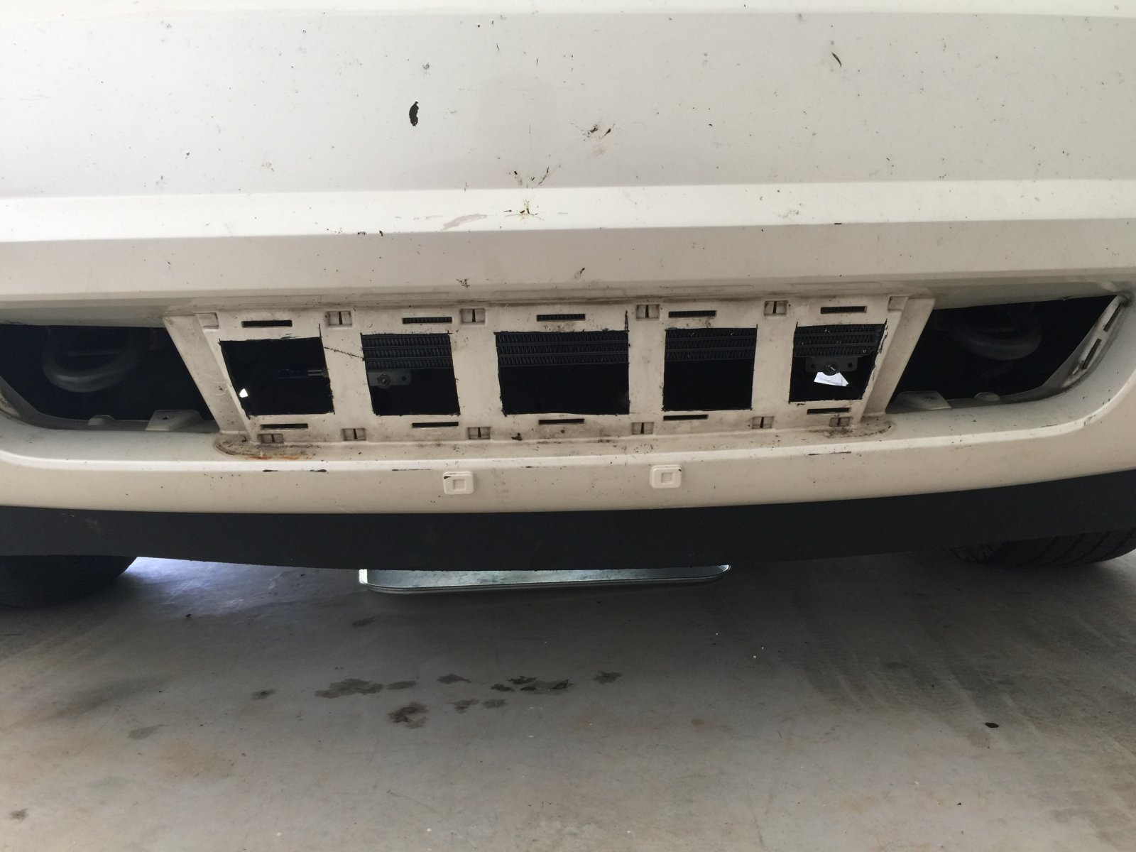

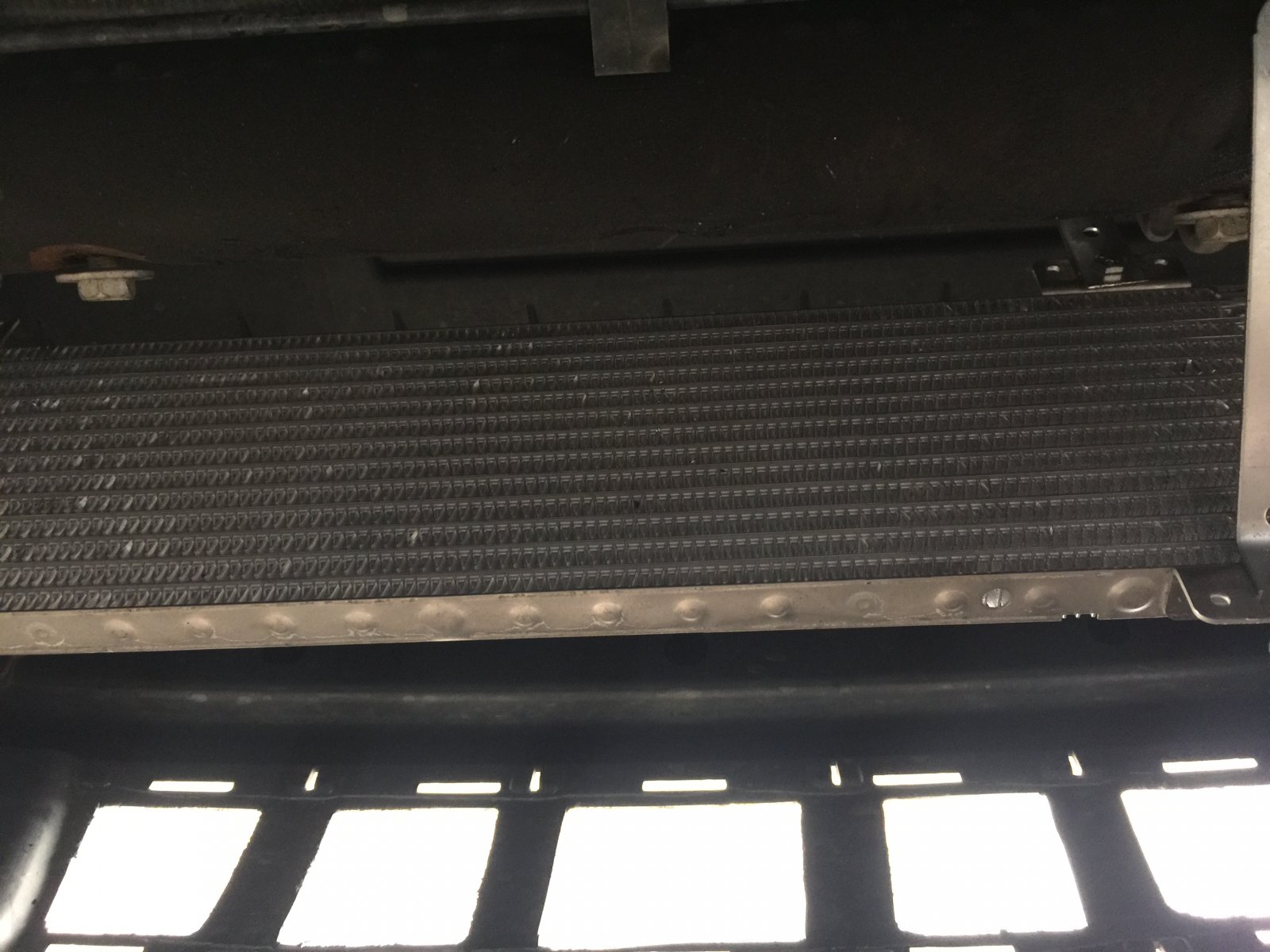

Well we are on parallel paths my friend! I have another thread on the same subject so I won't bore with the details found there: "Transmission Stumble". I am installing a Tru-Cool 30k auxiliary cooler inline with factory unit, behind the lower fascia. It will be passive though; no fans. Here are some pics below. The one question I have for the audience is,
Which factory line is 'send', and which is 'return'?

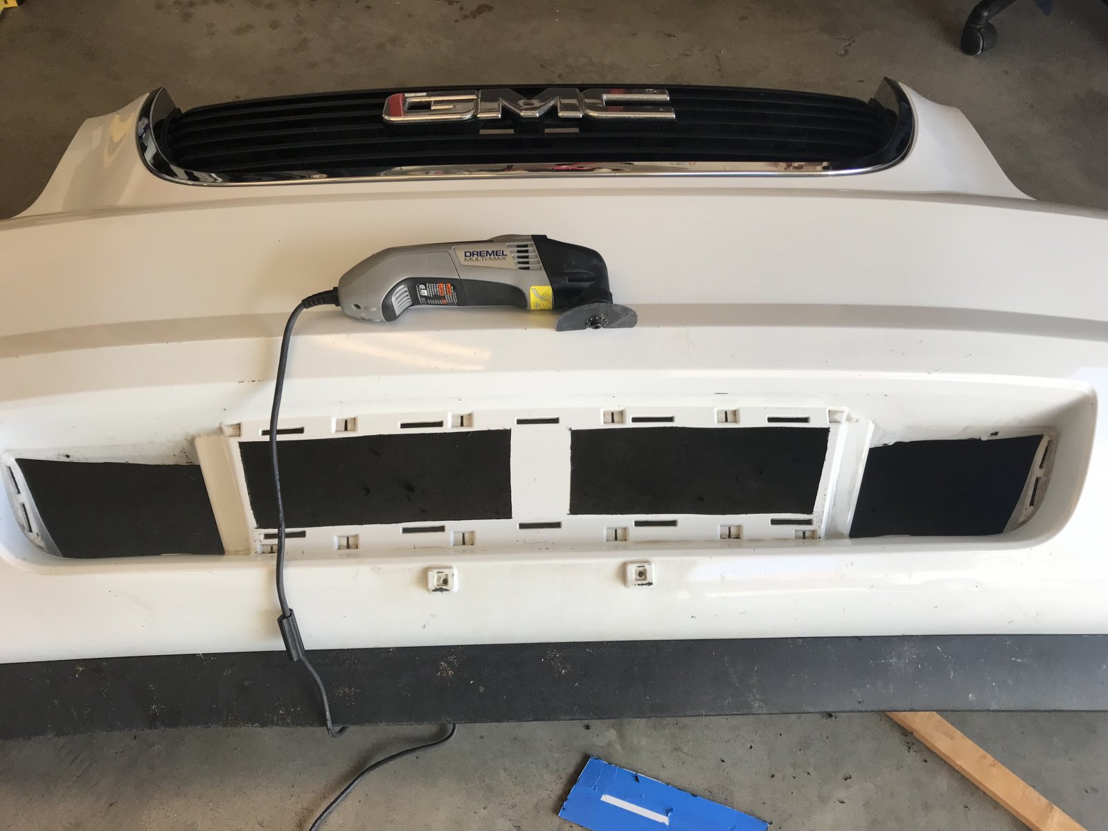

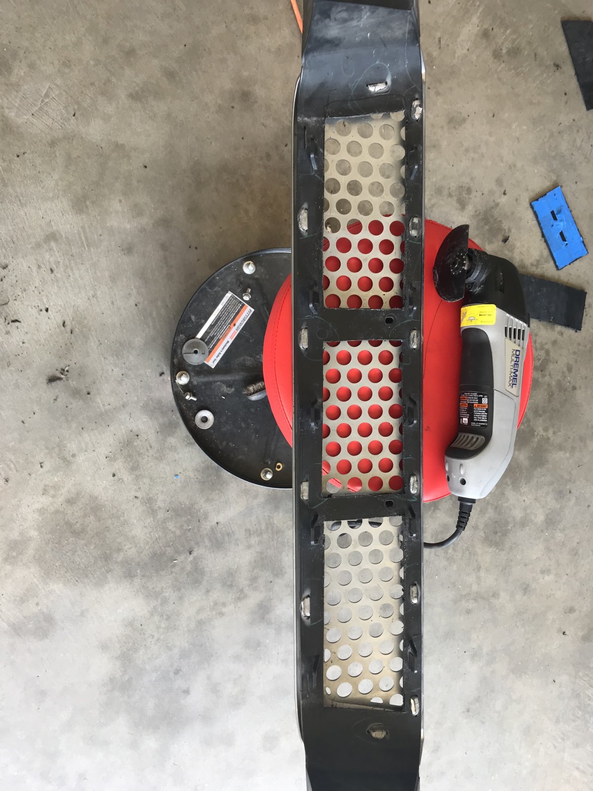

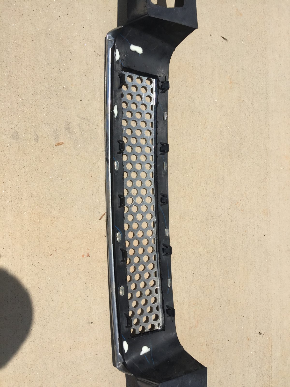

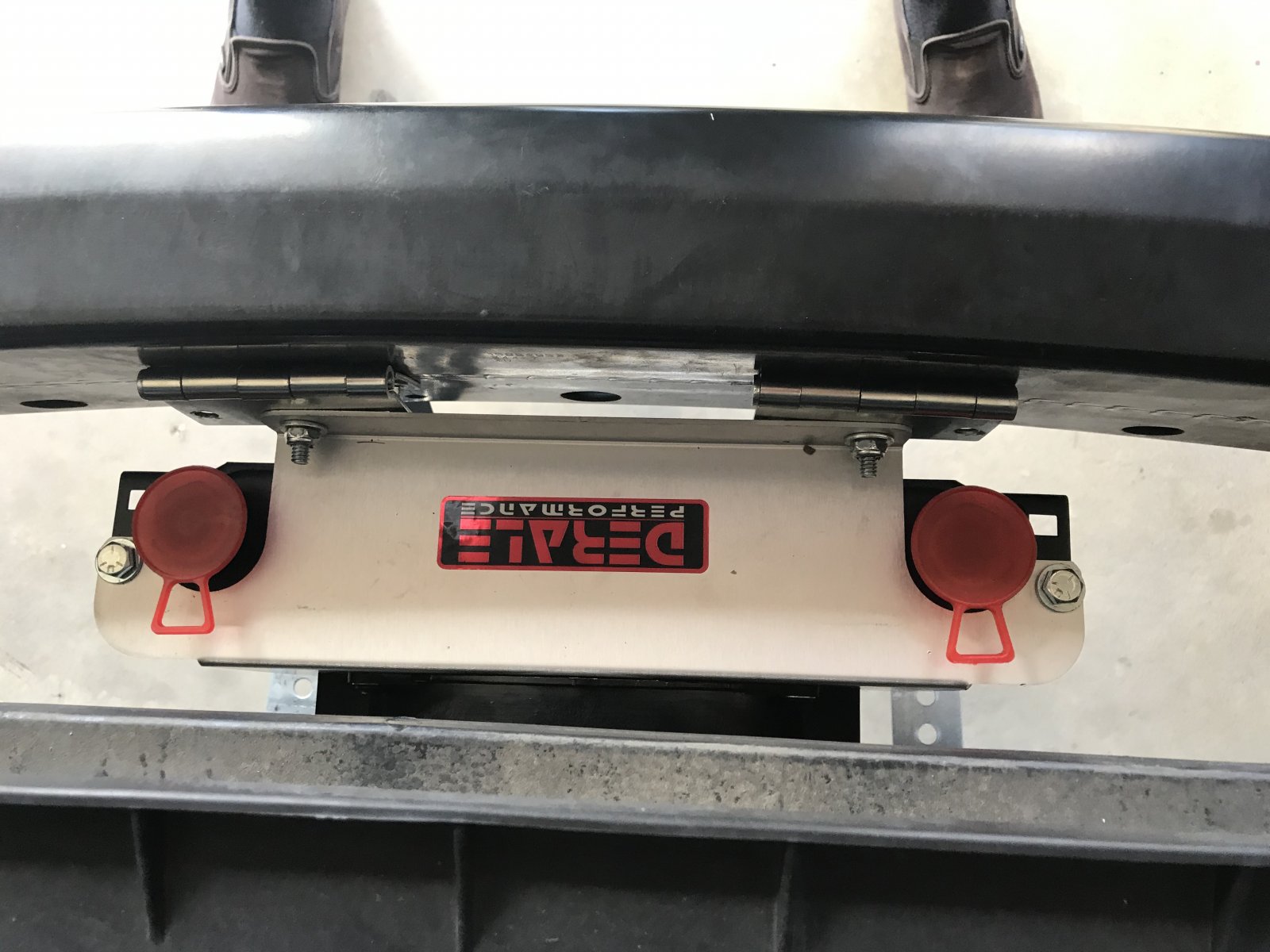

Now this is beyond coincidence? I just did the cut out today of the lower fascia identical to yours! the derale 13960 is mounted/wired but im waiting til tomorrow for two AN6 90's to finish the plumbing. I took photos of the install and will post soon. The install is solid but alot of work, in hindsight the trukool 40k would have been so much easier but we live in the desert and im concerned with excessive heat in front of the evaporator. The fan on the cooler isnt super strong, this thing better work as advertised!
Just finished the plumbing, No leaks and functioning. Im not sure if ill keep the radiator in the circuit as it is currently installed. The thermostat on the DERALE is set at 180f and i have yet to hit that temp with normal driving, It averages 145 to 165f and im second guessing that i should plumb for stand alone and truly reduce the temps? We will head to mammoth next week again to the bike park so the 8 mile 6% grade at 100f+ will be the tell all. The engine coolant has a dramatic/fast reaction on the trans fluid and i would like to see the temps without the engine coolant influence.

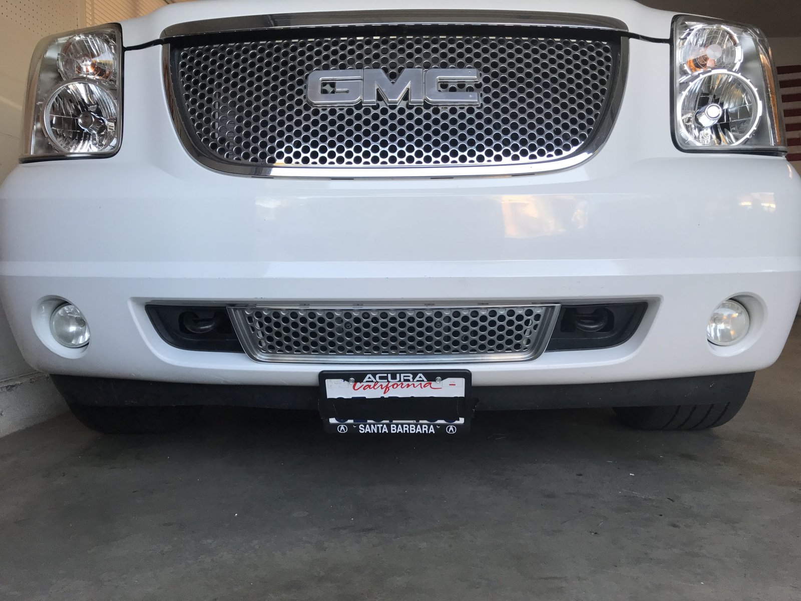

When doing that lower grill cutout, can you still mount a license plate?

Yup, I left the plastic bosses intact. I will extend the plate out maybe an inch to allow more airflow. The aux fan is designed to not need ram air at all so you can mount anywhere there is space and unrestricted air. I may mount the license plate using the two lower mount holes and have the full ram air effect at speed and possibly stay below the 180 f fan on/off thermostat switch. In this position the plate is level with the lower air dam/trim piece.
View attachment 251973 View attachment 251974 View attachment 251975
Top line out of the radiator is return to trans.

Yeah, this is uncanny timing. And good to see much of the same thinking on cooler/cooling mods. I had intended a TC 40k cooler, but the 30k barely fit between the chassis beams, so I'm glad I got what I got.
I don't need a front tag in SC, so if more cooling is needed, I'll probably put a scoop in or just under the spoiler to direct air up to the cooler.
"flows from the tranny, to the radiator, to the factory cooler, back to the tranny."
"Top line out of the radiator is return to trans."
...Do we know which one of these is correct?
I cut the line from the top of the radiator, and installed the cooler in line. I intended it to be the first thing the fluid hit, before the radiator and factory cooler. I can change it if needed, but I don't like cutting and coupling lines....
So, results. I took it out for a couple of test spins, and then to Church yesterday; 1/2hr. each way. Temp was ~85F, and the tranny temp got to 145F. Not exactly the result I hoped for, but at least it doesn't leak, and is ~25F cooler than before. I'm going to get it serviced (fluid/filter), and then go camping for the real test.
