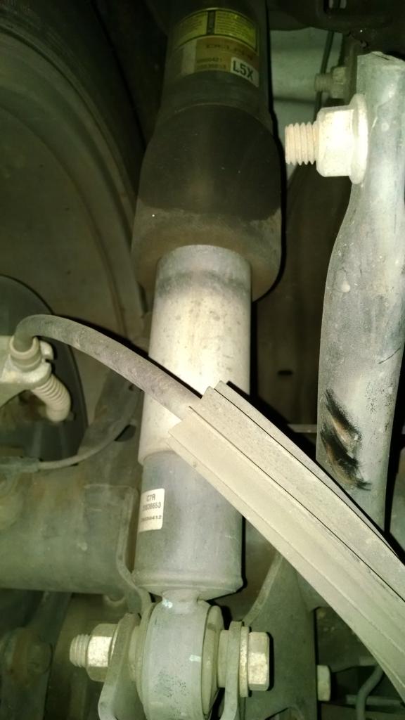

Are the ride height sensors in either of these photos because I do not see any jam nuts?

Negative. They are small rods attached to top of your upper control arm. One threaded end attached to bracket welded in middle of upper control arm and other threaded end attaches to rotational height sensor attached to frame. These can be seen just in front of each rear tire from next to back of vehicle. No need to get underneath to see

I did locate them. I am still confused on how to adjust them. They do not appear have ever been adjusted prior (they do not appear cleaner than the rest of the car, no tool marks, etc).
