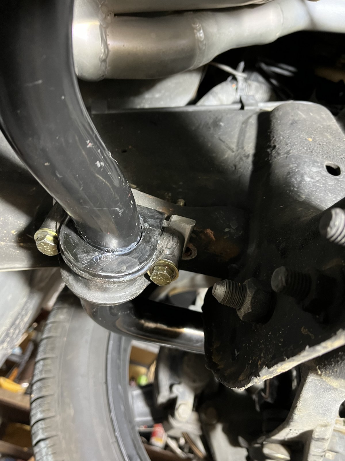

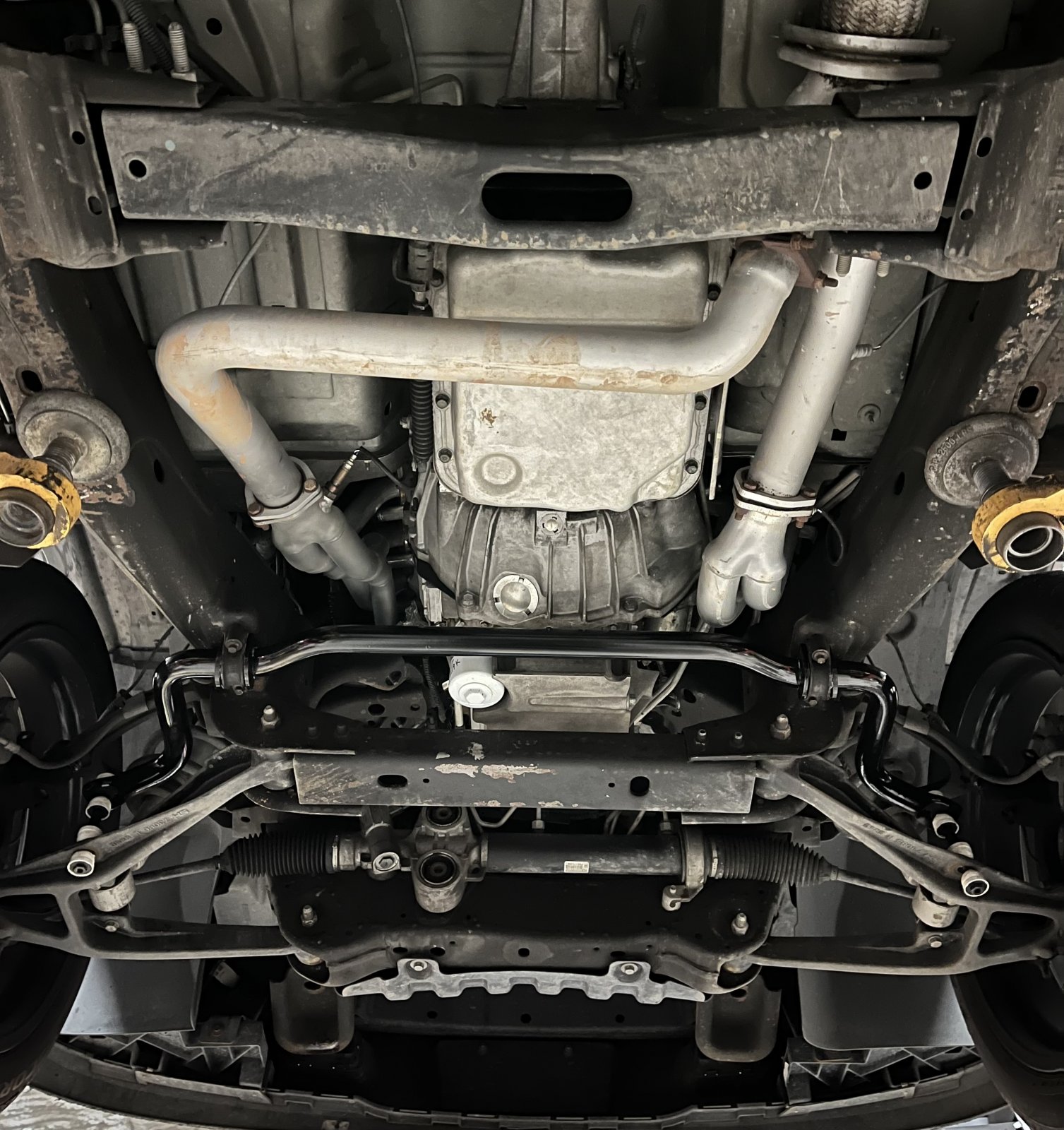

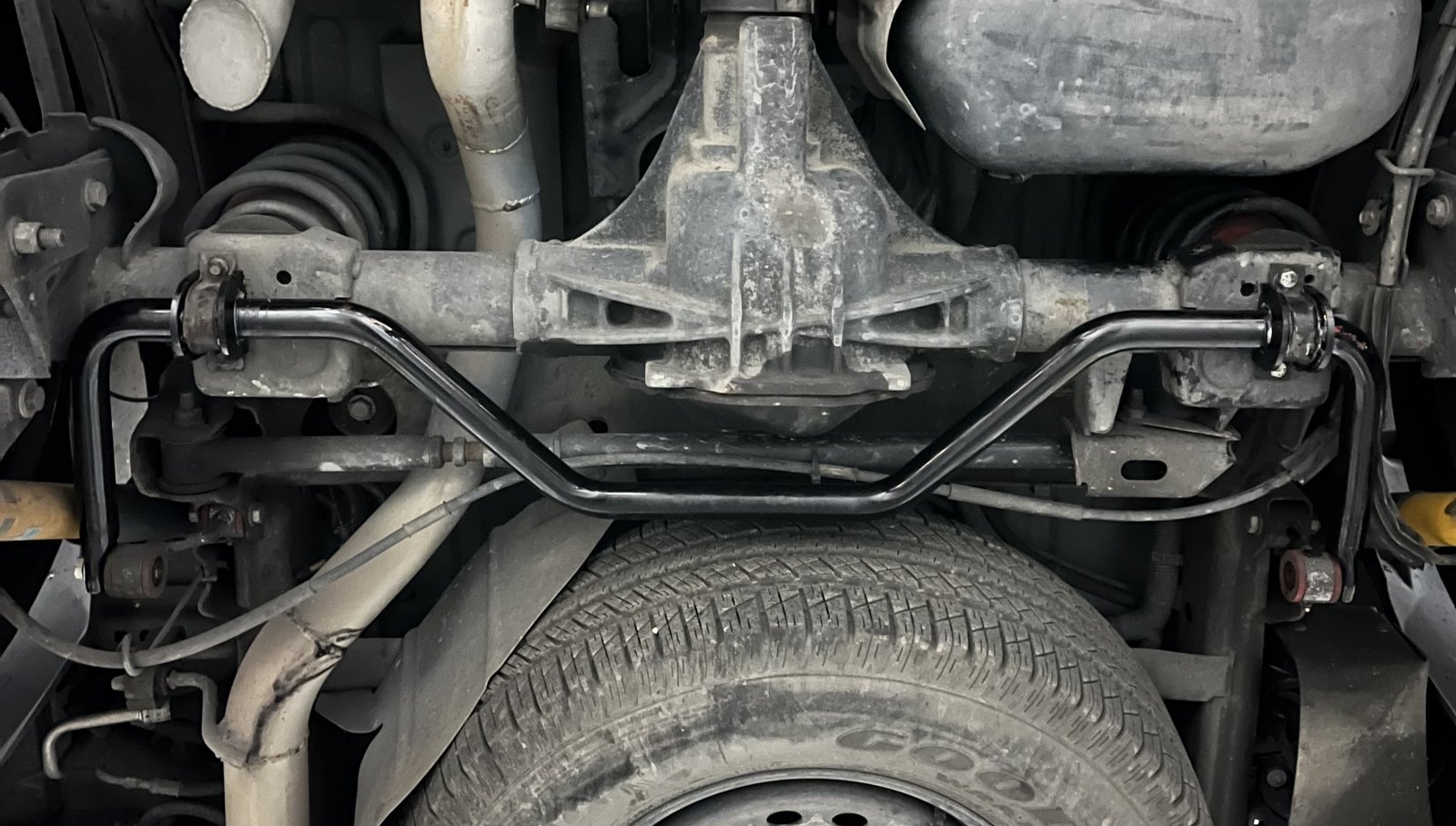

I don't autoX mine, but I like it to handle well enough that I could if even for simple fun on the streets or control during an emergency maneuver. A sizable drop using sport-tuned struts and shocks, big solid sway bars front and rear (all poly bushed) and decent tires have transformed my lumbering beast. It's still plenty comfortable on the highway. I would LOVE a manual trans. It's more doable than a 6L80E swap (mines a 4L60E).
You have Belltech spindles?
I have Nolathane bars:
Had to modify the panhard mount for sway bar clearance:
Relocated the front frame mounts and made really short end links:
MASSIVE BARS... I DIG IT FOR SURE!!!!

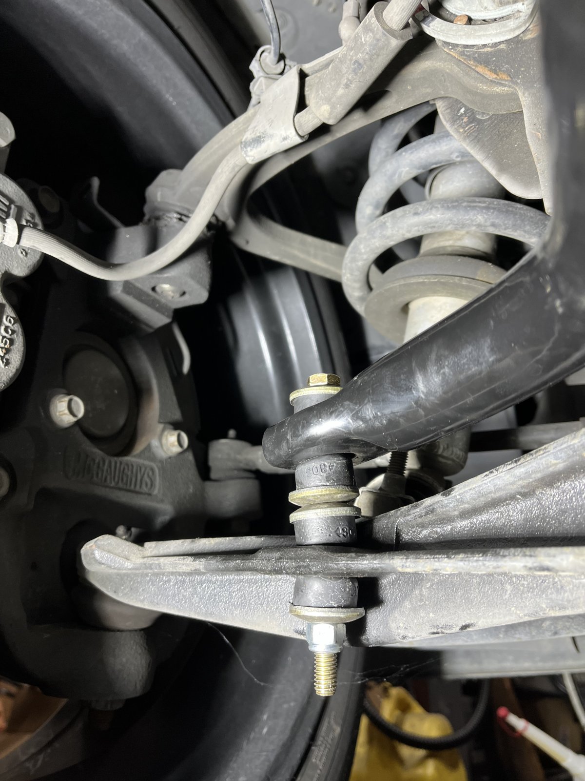

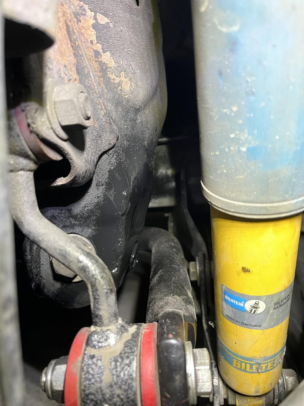

Your links are as short as mine. By any chance did you notice any sounds coming from down there when ever you turn? After my swaybar install I noticed this when ever I turn going in and out of my driveway or turning in a parking lot.
I haven't noticed any sounds. I also don't recall any instances where I've had it turned a lot while hitting a bump/dip/incline/etc. Most driveways and lot entrances here are mostly flat with the road.
I've had mine exercised pretty hard around some winding roads and never heard anything.
Oh- My sway bar has been relocated back a little for better alignment of the links. Maybe yours are at an angle?
Here's my relocation: https://www.tahoeyukonforum.com/threads/growing-up-doesnt-have-to-suck.93510/post-1747041
And the final/current rendition: https://www.tahoeyukonforum.com/threads/growing-up-doesnt-have-to-suck.93510/post-1748423

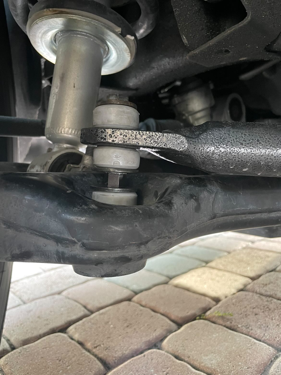

Here's how they're sitting. There's a slight angle but I don't see any contact points..
45,014
I'm wondering if you have slack elsewhere and the reduced movement from the firmer bar is making that slack move differently than it did when there was more side-to-side flex. It might not be actual contact between components (bar to control arm, etc.), but something like slack in the control arm bushings abruptly being forced to articulate slightly differently than how they've been worn in.
What if you roll about 5 MPH and stomp the brake, in forward and/or reverse? Try this with the wheels straight and with them turned in each direction.
It's crossed my mind recently.
I'll try this tmrw.
