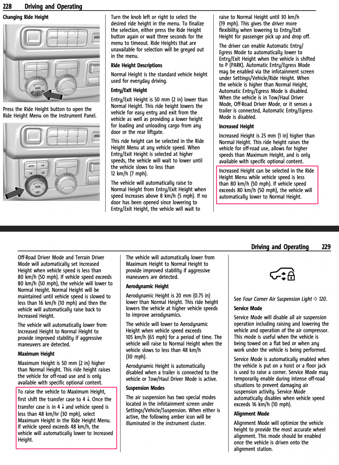

i understand the At4 with air ride system can raise up to 2in for addl ground clearance. Is this a only available while in 4wd or can you run with 1” or 2” in 2wd or for everyday driving?

Owner's manual is your friend...
