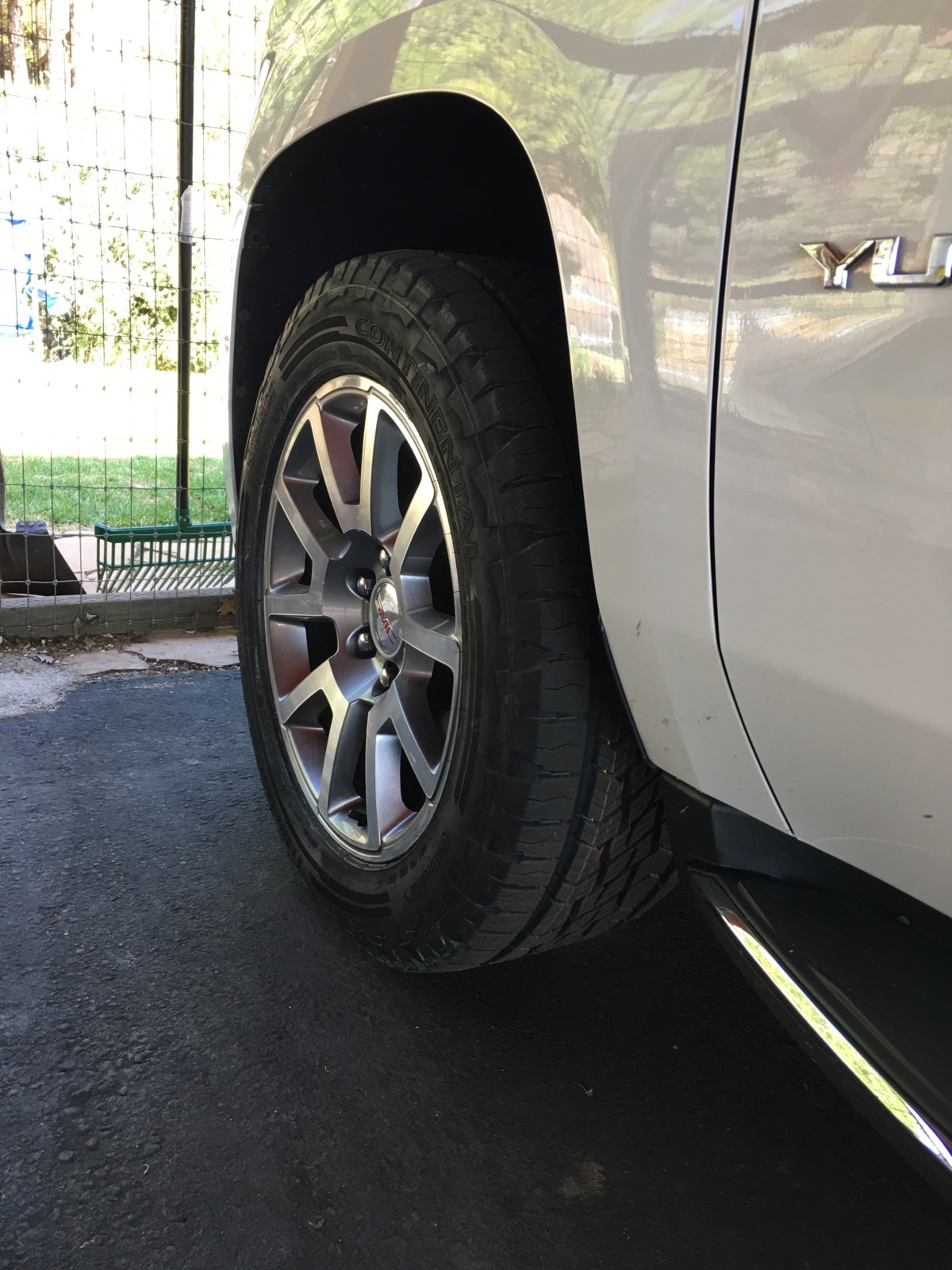

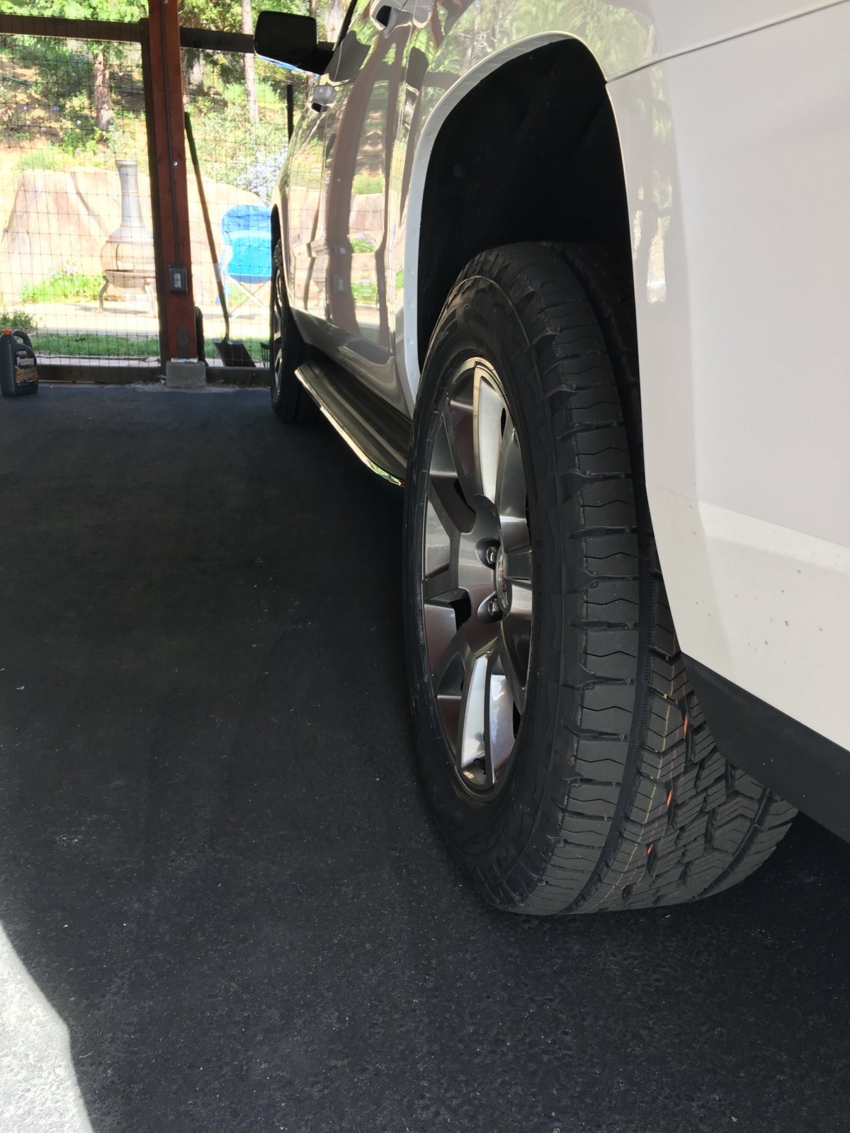

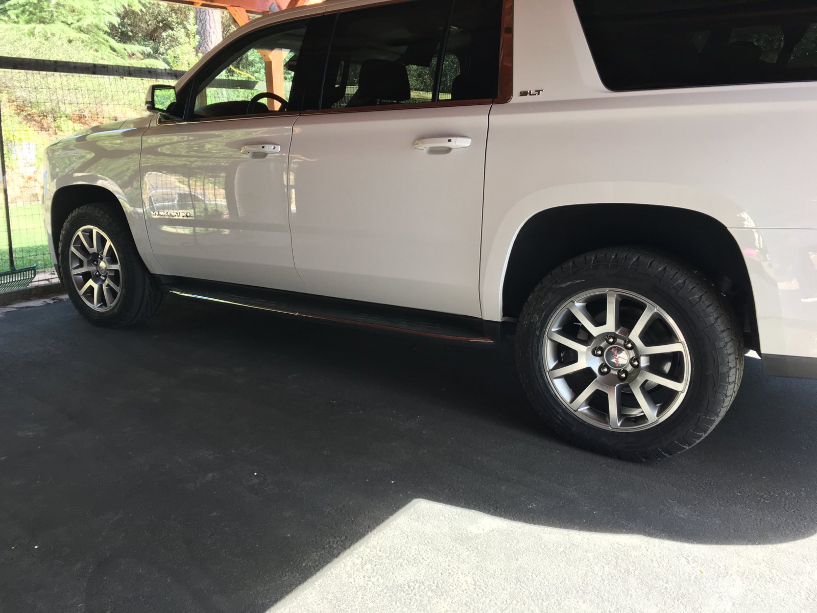

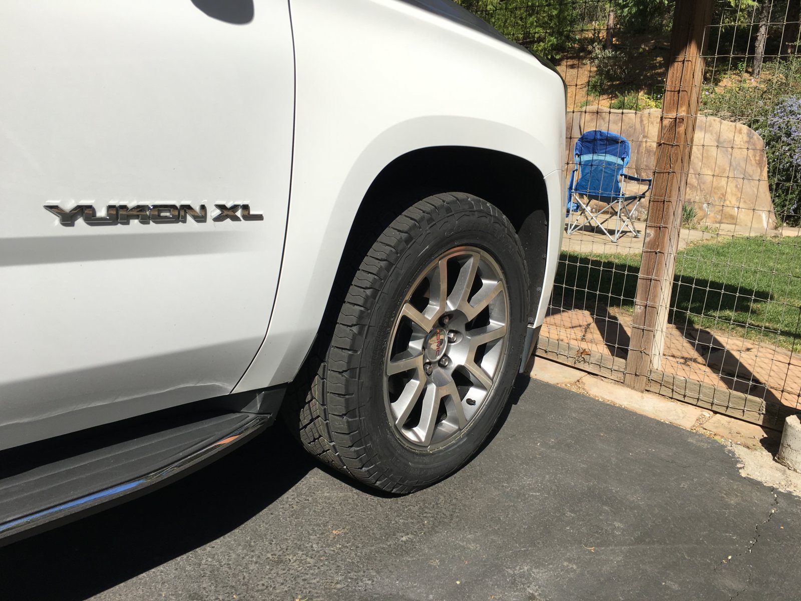

I just installed the conti terrain contact a/ATs to replace the stock conti’s and really like them and how they made the Yukon look a little tougher. I was looking to go bigger with a different A/T but decided to go stock size. They are definitely worth checking out if you want to go stock size.
C
cardude2000
Nov 12, 2015
2,931
1,041
I just installed the conti terrain contact a/ATs to replace the stock conti’s and really like them and how they made the Yukon look a little tougher. I was looking to go bigger with a different A/T but decided to go stock size. They are definitely worth checking out if you want to go stock size. View attachment 197646View attachment 197647View attachment 197648
Thanks. Looks good. Why didn’t you go bigger with the Conti? What was the other one you were considering?

I was originally set on a LT285/55r20. I like the cooper ATPs I have on my Silverado but there was nothing that would work. Then I was looking at the KO2s, cooper LTZ and many others. I suffer from analysis paralysis and can research to death and not buy anything. I finally came across the new Continental’s but they didn’t have the size I was looking for. After further research of different tires I came back to these and decided on these without ever seeing the tire I person. Now I had to choose between the 275/60R20 or stock 275/55r20. Since this rig is a daily driver and a frequent long trip vehicle I decided to go stock size. I ordered the tires at America’s Tire and when they arrived I had them installed without seeing what they looked like. When I went to pick it up and saw it in the parking lot, I was very pleased at the look of these tires. It really changed the look of the Yukon. My pics don’t do these tire justice.

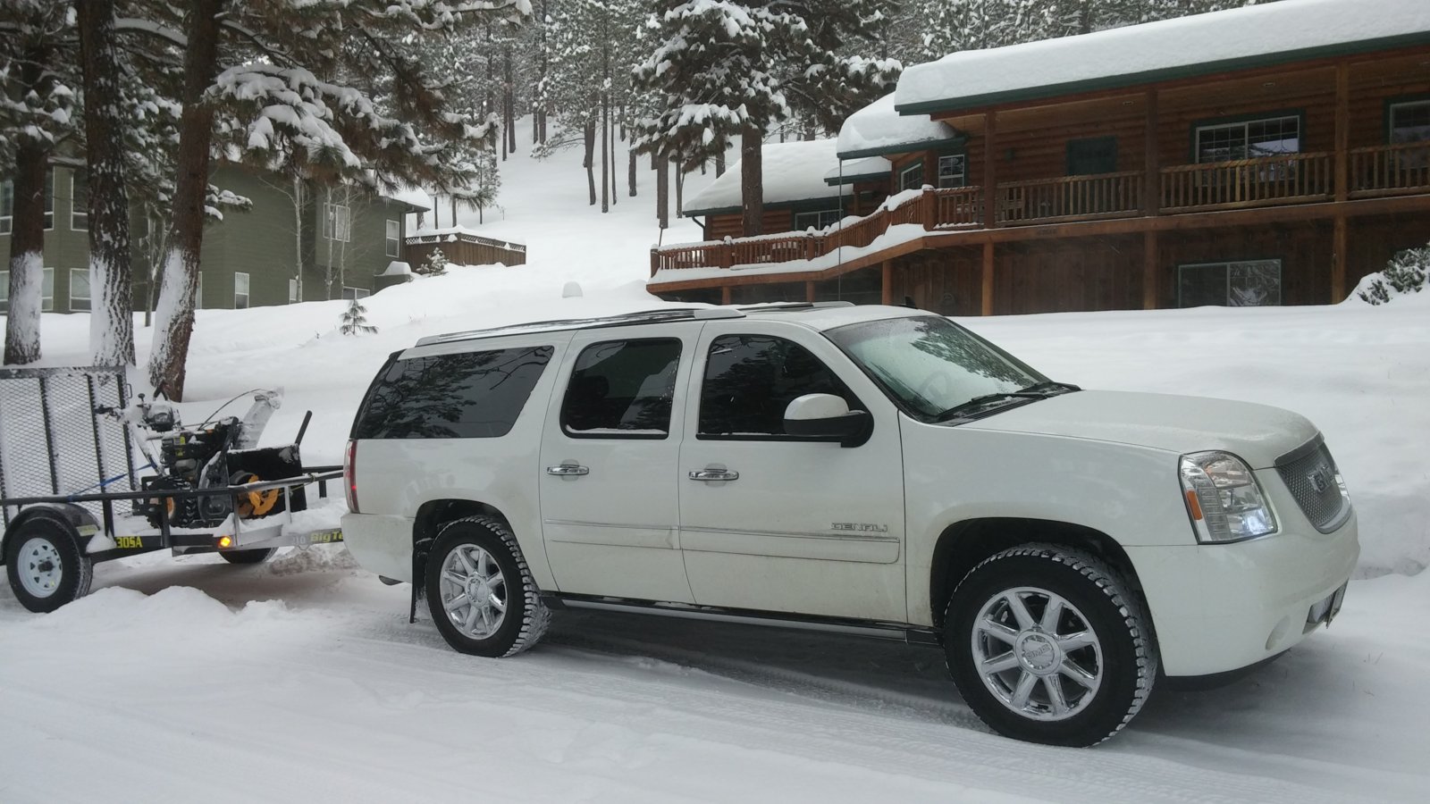

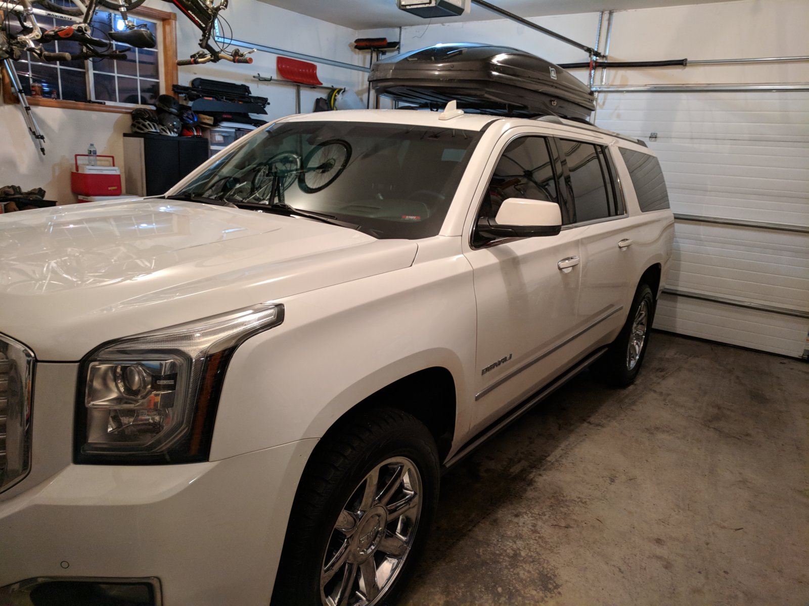

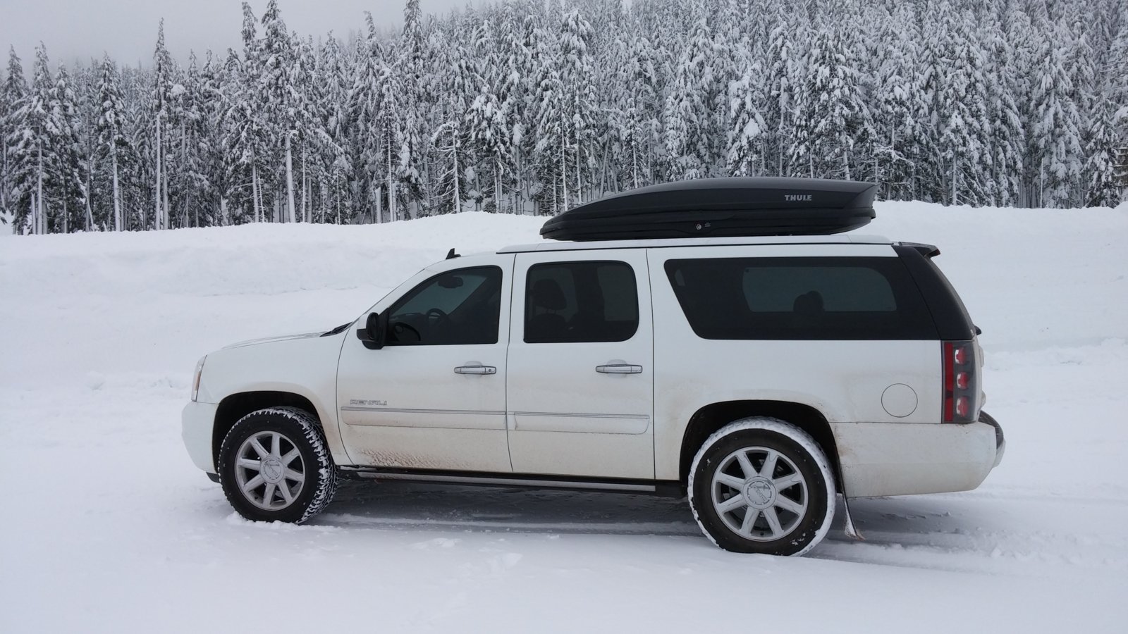

Had a set of 275/60/20’s for my winter tires on my ‘07 and ‘17. Pretty tight and that is with a front level kit on both. The tires were studded so regular tires should be fine. Both also had retractable running boards. That is where it was close.

do you have pictures i would like to see

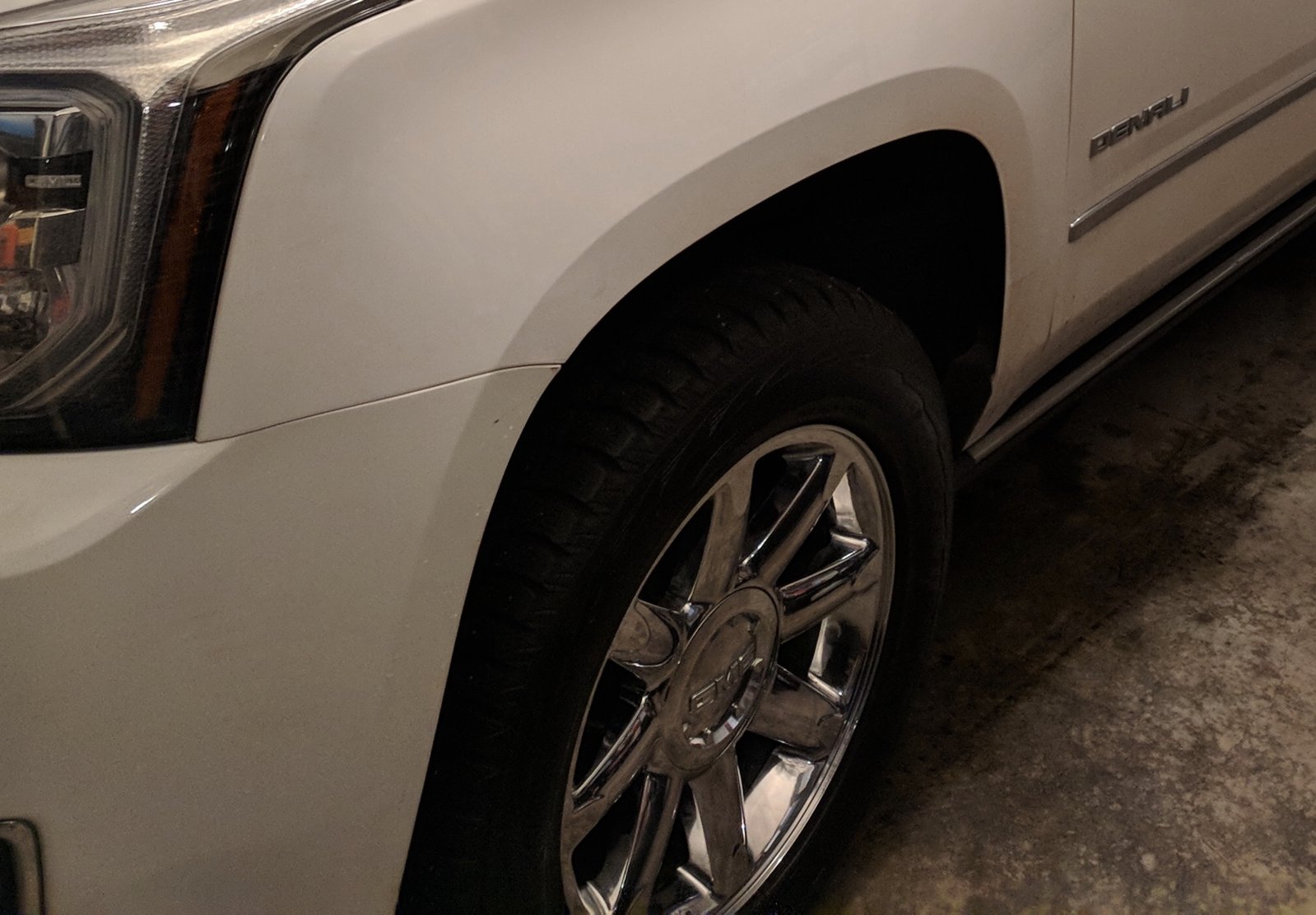

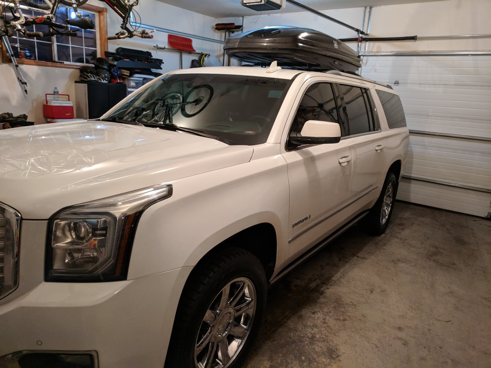

Looks nice. Would love to see a shot of the ‘17 straight on the side to see how close it gets to the step. I have mudflaps so that’s a concern. Thanks!!!
Unfortunately, I had to replace the tires this winter and the studless I went with only came in the 275/55/20 otherwise, I would throw one on for a pic. I like the look of the bigger tire. I can tell you that it was close (1/4”) or less from the inner most part of the step. The radius is 16.5” vs. 16.0” plus I had another 1/8” for the studs. The steps are recessed about 6” into the wheel well so your mud flaps might be of a concern if the go back further.
A good test might be to see what your tightest clearance is and if it is more than 1/2” you should be good. Double check manufacturer details of the tire though.
Do you have mud flaps with retractable steps? If so I would be very interested in what flaps you found to work and a pic. I haven’t found any that work. Just 3M’d the whole damn lower rocker panels. They cinder the roads in winter here. Hell on vehicles.
Hope that helps some.

Thanks. I’ll have to check. Here are the flaps.
Husky Liners 58201 Black Custom Front Mud Guard https://www.amazon.com/dp/B00MFSR6Q6?ref=yo_pop_ma_swf
I also have Xpel ultimate on lower panels and front quarter panels.
