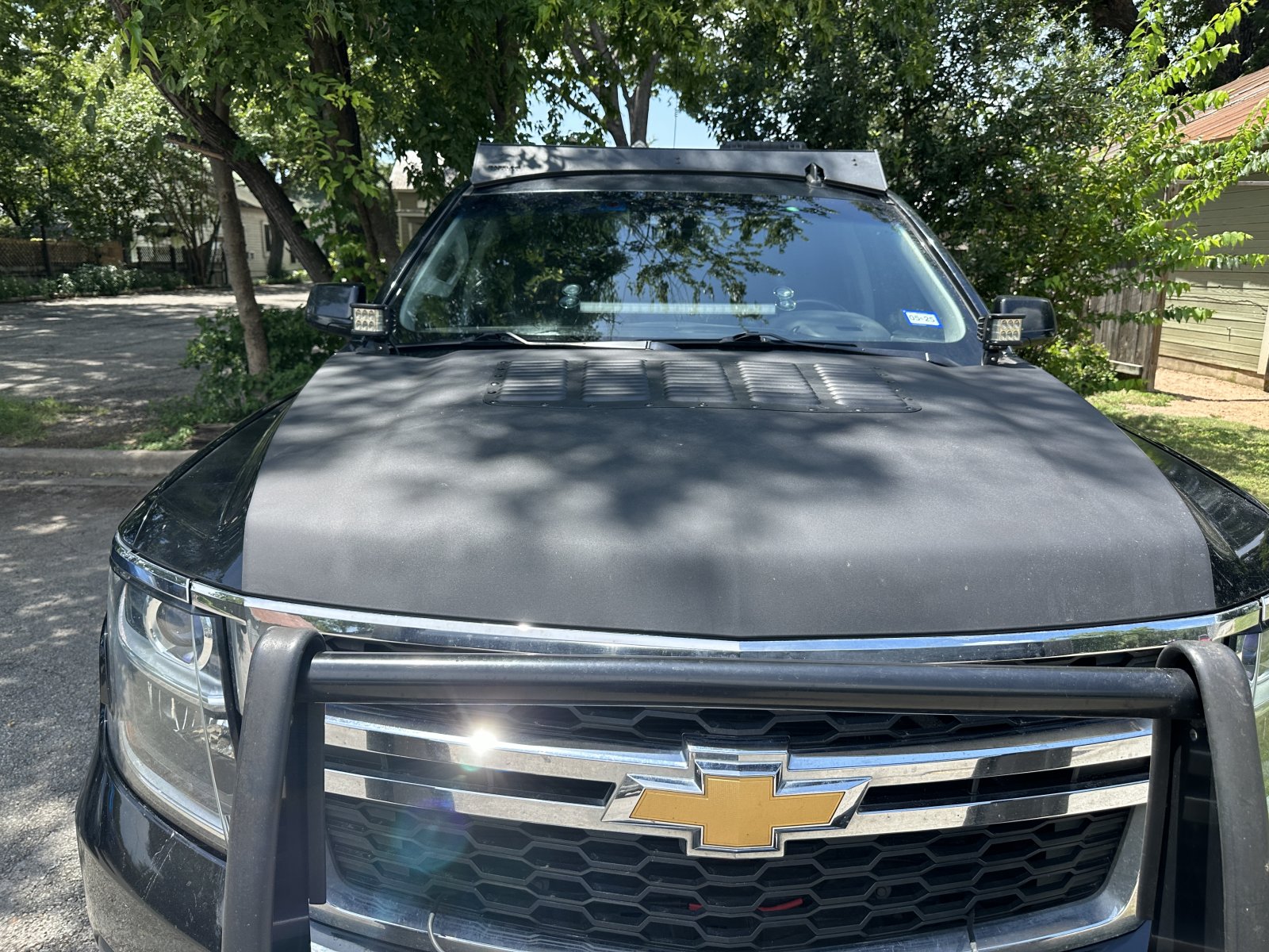

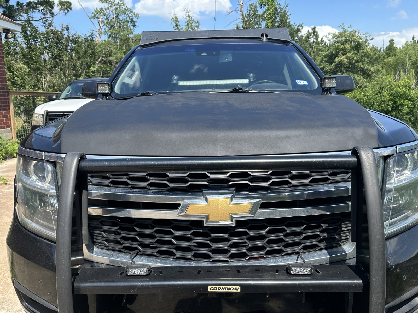

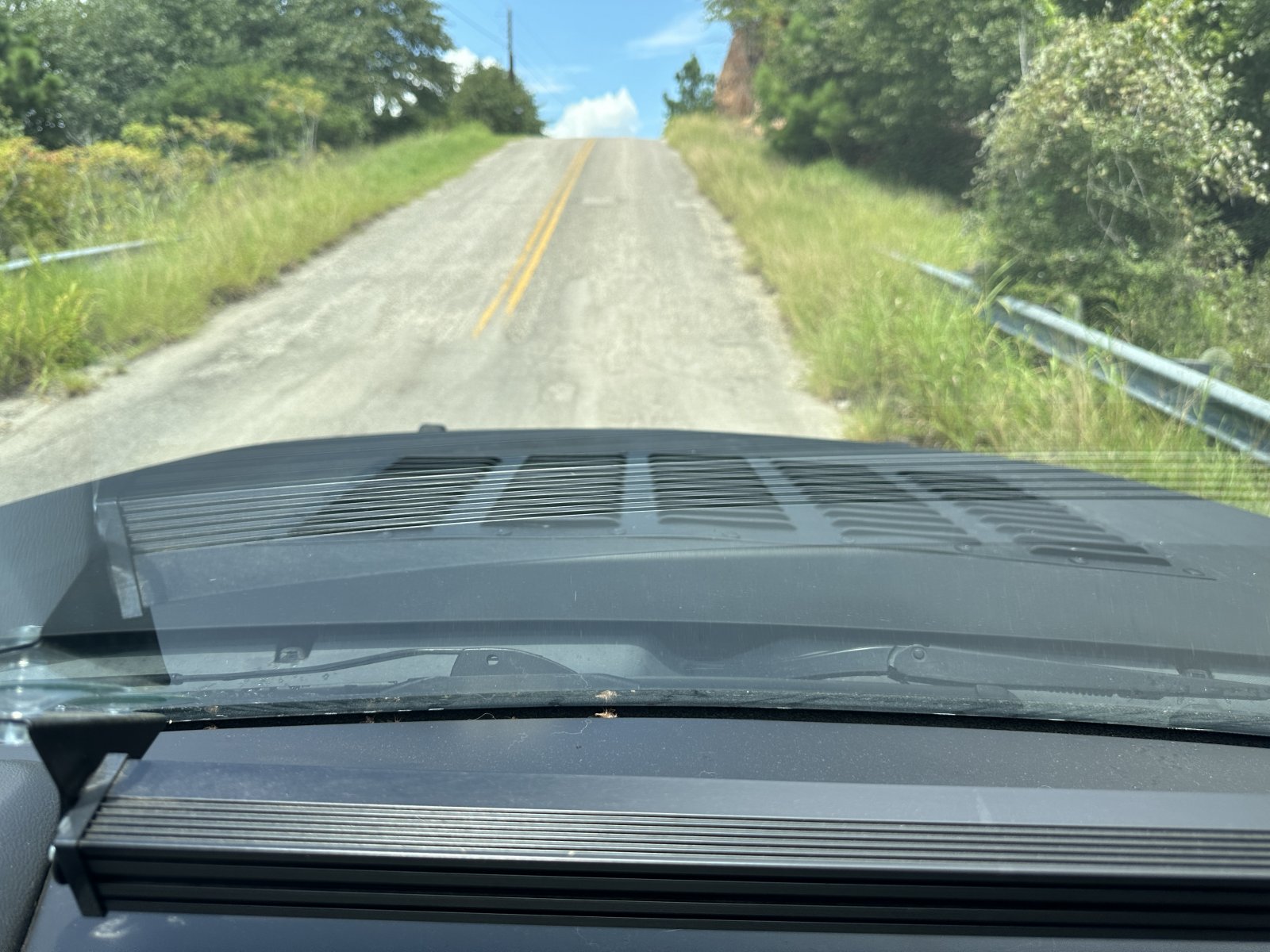

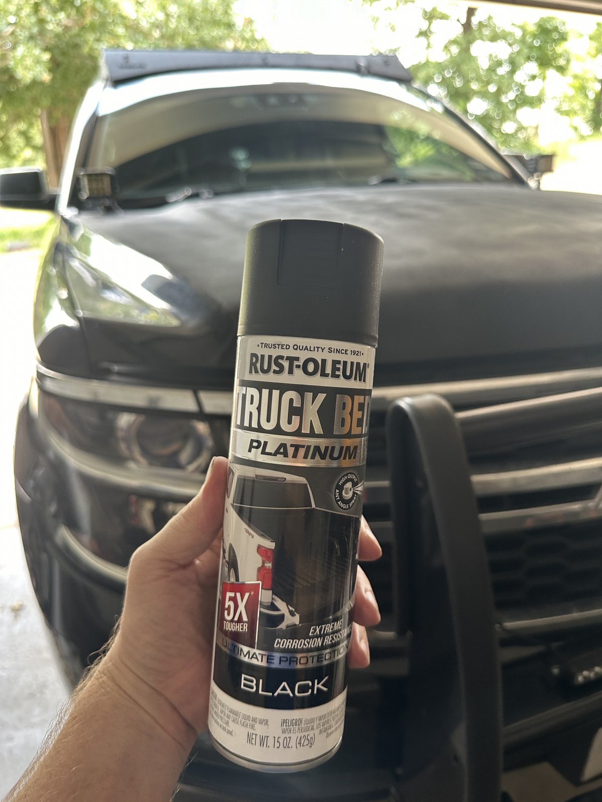

Mine was also starting to look like crap. I went a different direction, but had a longer range idea in mind too.
Prep was scuffing with an 800 grit sanding sponge. Quick wipe down to get any dust off, then 4 cans of the material.
The louver happened a few months later.
Might be a bit extreme for some.
I had a tractor I did that to. The glare on a sunny day would just about burn my eyeballs out. Painful. After I sprayed it, it was cool as a cucumber (real cool). I bet you ain't got any glare problems with your truck. Looks good too.
Thanks! I can’t say I had glare issues before, but it does change the look plus disguise the louver.
