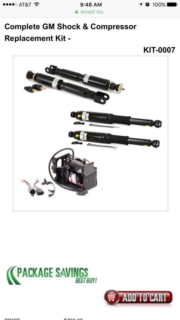

I have their passive replacements. When I bought them, they had new Bilstein branded rear air shocks which are the ones I bought. I got them in a complete kit which had passive fronts as well along with compressor and air dryer rebuild kit. I did have a couple of issues with their bypass resistors that eliminate the magnetic damping which is why they're called passive. They replaced the resistors under warranty but I went ahead and soldered in some wire wound resistors instead in order to eliminate future problems. The shocks and air compressor still work great and it's been a year and a half so far. I'm happy with their products but have heard to stay away from their " rebuilt" shocks which aren't actually rebuilt.
Just priced out there kit it's like $700 is this the kit you run?

Yes that's the kit I bought.
Thanks, I'll more then likely go with this kit, I love how the factory air ride works, but just not worth spending $1300 on new shocks + compressor and any sensors that might be bad
