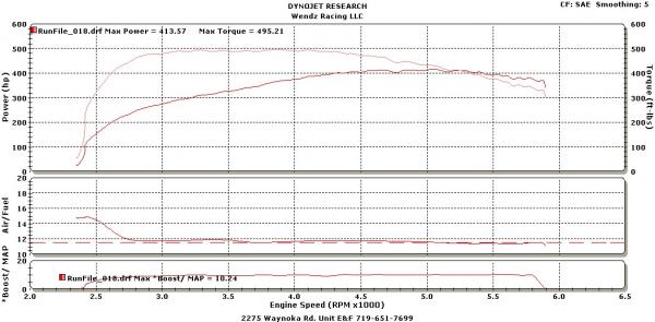

So finally I got around to installing my 1 7/8 ARH Long Tube headers and 3.25" SC pulley.
The headers fit amazing just like I expected coming from ARH. I still have a progressive meth kit from snow performance to install, but like the gains and drive ability of it now. I think I will let it be.
Here are the dyno graphs for before and after the headers & pulley.
Picked up almost 100 ft lbs down low and 60 hp.
Flywheel numbers should be around 516HP and 618 FT LBS. Not to shappy as the only mods are headers and the supercharger. The motor is all stock.
I am also running to factory exhaust still to keep it quite.
Might build a 6.2L for it and see if I can get 650/650 out of it. Already have the short block and heads.

Damn that's some real power. For some reason I was under the impression it was a 6.2. If you get a 6.2 in you will be pushing at least 620.
Is there any work on the tranny?
Regency
Dec 14, 2011
5,093
667
650whp you want with the 6.2 build?
What tranny are you running?
What are all the mods?
Nice job btw I would definitley shoot for that 6.2 and get a tvs2300 on it with a meth kit and you'll be good for pushing those numbers...
Thanks,
No need to switch blowers. A twin screw is far more efficient and capable of more HP than the TVS rotors. This supercharger should max out in the 800 HP range. Also the manifold from Lysholm has a larger intercooler and flows better CFM of the Magnacharger.
I was looking for 650 HP to the tire.

Good numbers! But I think they are slightly exaggerated due to the DynoJet factor.
DynoJet Factor??? I have owned this machine for 7 years now and have seen it actually read lower than Mustang, Superflow, Dyno Dynamics.
SAE is SAE.
SAE is SAE.
I assume that you have never heard of the DynoJet Factor, which applies before any SAE correction. The DynoJet factor is proprietary to DynoJet, and seems to vary depending on HP output level.
Here is a good show of correction factors being somewhat generous on the DynoJet:
http://g35driver.com/forums/engine-drivetrain-forced-induction/26743-mustang-vs-dynojet-good-read.html
Have heard this bs for years. Fact of the matter is with currant software from dynojet it will read generally lower and more accurate than other machines. My 1200 rwhp one mile drag corvette was the first to break 200mph in 06. We used to dyno at the altitude we would run at before racing on several diffrent brands. I always saw that the car read higher numbers on other brands than the dynojet.
I will agree to disagree.
