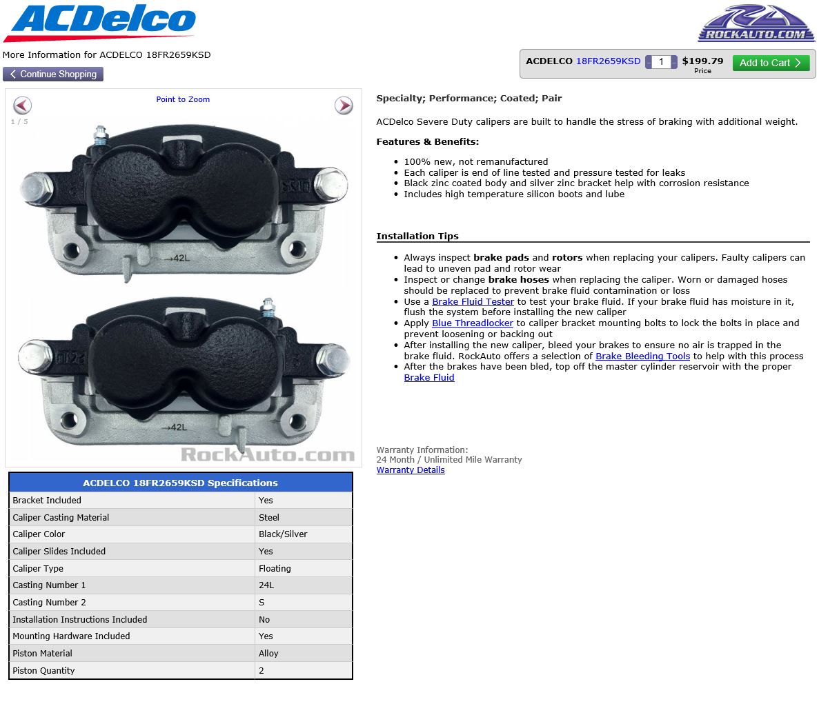

the ppv brakes are not really all that much different, I believe they have heavy duty seals but that's about it. the pads are the same size the pad material is semi metallic.
the semi metallic may stand up to heat a little better than others but they do not last long depending on how you drive I wore a rear set out in less than a year.
I bought these for the front and use them with some Baer erradisped rotors and ceramic pads

I have the same ones that Doubledive showed.. I haven't installed them yet, but
they are in the house! I'm going to do the caliper brake lines/ pads/ powerstop rotors
at the same time.. My brakes have been holding up ok, so I've put it off..
I looked at RA and couldn't find the ones i bought a while ago.. So maybe they are
back in stock now.
They are just a heavy duty version w good coating on them. They won't necessarily
have better stopping power, but they'll be "new" and hold up to towing better (i think)
than the original calipers
