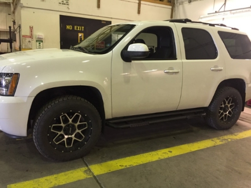

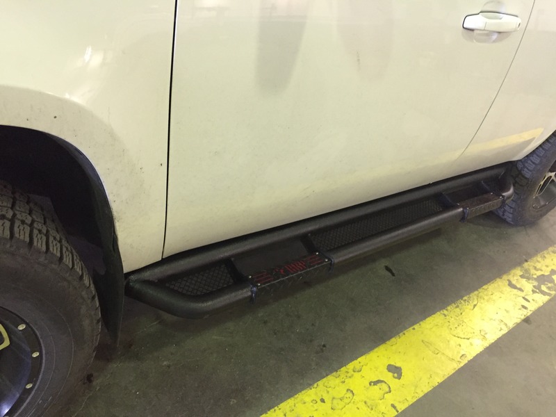

Wasted money on things I don't need lol but you can't pass up a good deal. Got these for $150. New, these things are around $600. Made out pretty good I guess. Now to get some time to figure out how to install them. Thread made on how they will be installed. http://www.tahoeyukonforum.com/threads/rbp-running-boards.92280/

Got one of them mounted today! Gotta find more time soon to get the passenger side done. Check out the thread I started in the earlier post for details on install.

Not a fan of steps but I can dog it. Flows well with Wheels
I have never been a fan of running boards or nurf bars my self. I was always into the actually steps on the bars. Kind of like this but w/o the second row bar. Ever since I drove my old Excursion with running boards and then I bought this, they have grown on me. Plus you can't beat $150 for some good running boards.
